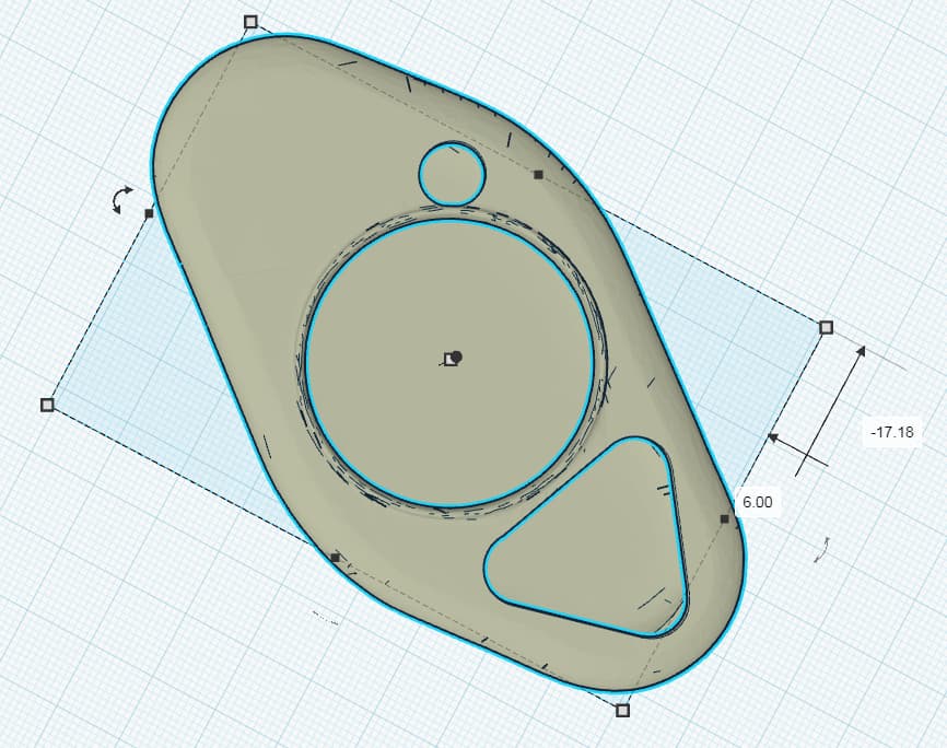

Would someone be able to modify this protective shell for the new pro remote. Dimensions should be the same, just needs some extra holes for the added buttons.

I just wanted to share the stl. I modified to hopefully fit the VX4 Pro.
I can’t guarantee anything, haven’t even printed it yet. Will report back after a freiend prints it for me.

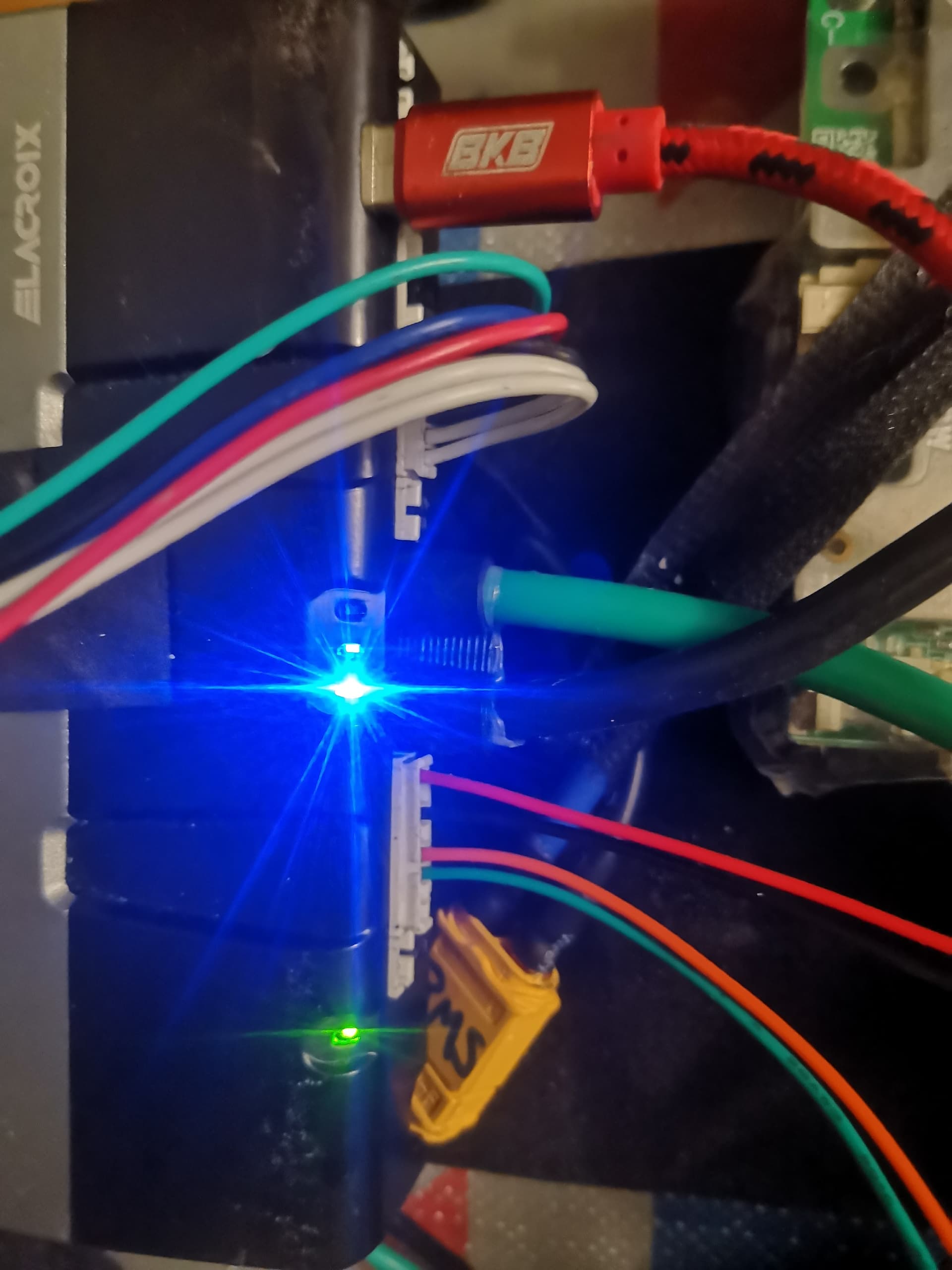

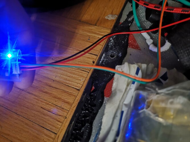

Also having issues after swapping from a voyager that tried to kill me twice, hoping to take out tmo with the mother for mothers day, so if someone could help me get working would love you long time
Switched rx&tx, got battery reading from board, uart&ppm, current, also tried current bisexual just cant get any motion in the ocean pls help
Pics of hardware, lmk if u want to see vesc
Do you have the newer VX4 with four buttons or the old version with two? The new one doesn’t come default set to “FSESC” in the “ESC type” setting. Also I think you have to calibrate the thumb wheel through the remote menu before it will do anything. Factory settings for min, middle and max came with all the same value on the few that I have received.
I did switch to fsesc,
will look at this tho
My hero.
That was indeed it, probably couldve figured out last night if i hadnt had a few :sweat_smile::rofl::sweat_smile:
Saw that in menu last night and didnt even look at it cause i didnt see that menu last time, figured it would be a non issue
Theres always something :sweat_smile:
They could have done a better job with the instructions. Enjoy that Mother’s Day ride :v:t2:
Flipsky instructions, even in video form, are a flaming dumpster fire at best. Even running a Unity, I had to choose FSESC on the menu instead of Focbox in order for my VX4 Pro to read mph, battery etc correctly.
Did you refine this at all?
My friend printed it for me but I haven had the time to pick it up yet. Will report shortly
