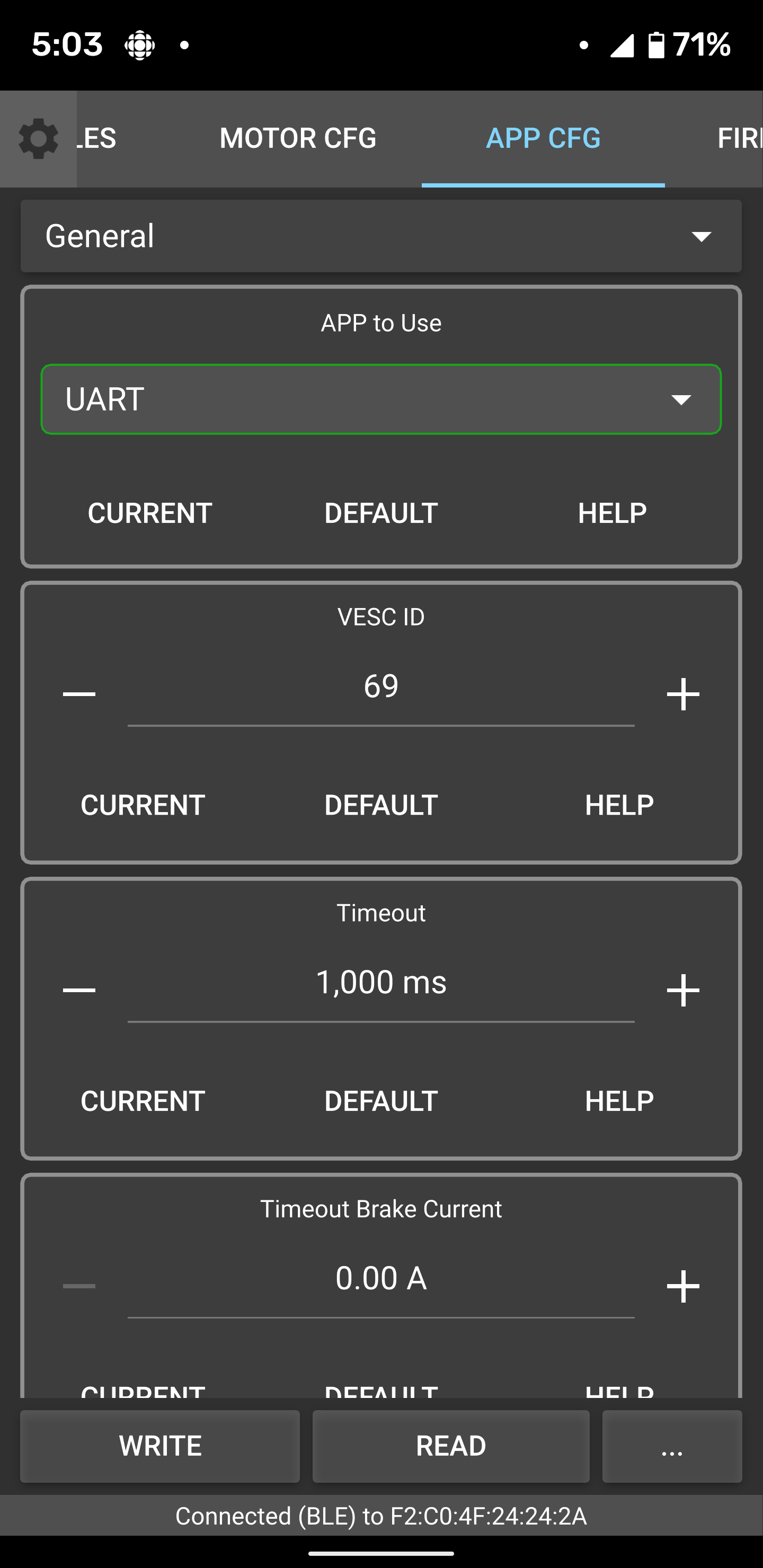

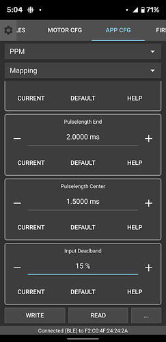

I will try it - but it doesn’t seem to have anything to do with dead zone.
Even when I push the throttle up to full - way out of any dead zone - nothing happens for half a second.

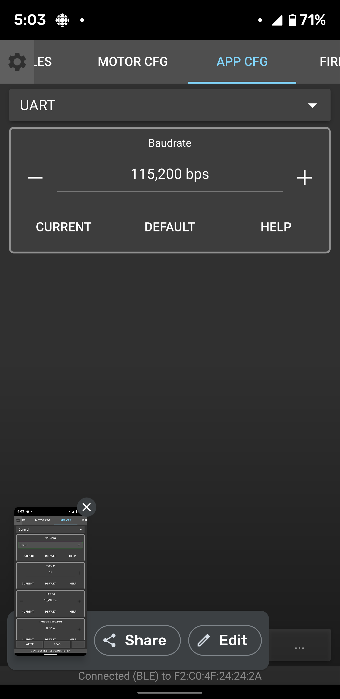

There doesn’t seem to be any dead zone setting under APP CFG General or APP CFG UART

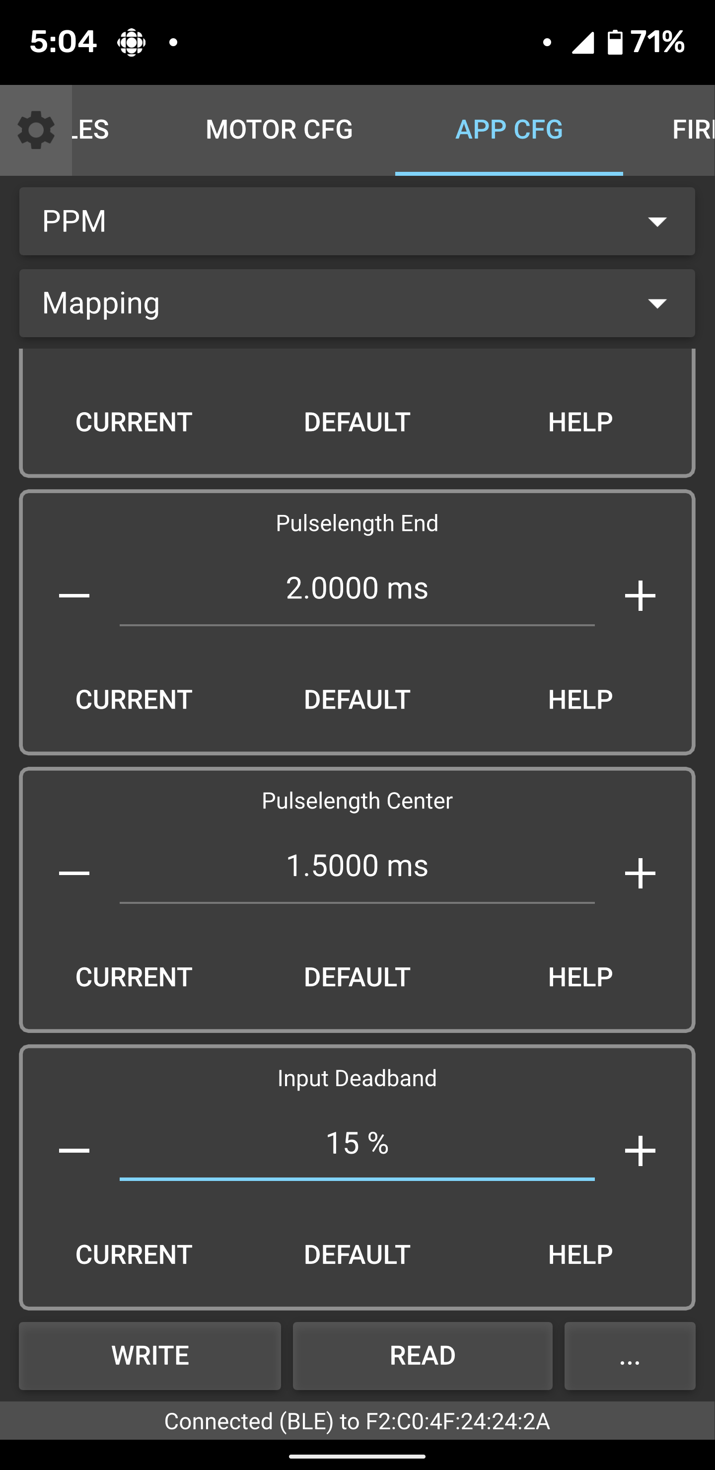

I tried changing dead zone in APP CFG PPM Mapping to zero but that had no effect.
Tried it. Same thing.
probably broken remote, maybe ask flipsky about it?
so when using UART you’re not in PPM mode, changes in there won’t do anything. Now that I’m looking through it again I think I might have gotten mixed up too though. I was looking in APP CFG>VESC Remote>Input Deadband, but I think that might be specifically for the Trampa Wand?

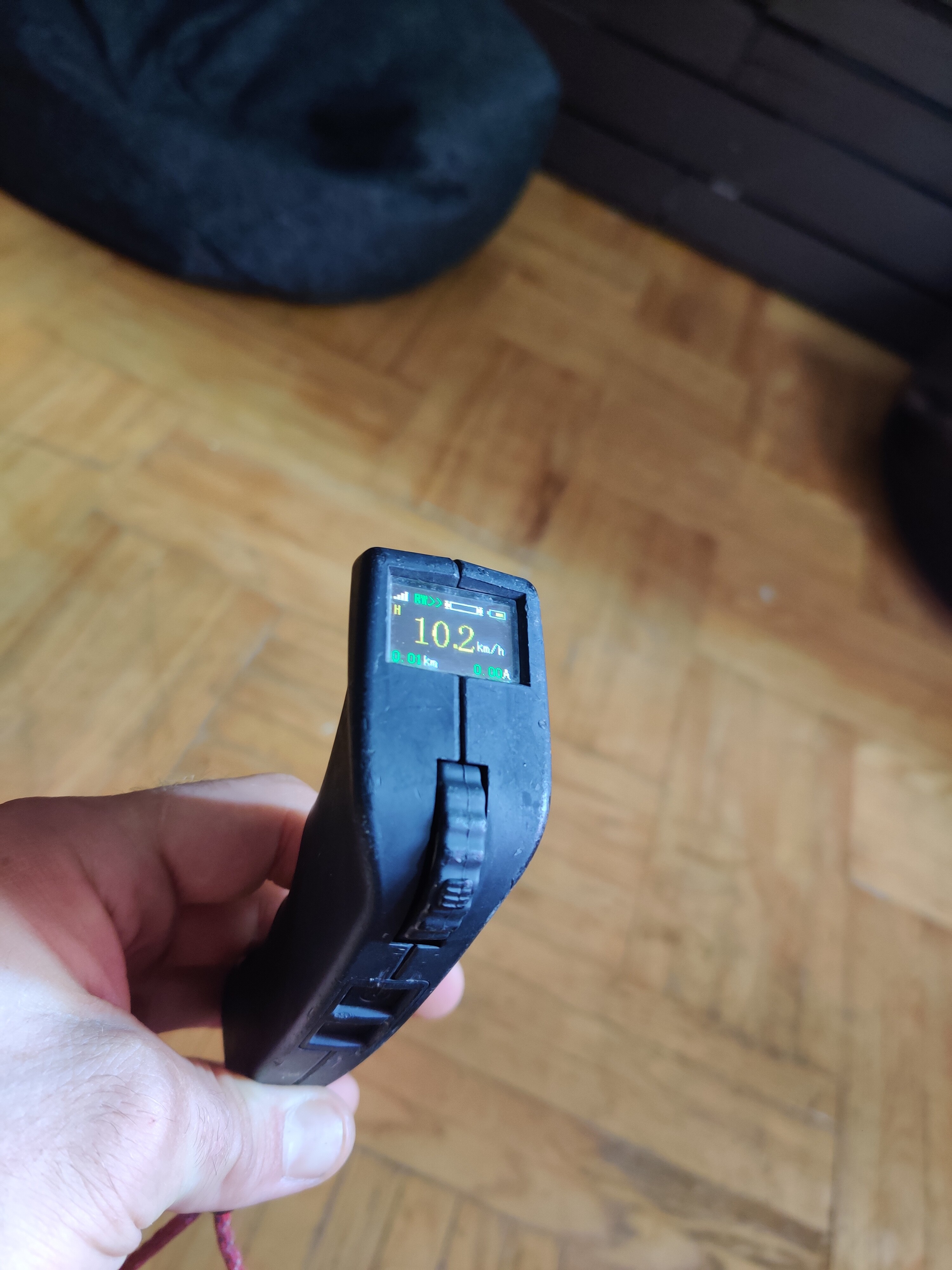

OH MY GOD WHAT A COMPLETE PIECE OF SHIT THE VX2 IS
Took it for its shakedown cruise today. It’s not enough that every time you let off the throttle it takes half a second to accelerate again leaving you at risk of being run over by a bus you had timed it to miss.
Over the course of four hours it disconnected TEN TIMES.
Any one of the them could have killed me if it came at the wrong moment.
I don’t understand how the same company made the VX1 which has never disconnected on me in three months. Not once.
This widowmaker is going straight in the garbage. I’m not even going to sell it. I can’t responsible for what would happen.

Anyone had vx2 freeze on them? I doubt i can restart the remote?
I got replacement for my VX2 that was disconnecting.
Took it for a shakedown cruise and no disconnects ~an hour of riding.
So that’s good.
It still has about a 250ms delay between pushing the accelerator and something happening which the VX1 doesn’t have.
I guess I can learn to live with that if I means I get a battery gauge and everything - it’s just the way the VX2 is I guess. It must be just coded a little bit more inefficiently in order to to drive that screen or something.
