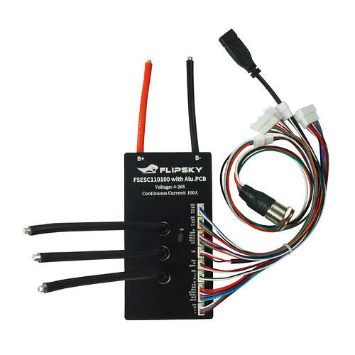

Flipsky V110 Series, 110v 26s Vesc based esc
Anyone seen or used this (relatively) new 110 volt Flipsky Vesc based esc?
And;
I know, I know, It’s Flipsky junk.
I have 4 different Flipsky models I have used for years, they work just fine if you don’t push the limits.
Assuming the $100 list price is real, might be an OK option for higher voltage setups.
That’s a lot of ESC for $100. I’d love to see the PCB and see what FETs they’re using
Likely comes straight off the production line, untested, shipped to you with no usable warranty at all.

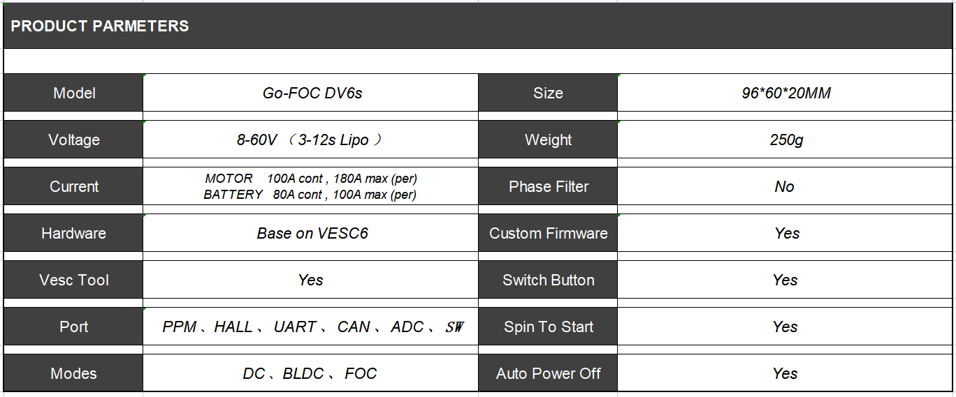

It could also do 2x 12S in series. But as Dinnye said it’s to be avoided. It’s also not ideal just less bad but you could put 2 in parallel. You could even have wildly different Ah in parallel (which would just potentially wear the packs faster). Use 2x the Kv you would use if you put the packs in series and more current. if you would use flipskys anyway the 300A/200A 75200 is probably solid. 12S high amps is loads of power. Personally one pack for the front and one for the back is preferable over mixing packs. DV6S
