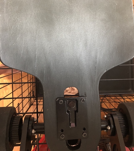

Waiting on 10mm spacers These dkp are wide
Haven’t decided on this deck bustin robot 41
And maybe a different wheel

What’s the name of the deck? Where from and how much?
Did you run into any motor bite or layer delamination with it yet?
I got a clone of that deck, exact same cutout, and the back end split in between the baseplate and the main body of the deck. I hope it’s just mine and not a general flaw of that model
Yes it definitely needs some glass or carbon to Strengthen it up it’s just my test dummy for right now
Pics:
If you have nice streets around i wouldn’t worry too much i guess. I ran it with 85a 83mm wheels through london roads when it finally split.

By the way, don’t forget washers on the nuts under
These 14.53 dkp are Definitely made for the AT rider
I’ll have more pics soon :call_me_hand:
