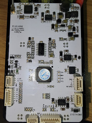

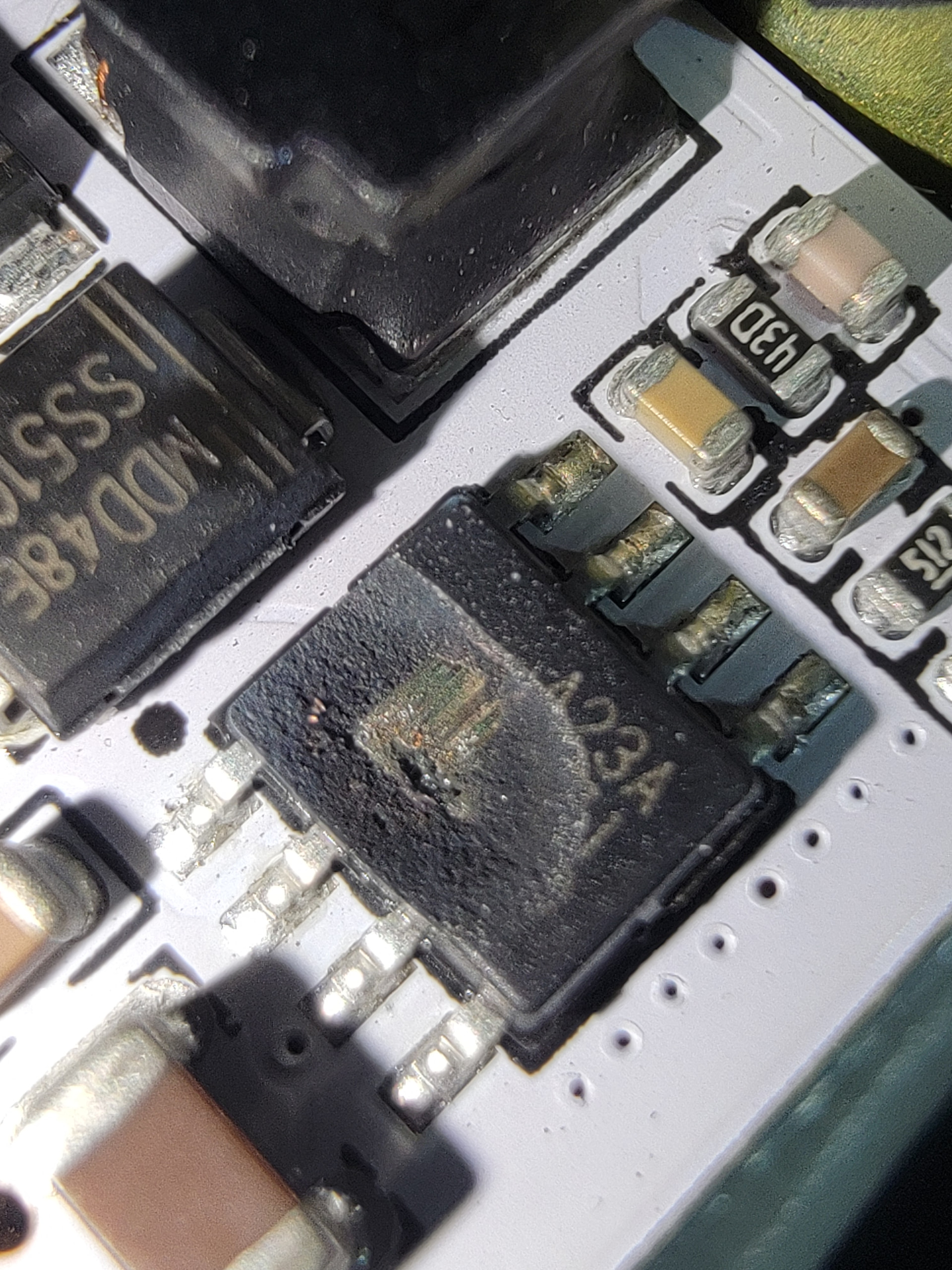

Figure I’d post this here since it covers the same topic. Does anyone know where I can find this chip for the 75200 v2? Pic is for reference only I’ll get a macro shot later today if the damage.
I bought it for repair and that’s the only item I can see damaged. Saw a you tube video that mentions this is a buck chip something about stepping voltage down to 5v or 3v.
If you can get the part number, Electronic Components for PCB Assembly | JLCPCB Parts Library may be an option, since flipsky is a chinese company.
I don’t know if Digikey or Mouser would have that exact part, but you may be able to cross reference a part with the same specs, could work.
A bit more cludgy, but you could bypass the onboard dc-dc, and wire in a generic off the shelf dc-dc module.
