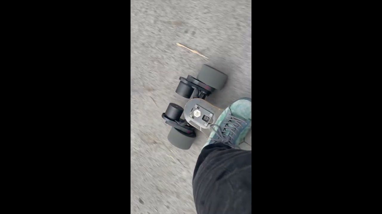

Can anyone tell me why these motors have this noise? My old motors (I think racestar? Evolve) where super quiet. These new motors have a loud gravelly whine noise like a zipper. Almost like something is rubbing internally. Seems to only make this sound once the belts and wheels are connected. I can hear it even when turning the wheel by hand with the ESC off.
I tried upgrading to FW 6.02 (Stormcore) but it tried to kill me when the throttle randomly jumped to max and biffed me off. Ripped up my arms pretty bad. Noise is still present, so I’ll go back to FW 5.03.
Video of noise, with bonus get-off when it got all angry on me…

Slight variations in how the shaft is jacked by grub screws causes some noise. I get shing noises sometimes, from the shell zinging the insides. And once per revolution slight locomotive sounds. Best I could suggest is take the shaft out, and retorque the grub screws, while spinning the motor, to get it centered as much as possible.

Great advice thanks. I did notice the shaft is a couple millimetres short so the pinion has some overhang, maybe that’s also no good?

Yeah I understand how pedantic it sounds. Reason I’m asking is because I haven’t had a lot of experience with different motors so I don’t know what to expect - or what sounds wrong. It also seems to be affected by the motor case rotation like a pulsing zipper/rubbing sound. Maybe even 'locomotive" as Skatebored mentioned. Something’s not right.

Sometimes you can suck in a ferrous pebble or some metallic grit in the motor and it will erode or breaks magnets and they will sound normal at slower speeds when the magnet fragments are firmly held to the can, even with broken epoxy.
Higher speeds and abrupt accells and decels over come the magnets and they touch the stator and it makes clicking or an unusual hum.
Open your cans, pull the stator, and inspect (sometimes you can kinda fix it). give that remote and receiver placement a once over too.
