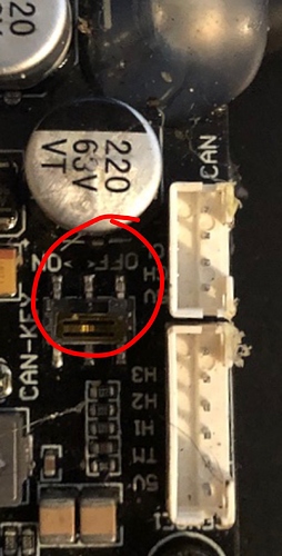

Do I live dual switch on
I have no idea what dual switch is
On VESC 6.6 there is a dual CAN switch
How do I set one as master and one as slave

First, make sure the can switch is on
( @abusfullofnuns showed a photo last time ), then as @glyphiks mentioned, plug into your master side, update firmware, SAVE, then plug into and update firmware slave side, SAVE, then go through detection separately.
