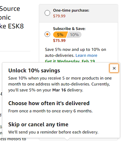

If you’re really concerned about not having a functioning fsesc, there is a subscribe and save option…
