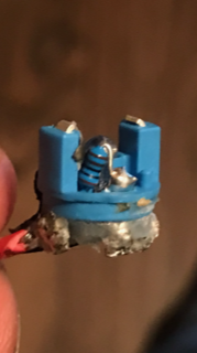

Looking for the wiring diagram on a Flipsky Anti spark Switch Smart Enhanced 200A for 4 legged button to the 3 pins (K+ L+ -(K-,L-) on the anti spark.
Screenshot 2022-05-15 201431
wire the black and white wires together on the closest pin top the left in the top pic
ok, Do you know what the (K+ L+ -(K-,L-) decodes too?
no, but i assume K+ is V+ :man_shrugging:t2:
L+ = LED Drive (requires inline resistor!)
K+ = Switch
L- and K- are both GND
thanks,any idea the value of the resistor?
it’s 5V drive, so anything between 330 and 1k will work.
switch
this look right?
yes
Wait, swap K+ and L+
thanks
Wait, actually you swapped K+ and L+, L+ is for the LED, K+ is the switch connection.
this look right?
Yes
Great, Thanks for the help
looks like the resistor is already in the button
good that makes your life easier.
