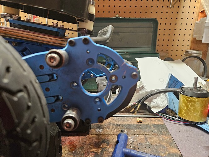

I have one of the three motor mount set screws fudged. These are the screws that hold the mount to the hanger.
The hanger is 22x22mm, im wondering what my mount options are. Has anyone tested radiums moumts on 22 x 22 mm?
Been working on this for a good bit today but might be a losr cause.
https://www.aliexpress.us/item/3256804592457665.html?spm=a2g0o.cart.0.0.566c38daZswbt7&mp=1&gatewayAdapt=glo2usa
Can you drill thru it & re-tap a size up?
Thanks. I was hoping to have a different option but it may come to it.
I might be able to get it out, I probably dont have the equipment to get a thread that large and deep.
This was the plan initially to use a similar size in standard. Ill give it another crack another time. I didnt have much luck today.
Good suggestion none the less
Looks like it’s aluminum. If you have a 12.9 alloy steel screw/bolt of the size you need (m4 or m5?), you can cut grooves with a dremel into the screw or use a hand file to make similar notches into it & then tap the new hole with the modified screw.
Have you already tried hammering a torx bit into the set screw to get it out that way? Last good option aside from that is a very thin cutting disc on a dremel, cut a slot into the screw & a quality flat-head bit from like an ifixit kit should be strong enough to unscrew it. Like, you can cut the slot in the bottom of the mount instead of top (I think atleast, dunno what the mount looks like on the other side)
Anyways, gl. Sometimes it’s definitely not worth the hassle. Sometimes you can dissolve the screw thru electrolysis depending on material composition.
Did you try applying some heat to it? Sometimes a torch can do wonders. A heatgun also works but needs more time
