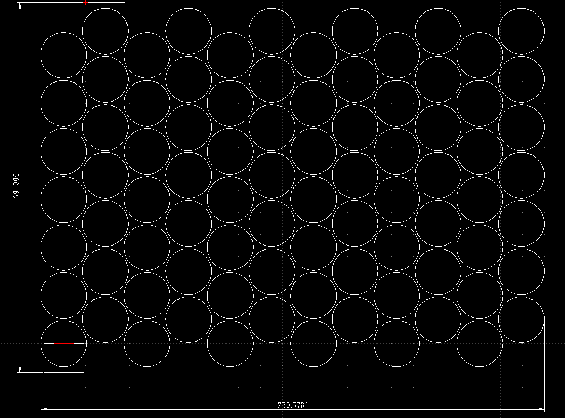

in a brick format a 12S7P (21700 cell) would be this big (mechanical XY-dimensions with the pack marked), height would be 76mm. Could drop one parallel cell to squeeze the Y dimension 22mm down from the 169.1mm to 147.1mm for 12S6P
I was referring to the flat pack, but I guess according to this picture it’d be 0 added height? So, for a flat pack that would be 0 to height, ~1.35 mm per cell width wise, and 6 mm per row length wise, right?
Just trying to figure out the dimensions in order to calculate maximum capacity for existing under slung enclosures.

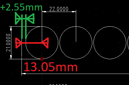

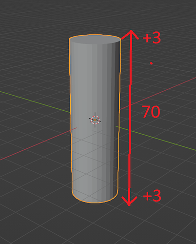

So here’s a 3D-cell. In it’s length direction there will be an extra 3mm at both ends added from the pack structure for a total of 76mm.
Then there is an added 2.55mm added in from the edge of the last cell. In the pictures (below) in the top-down direction there is no extra dimension needed, the cell itself is the outermost piece.

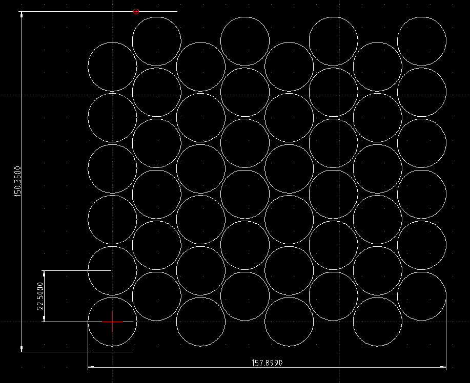

That much more then the nominal 21mm? Measured couple of my Samsung 50E and they are about 21.2mm max diameter. Can you double check that 21.8mm for the P42As?
They are spec’d by Molicel to be 21.4mm, but I have measured as much as 21.7mm. If you want a decent press-fit-without-fucking-up-the-heat-shrink tolerance, then I would plan accordingly
Guess I’ll have to do 22.5mm (+0.5mm) honeycomb grid for them then, but good to know, wouldn’t have thought about that little bit of extra in the diameter.
@rusins
Here’s a 12S4P pack for the P42A cells with the outermost dimensions marked. It’s a bit of a special layout, but this is possible to implement with the design.

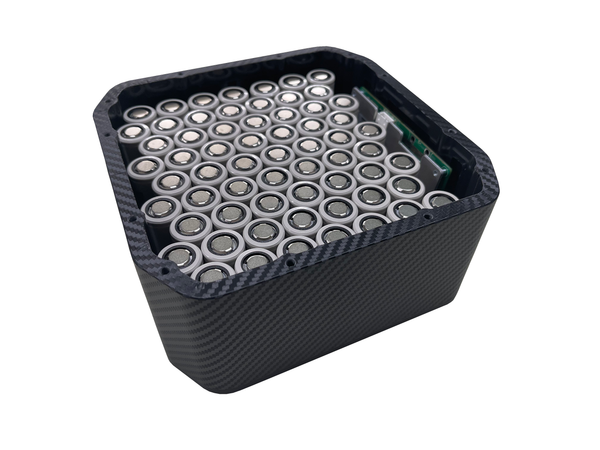

In fact, looks like it’ll then fit the cool battery boxes 3ds make:
Edit: wait, that huge price is without cells. I’m not that rich lol

I mean how many added mm in the 70m direction of the cell ? (It’s important as it will determine if it fits in the enclosure or not)

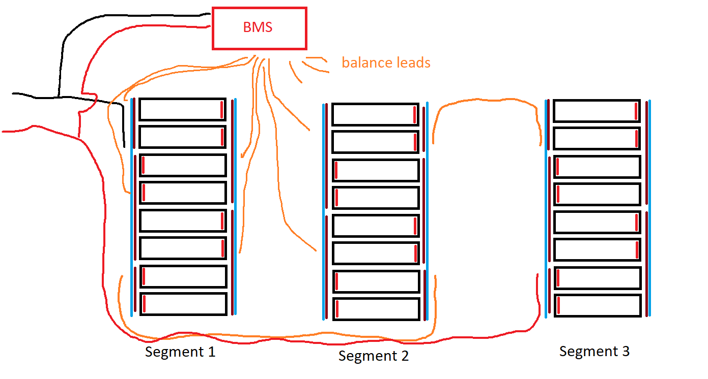

At this point these are just cell interconnect pieces, it will mechanically hold the cells in place and then make the wanted interconnects between them, so you would have to then break out the wiring from them to an external BMS, if you want to run one.
How I would make a segmented pack wiring wise 3x 4S2P segments to form 12S2P. So you would have your rigid segments distributed in your mechanic and then you run a main discharge cable between the segments to chain them together and also connect a balance lead to everywhere where you need to and run that to the BMS for cell sensing.
