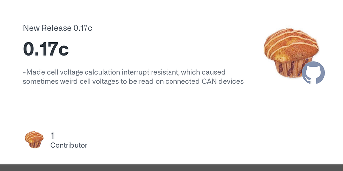

I’d recommend updating to 0.17c as the first step, as there has been some improvements and fixes to the charging algorithm and this would at least eliminate FW being problem source.
