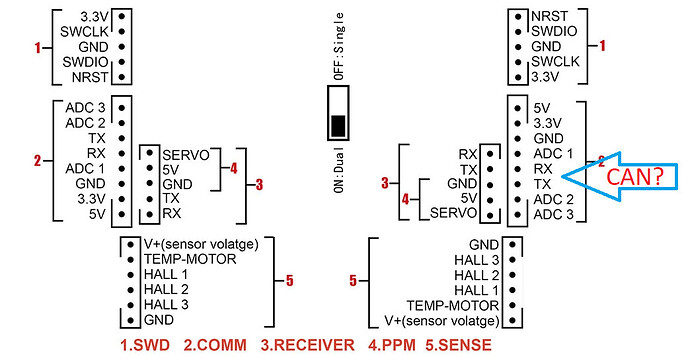

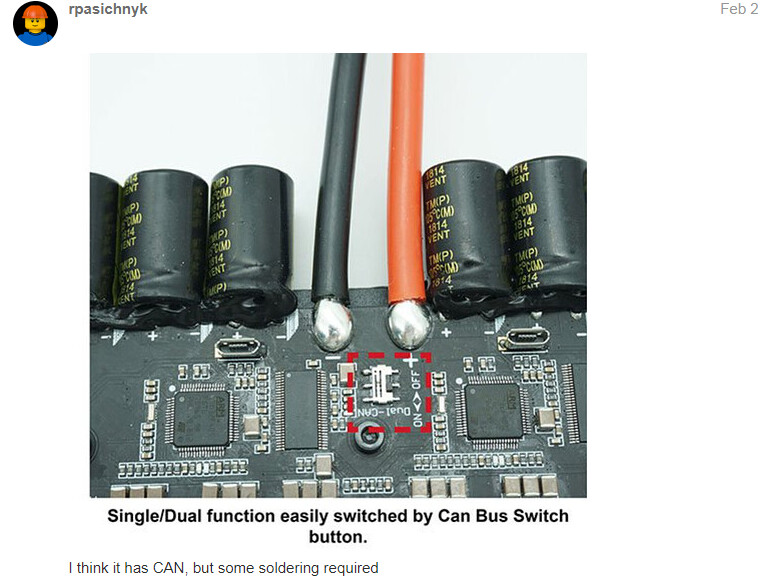

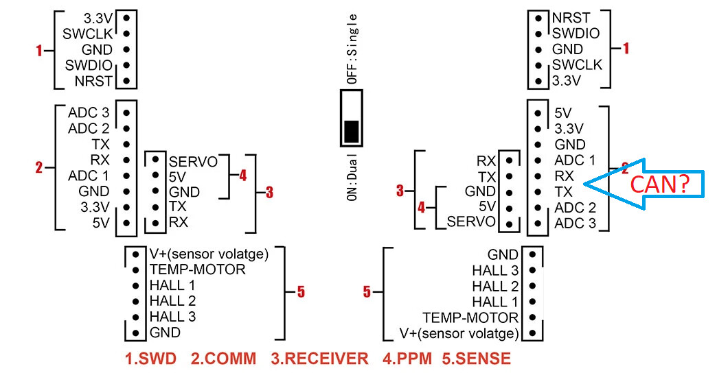

Can someone confirm that this is where I should connect the BMS and Davega? It does not say CANL & CANH like the other Vescs :face_with_raised_eyebrow:
You can’t. At least without some hacks.
You need to solder wires on the single/dual switch.
I did it on mine. It’s doable but not straight forward…
oh no… that sucks :frowning:
It’s not that hard. You won’t see it on the previous picture, but secure the wires and solder joint with a bit of hot glue.You don’t want some wire to become loose and touch something.
And then just hook it up with the Flexi and Davega in parallel?
No, DAVEGA connects to the UART port (where you drew the arrow).
Flipsky made a VESC without a CAN pinout? What the heck? What were they thinking?
Your expectations are WAY too high.
The can in internally routed on the PCB, since that’s what 99% of people use their can bus for.
Only the METR Pro CAN and FlexiBMS so far make use of the can bus .
The thing is that all other Flipsky Vescs do have Can connectors :stuck_out_tongue: Only this one dont.
It rules out 4WD setup at the very least, for which reason I would consider it a bad decision.

Yep. The CAN-bus is still available, but you need to go and solder directly to the board, as there isn’t a dedicated connector available.

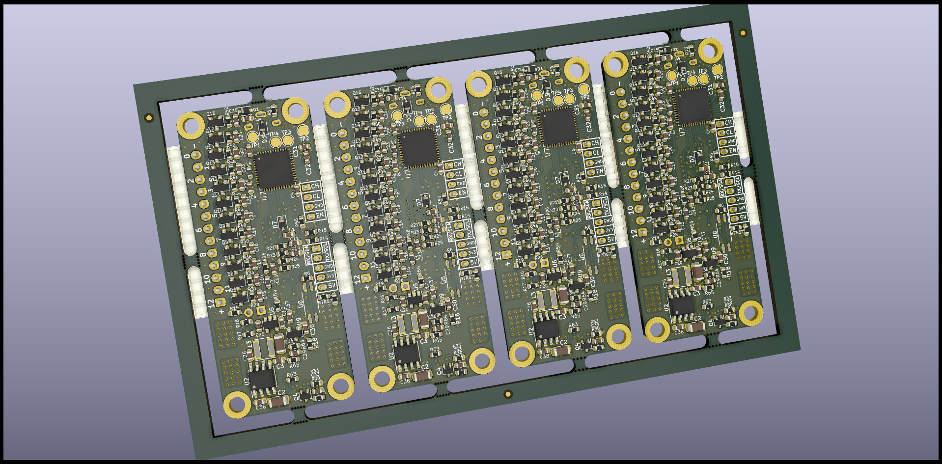

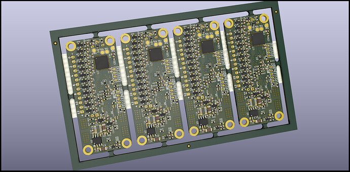

Test panel design for the Lite. First panel I have actually ever designed, as when I was still working at the engineering company, we let the assembly fab design their own panels, so they fit their own assembly line machines properly, but as I will be assembling this panel, I needed to panelize the design myself.
Mind you, this particular design is only for testing/practicing the paneling design and won’t produce functional boards (actual design is 4-layers, this test panel is only 2-layers). I wanted to test different break-off tab styles, to see which produce the cleanest result (cutting off the tabs with an edge cutter) and leave the least for post-processing (sanding/filing down the rough edge).

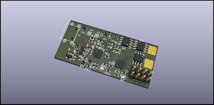

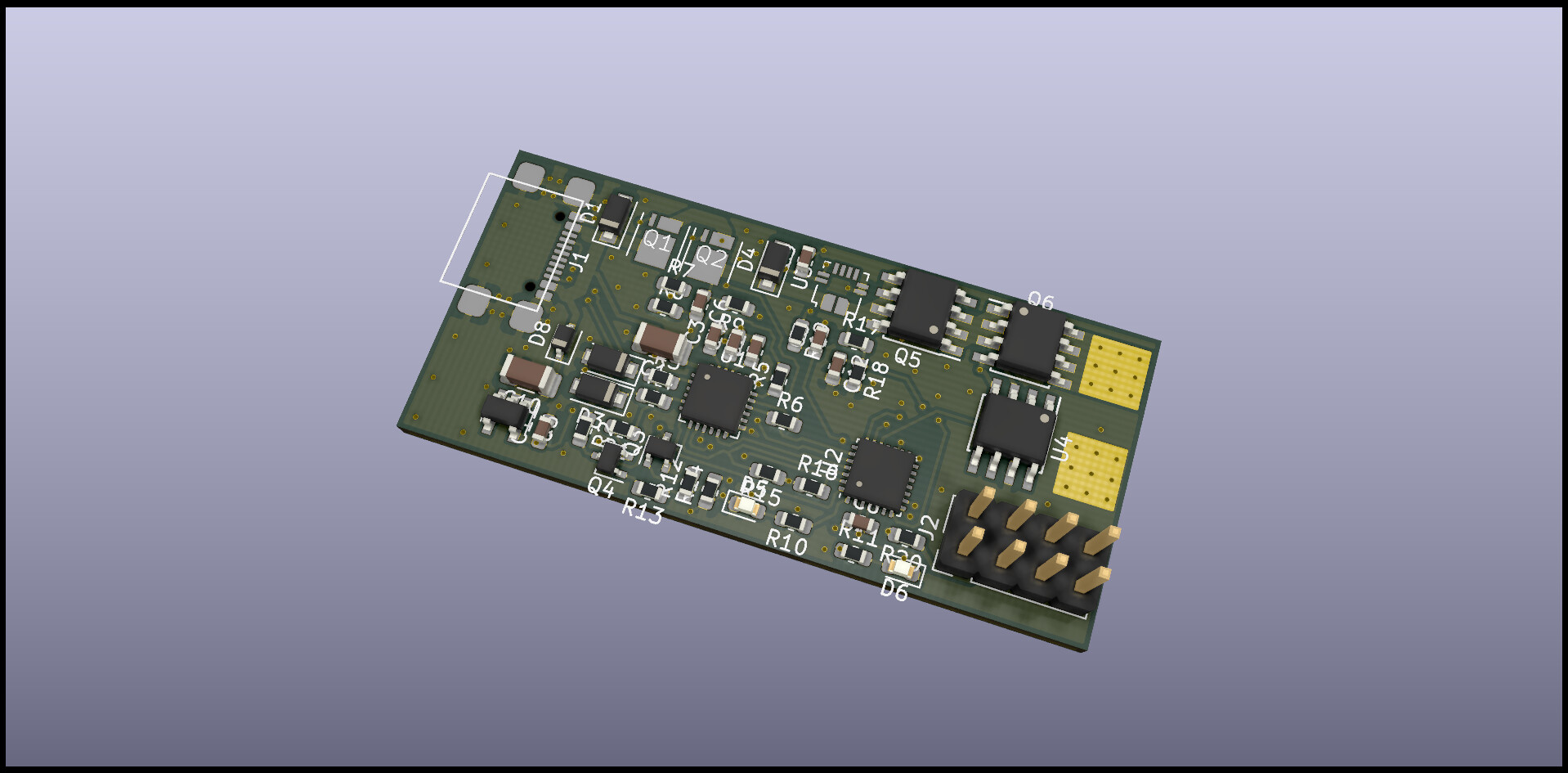

Test board for the USB PD-communication. Has a SMD USB-C connector, STUSB4500 USB consumer PD -negotiator IC and a STM32G0-series MCU, which has a USB PD peripheral inside.
Idea is to first command the PD via the simpler STUSB4500 and then analyze the bus-communication and form a better understanding of the negotiation steps. Then I can start making my test PD program with the STM32 to have custom control over the negotiation.

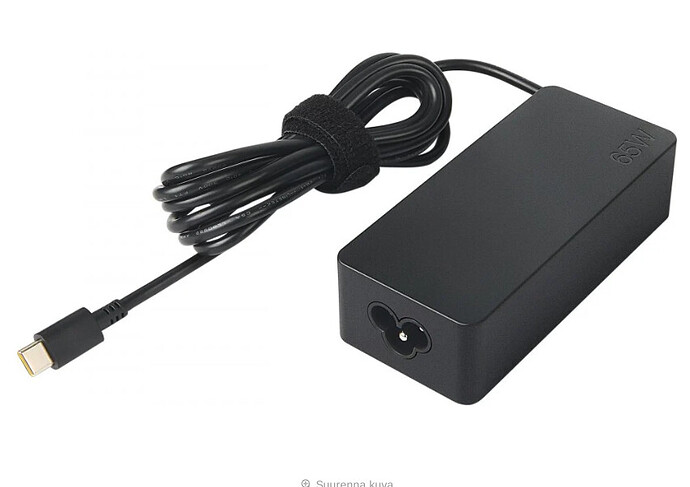

I also bought a 65W Lenovo USB-C PD brick to test with.

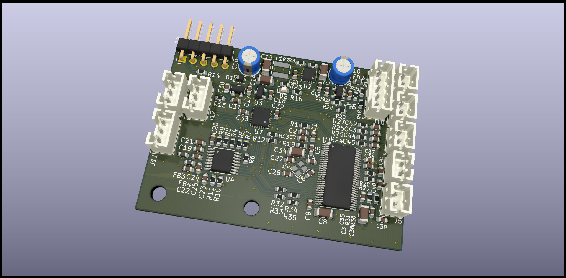

I also finished the new version of my audio DSP board. Old board used STM’s STA309 DSP IC, but it suffered from a constant low buzz on the output and couldn’t through testing, figure the culprit being anything else except the DSP IC itself. I also found a commercial subwoofer using the the same DSP chip and the some users complained about a constant low buzz that I was experiencing also, might have been the same reason.
I have therefore switched to TI’s TAS5548 audio DSP and designed a new test board for it. It’s otherwise pretty much identical to the old board, except for the DSP block and a couple minor improvements.

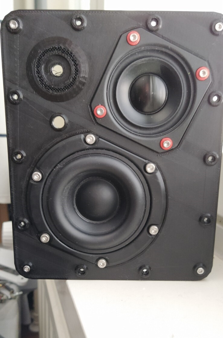

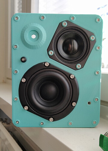

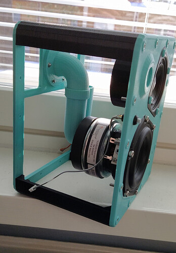

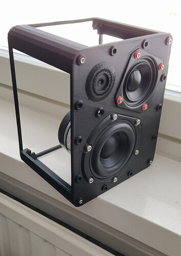

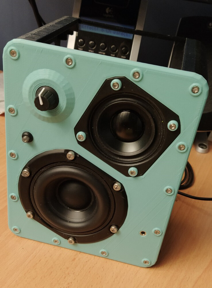

I also scavenged some old speaker drivers from my old projects and started a new speaker design as a test bed for my USB PD, portable application -BMS, bluetooth and audio related projects and product development. The design is currently in process and I’m doing enclosure design, so I can fit everything in there.
Drivers are both by Peerless by Tymphany and models are “SLS-85S25CP04-04” (Peerless by Tymphany SLS-85S25CP04 - 3.5" Woofer) for the low-end and " PLS-65F25AL04-04" (Peerless by Tymphany PLS-65F25AL04-04 - 2.5" Full-range) for the high-end

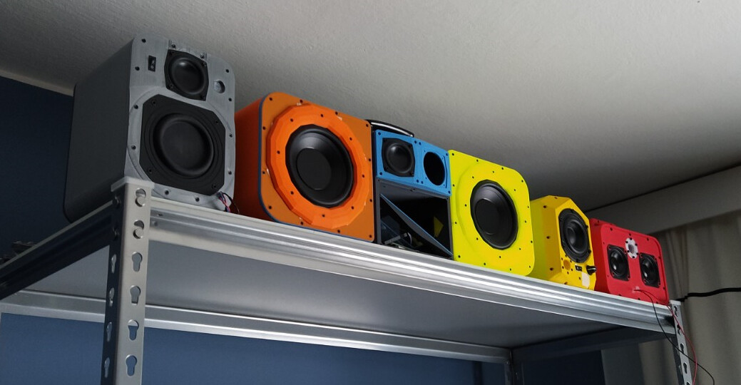

Old projects. Used drivers are from the right most projects.
