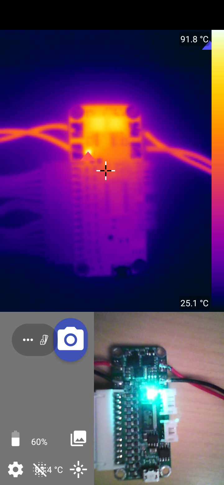

I’m pretty sure this is an old thermal picture of an earlier HW version (looks like “0.2” on the silkmask) at 10 Amps, but I can get a fresher one next week.
The still air and relatively insulated internal space in the enclosure, limits the amount of heat the BMS can get rid of and as this is the method that is used to balance the pack, then it directly limits the speed at which it can be done at.

So I took some new thermal images of the Lite with different charging currents.
It was hooked to a DC load and I was supplying different charging currents via programmable PSU. The temperatures were allowed to settle for 10 minutes before taking any images. Room ambient temperature was 22C.
5A:
8A:
10A:
11A:
12A:
Used charging cables were quite thin at 20AWG, which is starting to be on the limit for what I would recommend for 10A, but still usable.
Thicker ones could be used to lower the resistive losses in wiring itself and to conduct heat away from the BMS itself for extra cooling. I’d say with thicker wires (16AWG), 12Amps is doable, but I can’t say how the thermals will be if the unit is stuck into a tight enclosure.
Wires (20AWG) measuring at 65-70C on the PVC insulation @ 12Amps
I’d expect balancing to be limited in this case, especially during the high current CC-stage. It would likely improve towards the end with the CV-stage, as the current starts to ramp down and there is less heating happening on the charging Mosfets and current shunt.

So I did another thermal test like @Battery_Mooch suggested and wrapped the unit in a shirt. Test current was 10 Amps, and I let the thermals stabilize for 1 hour.
I also hooked up the USB and was logging the measured temperatures. Note that the measured temperatures on the PCB are from the internal temperature sensors in the LTC6803 and STM32, so they aren’t right on top of the hot end of the PCB, but rather the LTC6803 is pretty much in the middle and the STM32 is closer to the USB-connector end, which explains that the stabilized temperatures showed 63C on the LTC and 51C on the STM32.
It’s about 100C on the Mosfet and the shunt resistor. I would call that “toasty”, but I suppose this is without being really able to radiate or naturally convect any heat away. Don’t know if it would be worse if there was a bit more internal space, but the ambient temperature was a little higher. I’d say use bigger wires, to conduct more heat away from the BMS and lessen the extra heat generated in the wires.
I might make a 3d-printed enclosure/box to do some more thermal tests.

Thank you! Yea, pretty toasty but expected as this is pretty close to a worst case scenario. It’s about as hot as I’d want to see the case of a 150°C junction rated FET get up to.
Simple to do but a thin piece of metal will quickly “heat soak” and rise to almost the same temperature unless the heat can be moved somewhere else.
Talking about a thin piece of metal.
I tested a TO-220 heatsink with a sticky thermal pad on the Mosfets.
10 Amps
12 Amps
13 Amps
13 Amps, different angle

But I don’t think we could set it up that way in an enclosure. Out in the open it can get the convection currents going. Inside and enclosure convection is quite limited and the ambient temp is higher. It would get banged around pretty good inside an enclosure too. :slightly_smiling_face:
Heck of a temp difference though!
I just wanted to try it out, so I shared the test results, not that I was gonna start shipping those heatsinks, or recommend using them.
