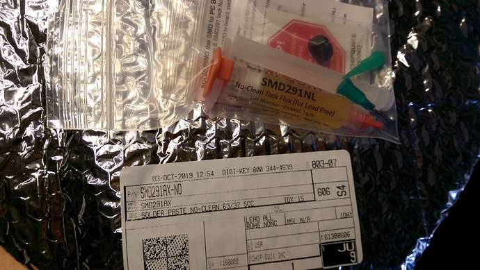

Hit a bit of a snag when I started doing batch assembly for the tester boards today. I ran out of solder paste… The syringe in the picture is bottomed out.
Luckily, earlier I had ordered more solder paste from digi-key, as I was starting to run low so I was kind of glad when I got the order and looked into the pack and… Well let’s just play a little “find the inconsistency in the picture” with the image below and figure out what went wrong… I have already contacted their customer support about this.
Guess I’m gonna make a little visit to the office this evening and “borrow” their non-leaded paste from the lab’s fridge, so I can continue the assembly during the weekend and likely finish all the 14-15 pieces of tester boards.
Why would you name both paste and flux starting with SMD291…:upside_down_face:
