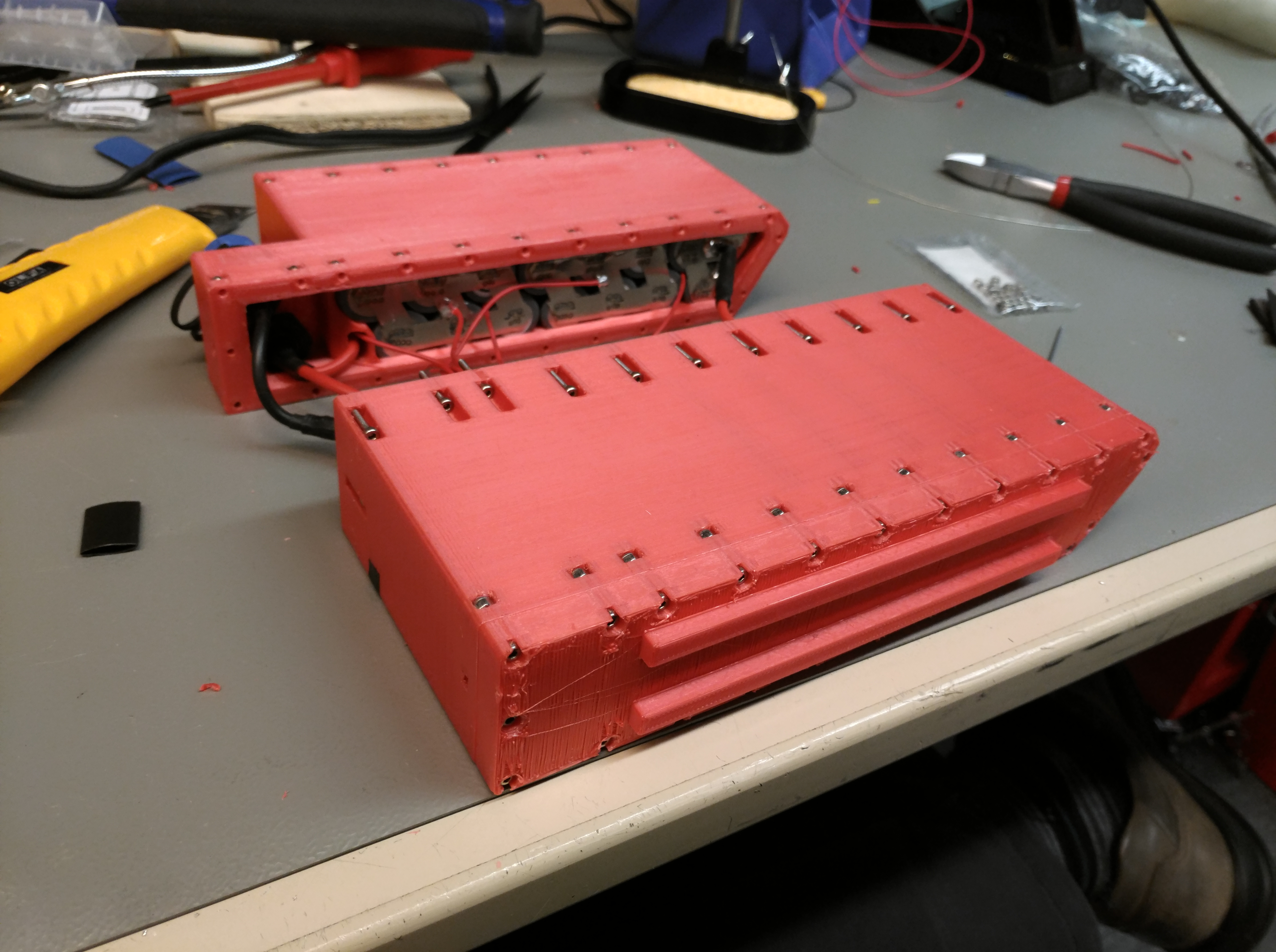

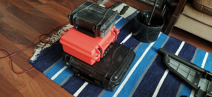

I’m building a new pack for my everyday riding. I’m stepping up to a bigger enclosure, but not into the mega-pack I’ll be building in the summer. I’ve been using these Pelican-style carrying cases (SE/Seahorse-series from Serpac), as they are nice and rugged + they are water & airtight (as long as I seal my connector holes properly).
Here are my current enclosures, with my current pack (smallest) being on top. My new intermediate pack in the orange/red in the middle and then the mega-pack at the bottom.
Top: SE120, 10S6P 35E, ~700 Wh
Middle: SE300, 12S7P 50E, ~1450 Wh
Bottom: SE520, 12S36P 35E, ~5000+ Wh

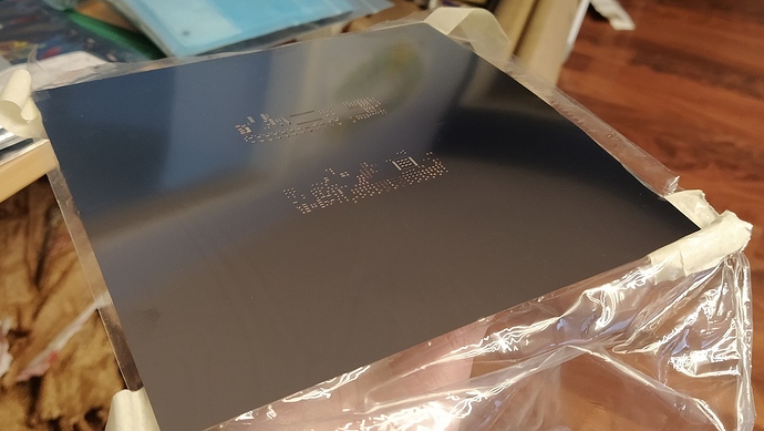

I’m ordering the 0.5-1 boards today, alongside a couple other boards and a stencil for the BMS. Depending on how things flow time-wise, I might try to do the assembling of the next tester batch with the PnP depending on how much tinkering I need to do to first build it, configure, calibrate and learn to workflow on it.

@SimosMCmuffinn where did you get those enclosures? Thanks
I buy mine from Digi-key.
https://www.digikey.com/products/en/boxes-enclosures-racks/boxes/594?k=&pkeyword=&sv=0&s=38357&sf=0&FV=-8|594%2C1989|0&quantity=&ColumnSort=0&page=1&stock=1&pageSize=25

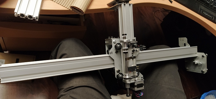

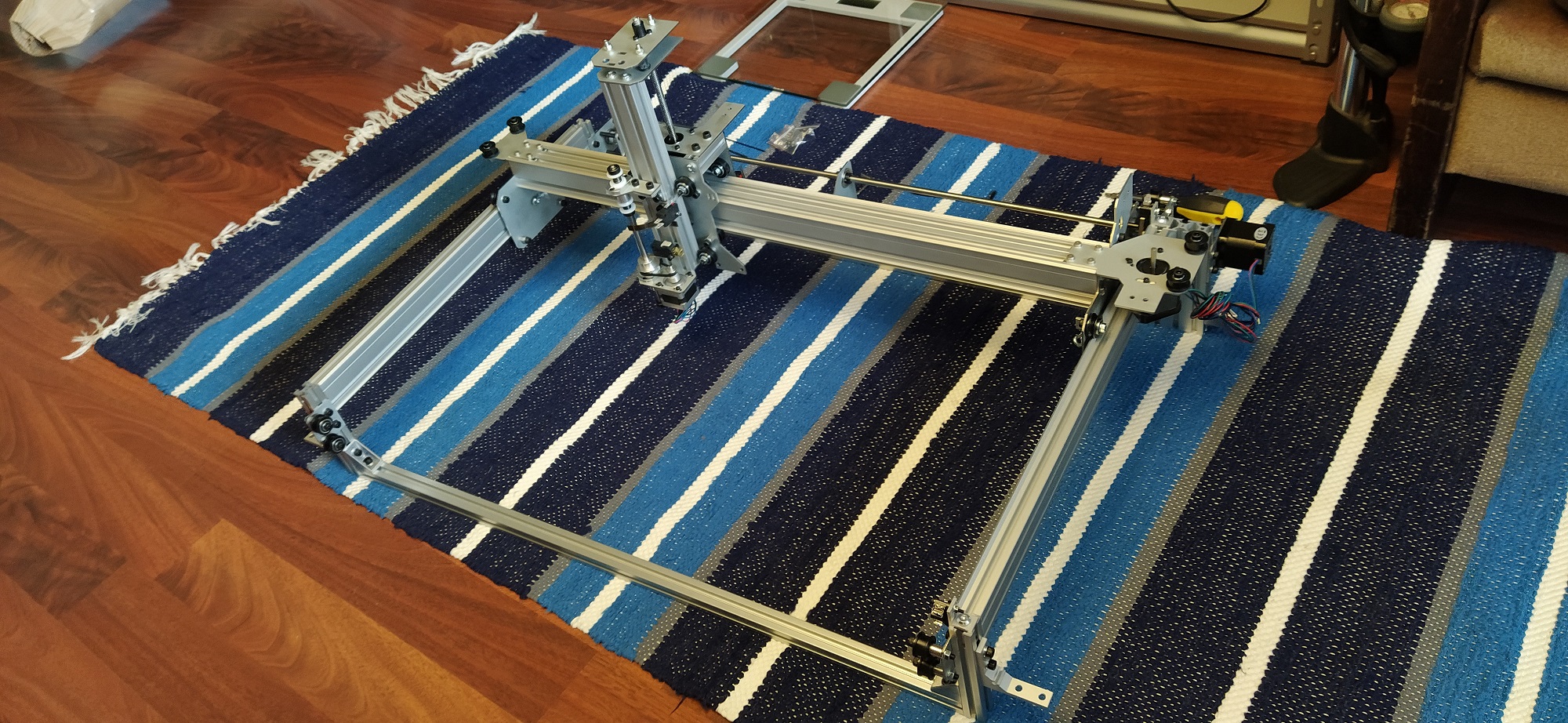

Got the LitePlacer kit yesterday, have the frame mostly assembled at this point. Gonna back out the bolts a little bit, true the chassis, re-tighten and bolt it to the table today.
Also got the 0.5-1 PCBs and the stencil for them. Need to build a jig for this at some point and practice using it.

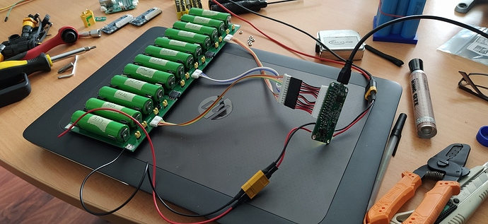

Have wired and been testing the practical test battery for the production tester.

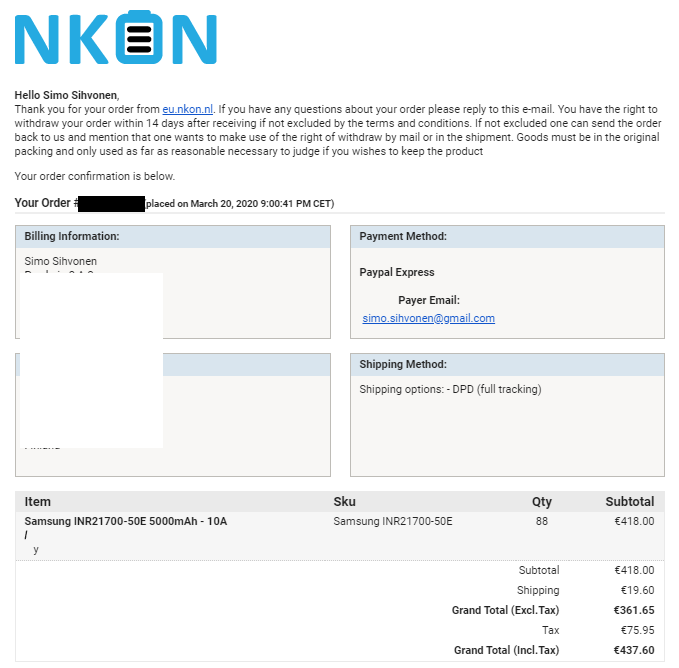

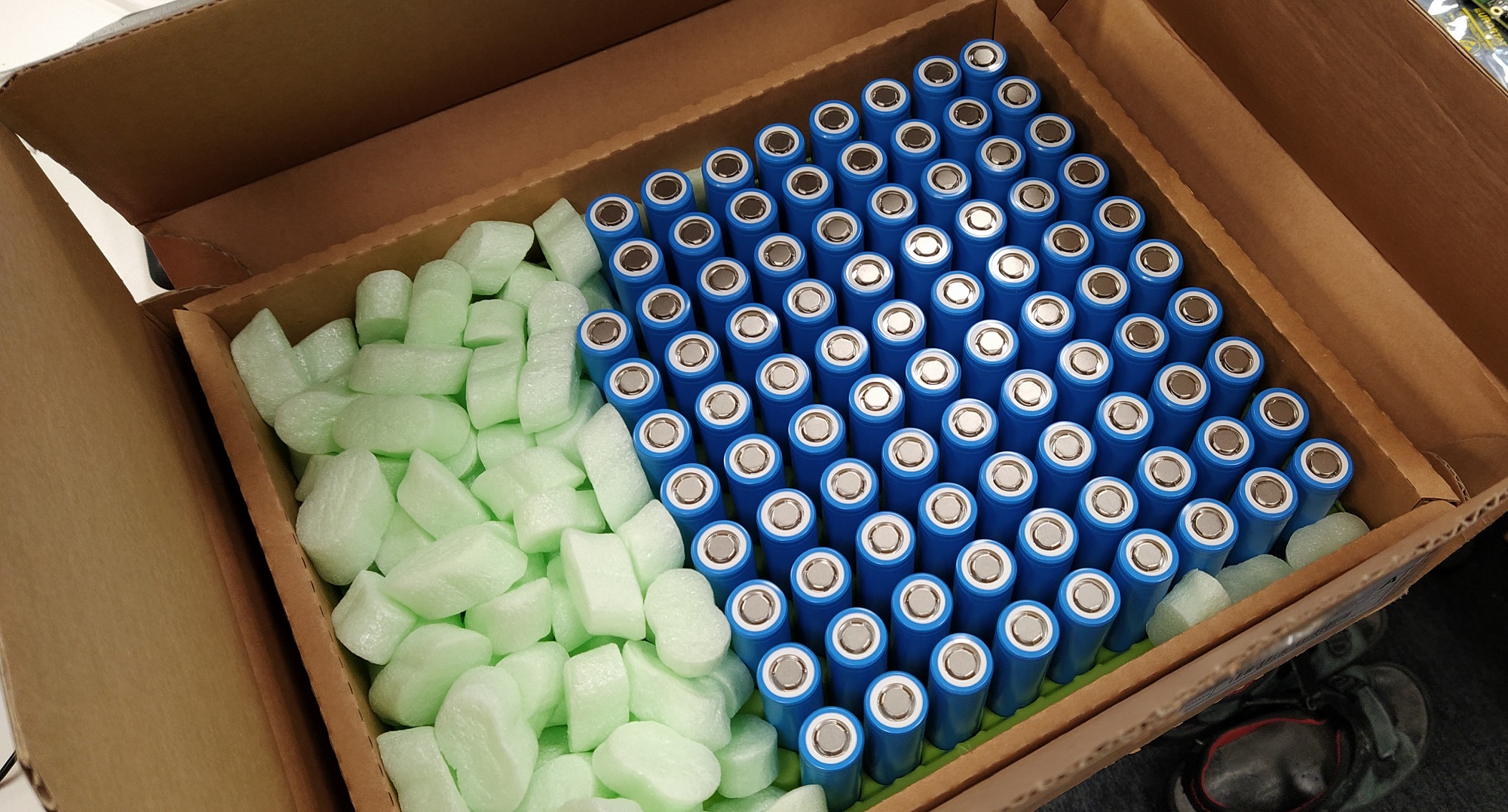

Got my new 21700-50E cells for my new pack.

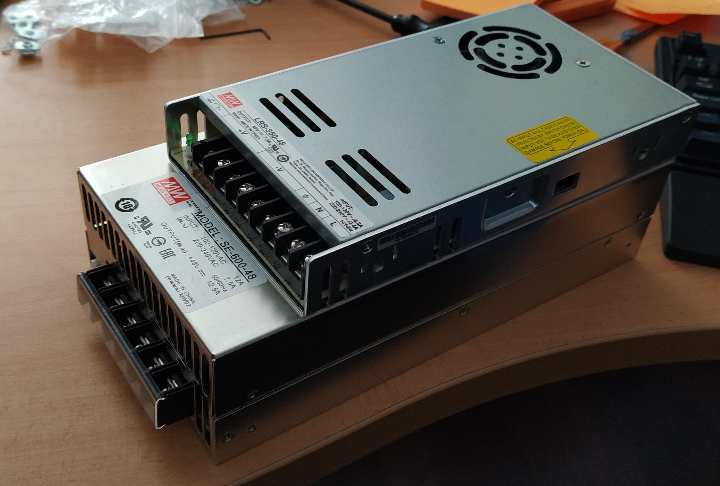

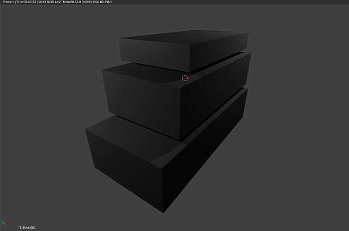

Here’s a quick rendering of the comparative sizes of the PSUs. From top:
MW LRS-350
MW SE-600
NVVV S-1200
Here’s an actual image of the two Mean Well units on top each other.
The SE-600 is already a pretty chonky boi in it’s size and I still need to attach the DPS-buck regulator to it. Probably gonna try to attach it in length direction. It’s gonna be pretty dang long unit, but I think it would still fit into my travel pack that way without eating too much space.
I wouldn’t recommend the DPS-bucks (at least 5015 or 5020) for anything higher than 12S, as the output voltage is limited indeed to 50.0 V.
Gonna be pretty big and you need to still ensure you get good airflow if you do double+ stack the PSUs. Not a problem with the MW SE-600 or NVVV S-1200, as they are “blow-through” ventilated, but problem for the LRS-350, as the fan pulls in from the top and exhausts from back.
DPS5015 and 5020 spec "Input voltage range: 6.00-60.00V ", but you need 55 V input at least to get the 50.0 V output, so configuring the PSUs to output 55-57 V would be the sweet spot.

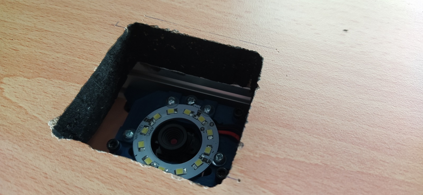

LitePlacer has been bolted to the table and I have made the hole for the up-looking camera and mounted it. It hasn’t been calibrated in case you’re wondering that it looks crooked. Need to do some office work today.
