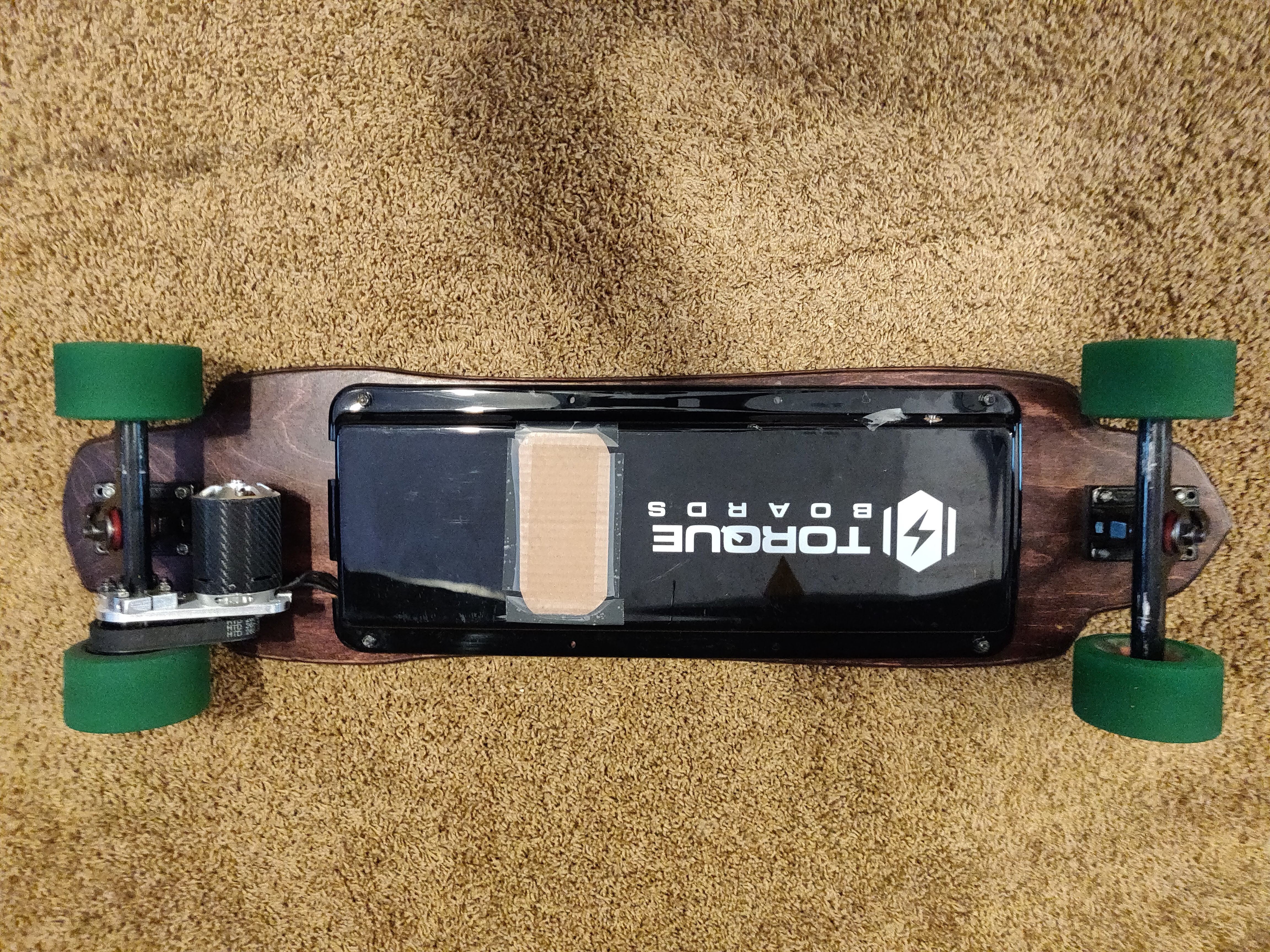

Hello everyone, my name is Anshul Bajaj. I am 15 years old. I am a maker, designer, entrepreneur, and machinist. I have been running CNCs, laser cutters, and 3d printers since I was 12 years old. I have been making longboard decks for the last three years. In the last year I got into machining metal. The goal of this built was to make as much as I could and keep the board as affordable as possible.

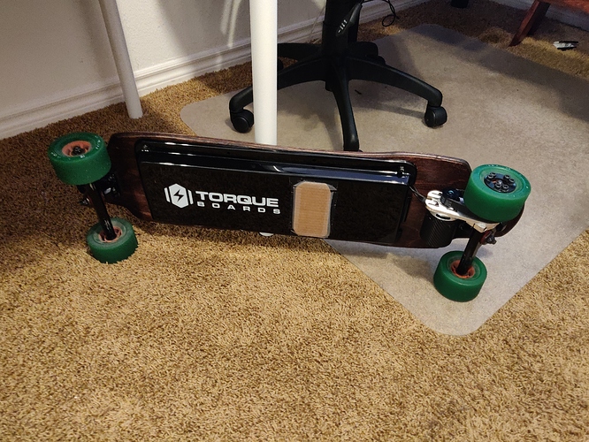

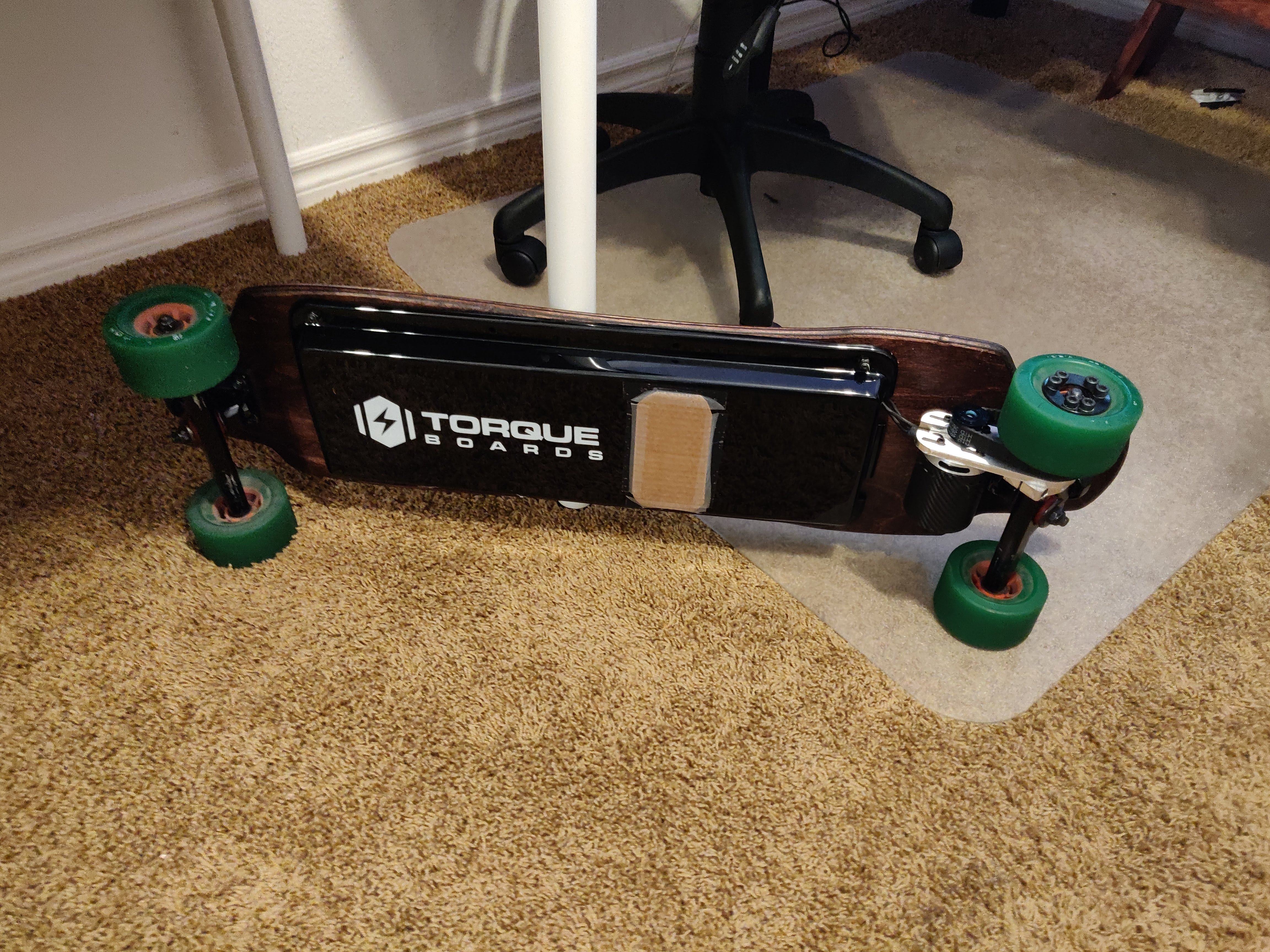

Here is the board. (Please comment name suggestions)
The deck was custom machined by me. I drew the board outline in illustrator. I then glued up the ply sheets and put the stack into a hydraulic press. I then cut the deck out on a CNC I built last year. The deck was then stained this dark cherry and was coated in wipe on poly.

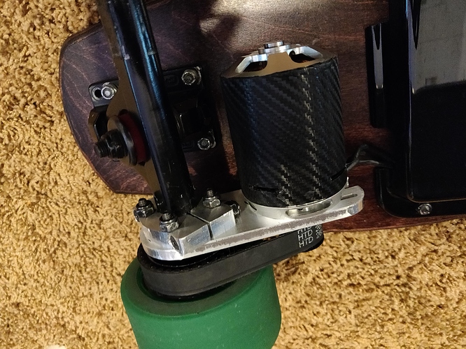

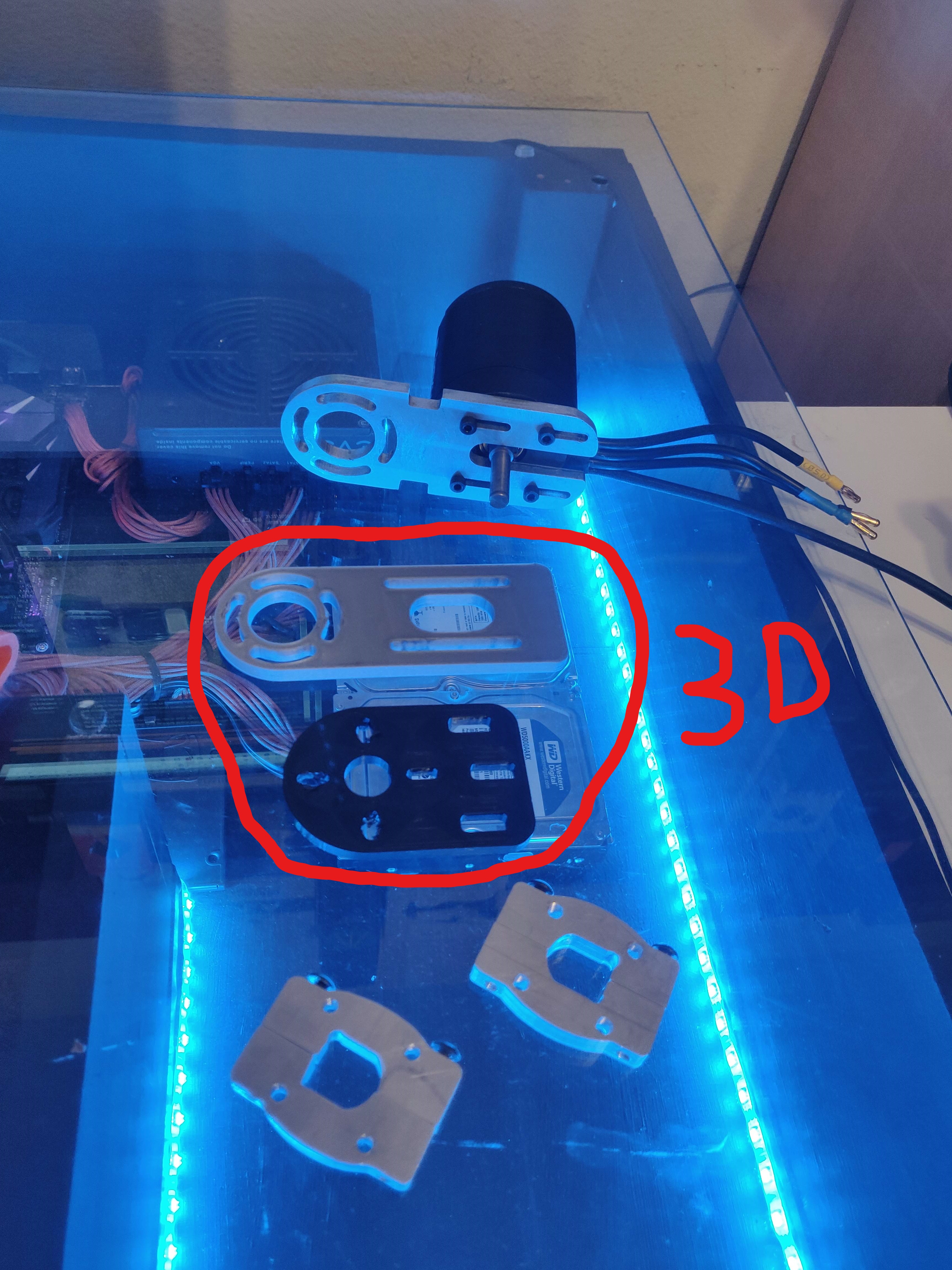

The motor mount was also custom machined. The mount was drawn up in onshape CAD. The cam was then done in camlab and milled out on an xcarve cnc. Both the motor plate and clamp took 35 minutes to run. I 3d printed a multitude of versions (tried the enertion style as well). I finally settled on a design that took some cues from torqueboards and boardnamics, but I also threw in my own ideas.
I wrapped the motor in carbon fiber vinyl to add some extra flare!

Boy I really need to replace the carboard cover!

How are your custom parts working for you so far? Is your motor mount staying put?
Bad ass. I wish I had your fabrication skills at the age of 15. Keep up the awesome work.
everything works great. The clamp is very secure. 10-32 everything ('MERICA).

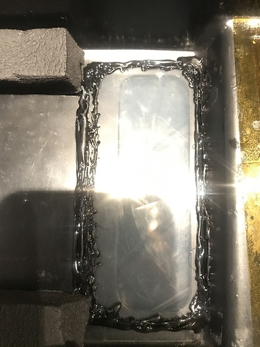

Hey man really nice work wish I was as smart as you when I was 15. I ran into that issue with that enclosure as well. Used some clear plastic (think I cut up a Tupperware) on the inside with hot glue to dustproof/“waterproof” it.
That is a good idea. I may laser cut and engrave a small plexiglass plate.
