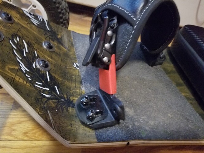

designed some TPU stops for the bindings. basically they prevent the binding from falling down past a certain point. I got tired of constantly readjusting my bindings. now they are always in the perfect position.

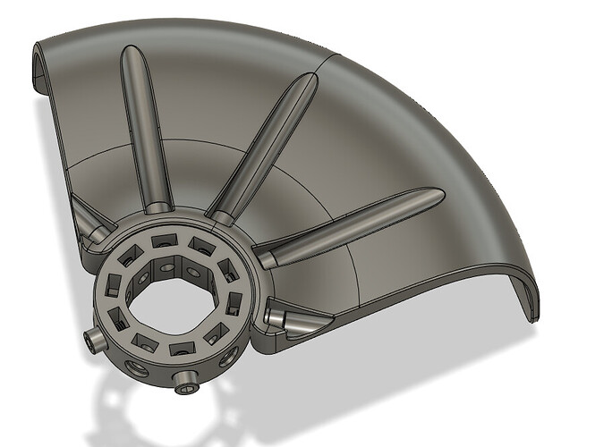

made some mud guards for mbs trucks and moon drives.
3d printed in petg. the front guard lasted about 3 rides(about60 miles total) before developing a small crack. fairly decent considering I was doing offroad and jumping and the board rolled over a few times.
already working on the second revision.
the second mk2 fender is thicker around the screw area. and it will also have some 3d printed tpu washers to help with vibrations. the clamp is also a one piece design this time and its adjustable with entrapped nuts. it even uses the same m4 socket cap bolts as the moon drive for added convenience.
the moon drive fender did really well. It didnt break after ~100 miles and a mixture of offroad, cobblestone, and jumps.
It did finally break when I dropped the board and it fell upside-down on concrete. this design is solid tho. I’m going to make minor changes and reprint.
