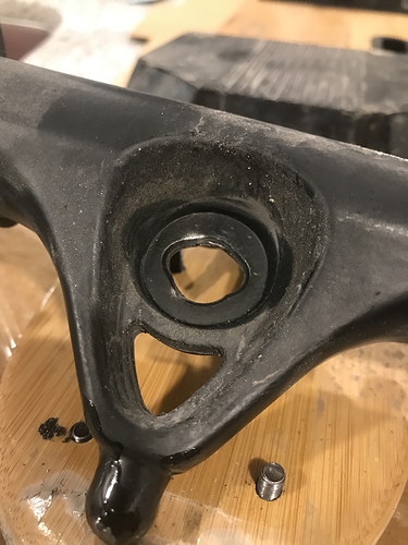

Hey guys, I was curious if a bushing upgrade is a worthy first mod? I see a lot of posts about nicer bushing making a big difference…,but is it just better to get a nicer Paris front truck instead?
Either or. Bushings are a great start. I have some randal clones I’m not using
Whatt? Whats the science behind this?

Nice! I assume the bushings need to match the originals in shape and size?
@tesla-tech
Not exactly. Mine started off with barrels and now I’m running a barrel board side and a cone street side up front for turning. The thickness boardside needs to match so the geometry of the trucks is the same though
I removed the trucks and measured the bushings, all 4 seem to be the same size. Flat round ones 16mm thick and a 27mm diameter.
Look into riptides pivot cups and bushing I run them on my builds . its a world of a difference between stock bushings and cups
This, so much this. Magnum/Cannon and wfb pivot cups. Ride & Don’t look back.
Ok cool. I sent emails to riptide and venom to see what they recommend since I have no experience with this haha.
I know the originals are soft because the wowgo site says “comfort”…and there are a few times I’ve gotten speed wobble
