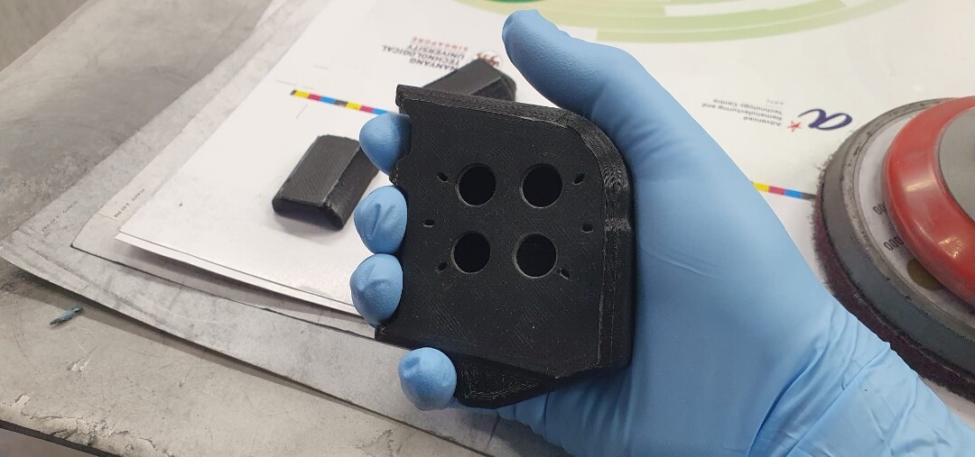

I’m switching mine to this case soon:
Carbon fiber is a signal blocker, careful with putting your remote receiver behind it!
It’s also conductive so you can short electronics on it.

Yeah I’ve been (kindly) warned by many of you. I’m planning on putting the receiver on top of the board by routing it and putting it under some grip tape.
All of my enclosure will be padded hopefully so there should be no contact between any live wires and the board.

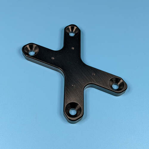

Routing the receiver or antenna outside of the enclosure isn’t too difficult to do, so that should solve that problem (I owned an Eovan GTS Carbon Pro, and they mount the antenna on the rear truck plate to solve this issue).
Yep, seems like OP has been (kindly) warned already.
It’s actually super helpful advice. I took a look and putting the receiver in a small 3d printed box on the rear truck seems like a great idea. Although I do appreciate the (kind) concern from you all :joy:
Attaching it to a deck “x-thing” would be another good way to go.
Like this:
