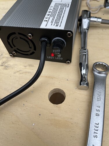

Is the light on the charger itself green or red?
LED 1 is red - per the manual (on Amazon) this is power on
LED 2 is green - per the manual it should be red while charging and green when fully charged.
The batteries are about 3.7 V on average so definitely not fully charged…

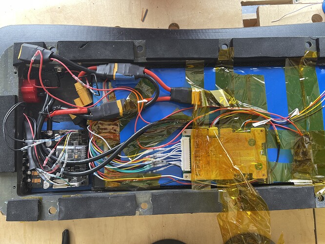

Or send photographs of the wiring if you want someone to doublecheck it.
If wired correctly though, the loopkey should not need to be plugged in for it to charge.
Is it wired this way?
That’s what I followed… I don’t have any lights yet so nothing on P-… Plugging in the loop key didn’t change anything.

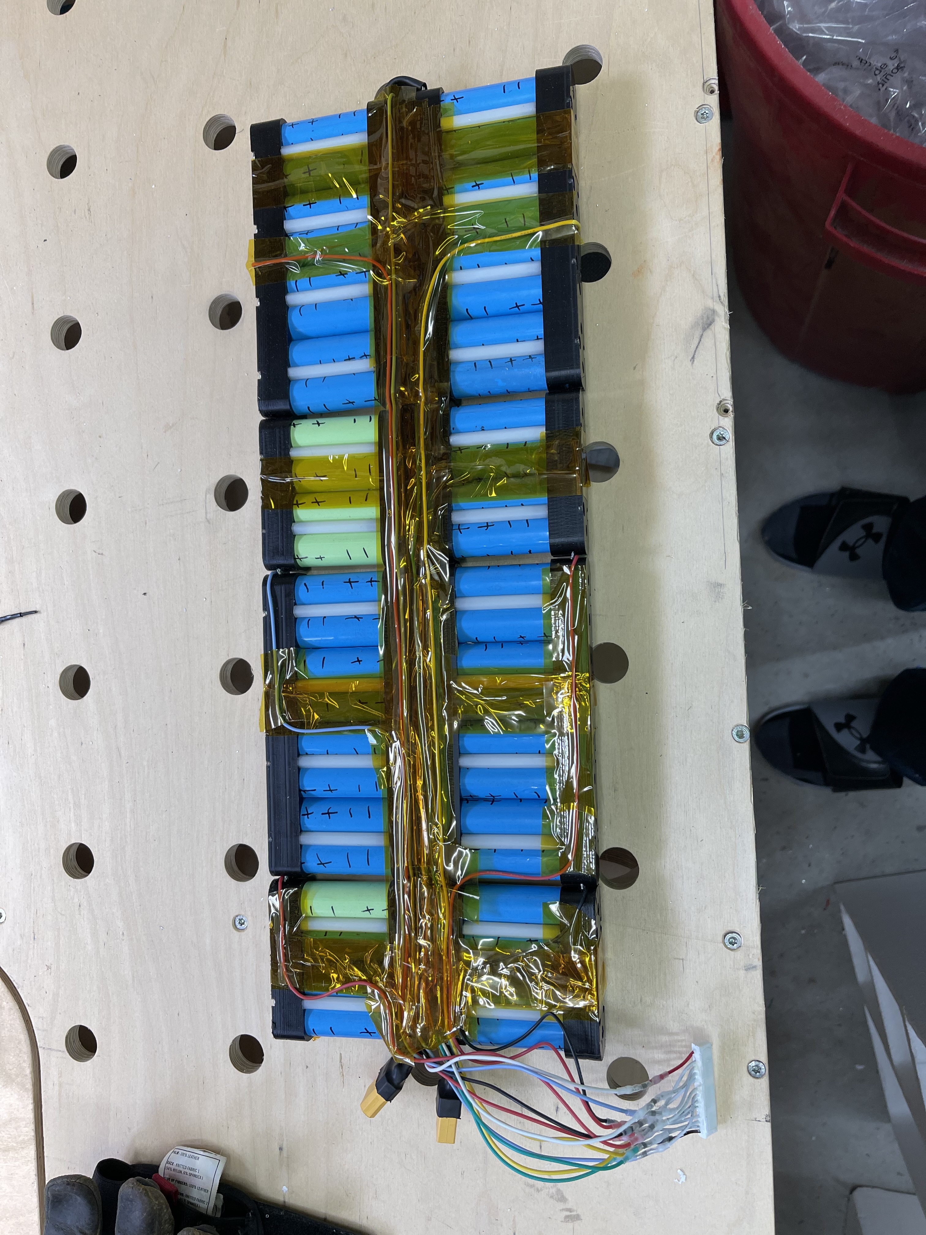

I checked the BMS connections. The negative wire to negative out of the battery is 0, each successive wire increases about 4 ish volts up to 48. It’s a little less since the battery has drained some.

You have up to 0.2v of diference between cells, i’m pretry sure the bms doesn’t let you charge with such a huge gap
You should have no more than 0.05 difference,

I made the battery. I used a LiitoKala Engineer Lii-500 to Nortest all of the batteries but they laid dormant for 3 months while I made the build.
Take it apart and charge them again with the LiitoKala?
What cells are they and how do you plan to take them appart ?
I’d suggest to try charging each Pgroup one by one , very slowly using the balance wires and your litokala charger,
None of the cells seems to have reached a critical level, but i don’t think such a discharge is normal even for three months,
Edit : if you do that, take your time, use low amps charging, and don’t let the battery unatended, you don’t want a lipo fire
I used a slightly modified version of the @winfly modular solderless holder for the batteries.
The batteries are Panasonic NCR18650BD and recommend to charge at 1 Amp. Since I have them in a 12S4P configuration my 4 Amp charger should be good. I’m not sure how to charge them with the LiitoKala without taking them apart?

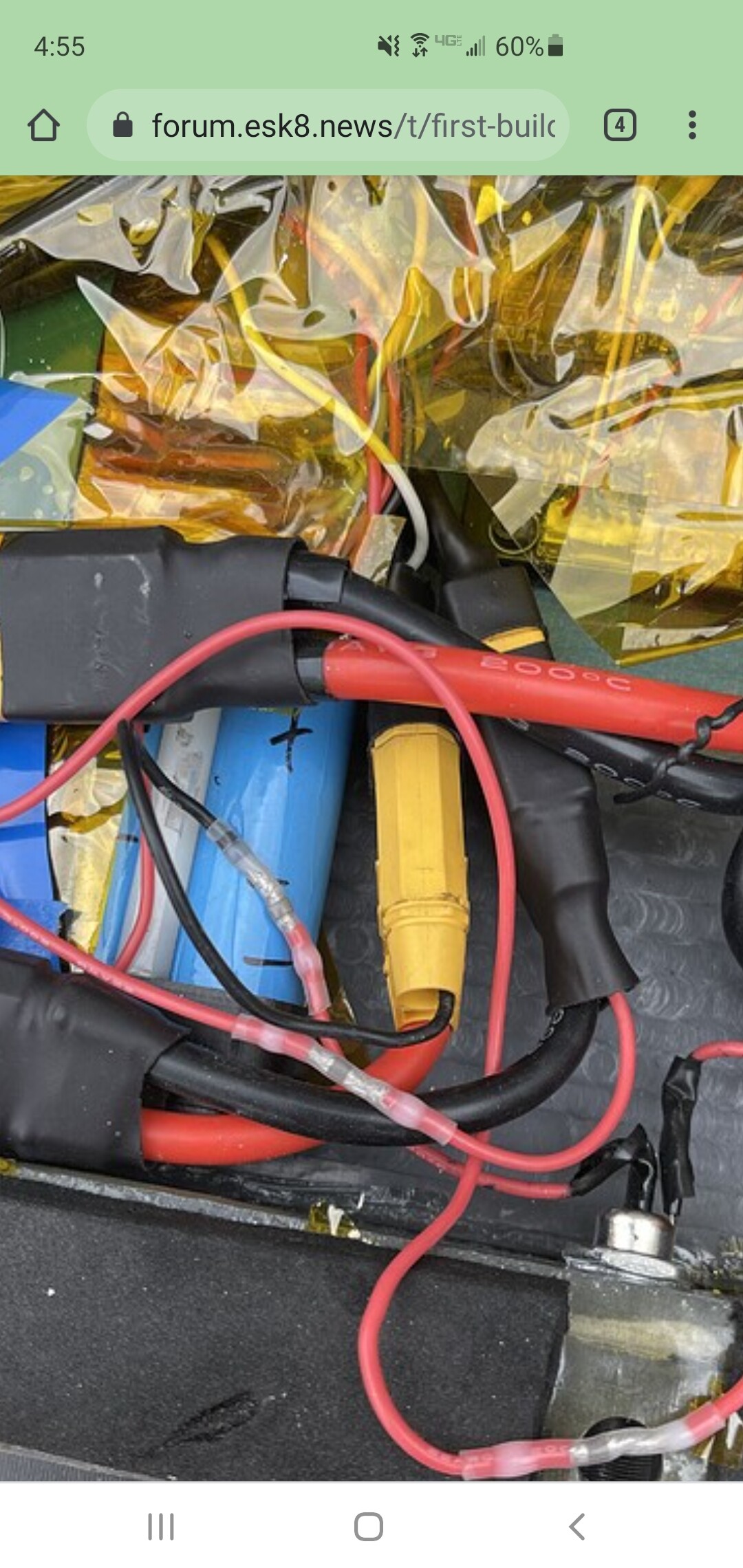

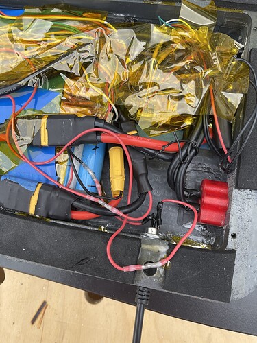

Is the negative of the charge port supposed to be going in to an xt connector?
No, the negative from the XT90 negative lead goes to the B-. The negative from the charge port goes to the fuse then the C-. The positive from the charge port goes to the XT90 positive lead.
The braided tinned copper are soldered to XT90 essentially bridging the two connectors. So I have two female XT90 each with a 10Awg wire from one connector that lead to the loop key XT’s and I soldered the smaller gauge wires from the BMS and charge ports to the second connector. Hope that makes sense.
That’s some weird ass wiring haha!
But should be safe I guess :slight_smile:
Just technically makes you able to switch the polarity by mistake… normal wiring would prevent that.

Yea, I realized I should have used one male one female for each battery terminal. I double check before I plug either one in😄.
