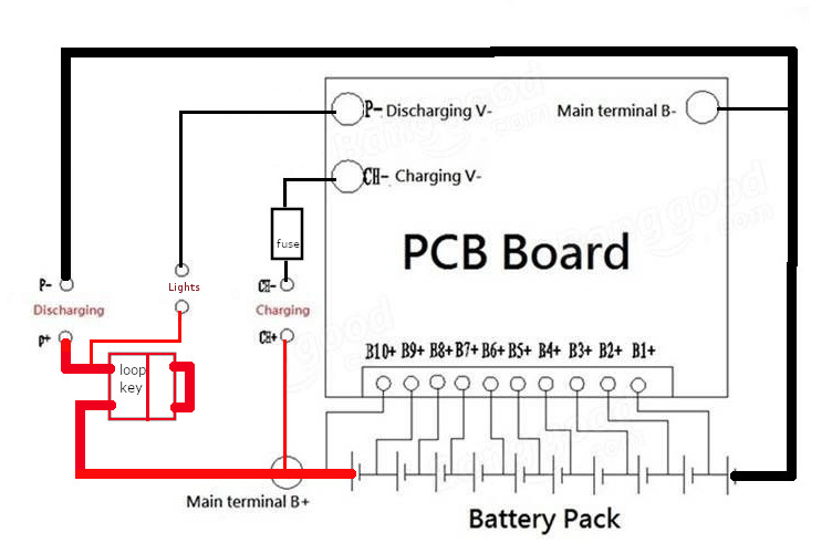

I would like to know if the choice of components works well together and if my battery diagram seems ok?
  1. (Single) FSESC 6.6 from Flipsky
  2. (Single) 6384 Flipsky 190KV
  3. Wireless Bluetooth Module 2.4G Flipsky
  4. Try to build a 12s4p - 44.4v 60A with 48 Samsung 30Q
  5. BMS is SuPower (batterysupports) 12s 60A

Any advice about the battery connection ? It’s right ?
technically yes, if you want the discharge to be controlled by the bms, typically that’s not suggested cause the BMS could cut power from the vesc. to bypass that, run b- and b+ to the vesc. the BMS still needs the b- connected for charging, just don’t run anything from BMS to ESC. for power on/off you could use a loopkey

that diagram is wired with discharge, which limits your option. Its generally considered better to bypass for charge only (ESC and Charge run parallel) then you can get a 10 Amp BMS, which is cheaper and smaller

@Scepterr @Agressivstreetlamp Ok, If I understand well :
  • Keep the BMS only for recharging because the samsung 30q are good enough to need the BMS only during charging? So I’ll take a BMS with a max charge load of 10A (I’ve planed to buy this charger : https://www.aliexpress.com/item/32983504779.html)
  • What about the security? If I bypass the BMS during the discharge I will not have the feature over-discharge, over-current, short-circuit protection, etc. no ? The over-discharge is handle by the VESC I thing but for other ?
  • Can you help me by taking my diagram and modify it with the bypass? I’m afraid of being wrong.

VESC does all the discharge regulation you’ll need.
It’s not strictly wrong to have a discharge bms, just a bit unnecessary.
For the wiring diagram Theresa lots out there, but I’ll check for some once i get working
variations for different BMS exist.

Np, and I forgot that Scepterr already gave me the solution with my BMS : to bypass that, run b- and b+ to the vesc. the BMS still needs the b- connected for charging, just don’t run anything from BMS to ESC.
