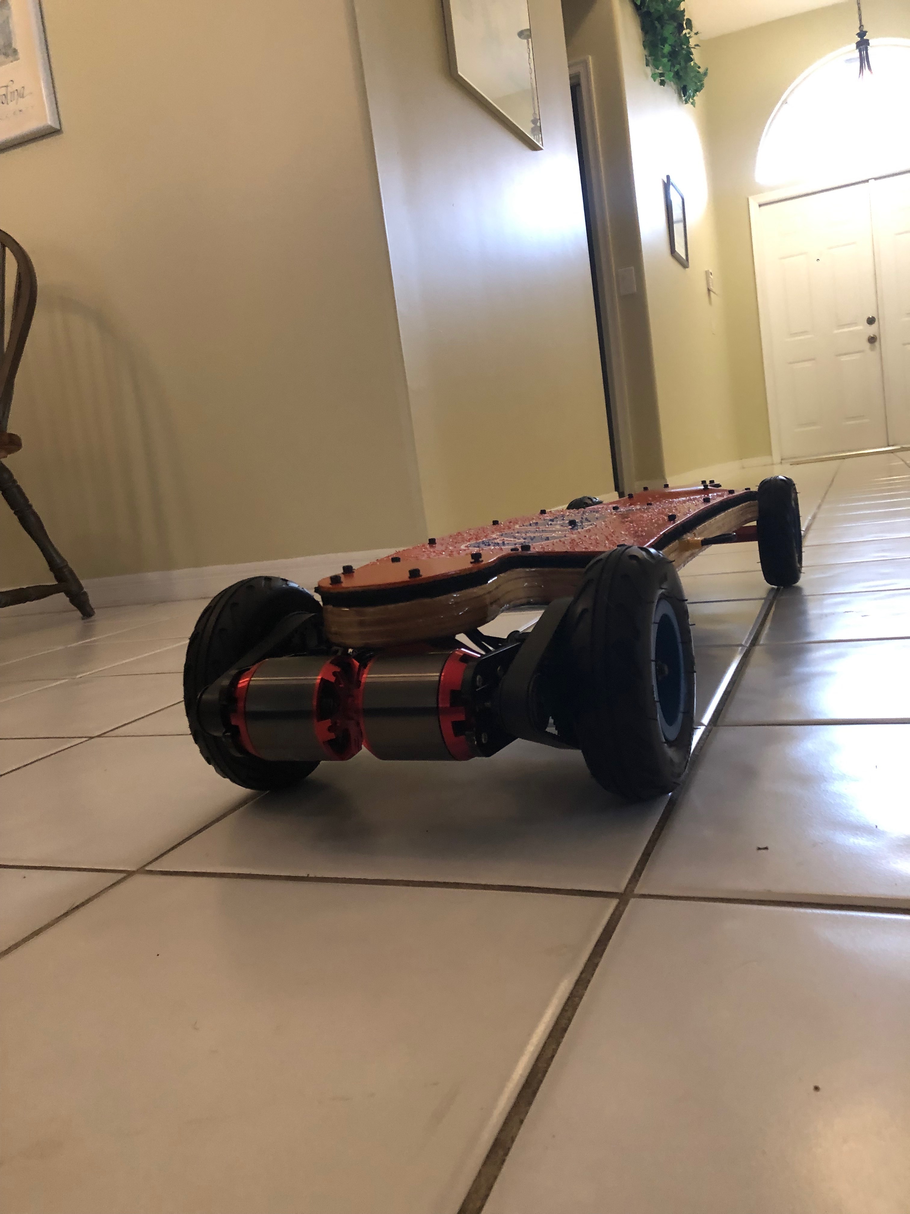

Being a UofF Alum a Gator themed board was mandatory for my first build. Specs:
Deck: Rocket Hollow Core @evoheyax
Trucks: Torqueboards 218s @torqueboards
Wheels: Psychotiller six shooters @Psychotiller
Motor Mounts: Torqueboards reverse mounts @torqueboards
Motors: Maytech 6369s 200KV @Psychotiller
Battery: 10s5p Samsung 30q @thisguyhere
VESCs: Vesc6+ @Trampa
Remote: Hoyt Puck
Telemetry: Metr Pro @rpasichnyk @hexakopter

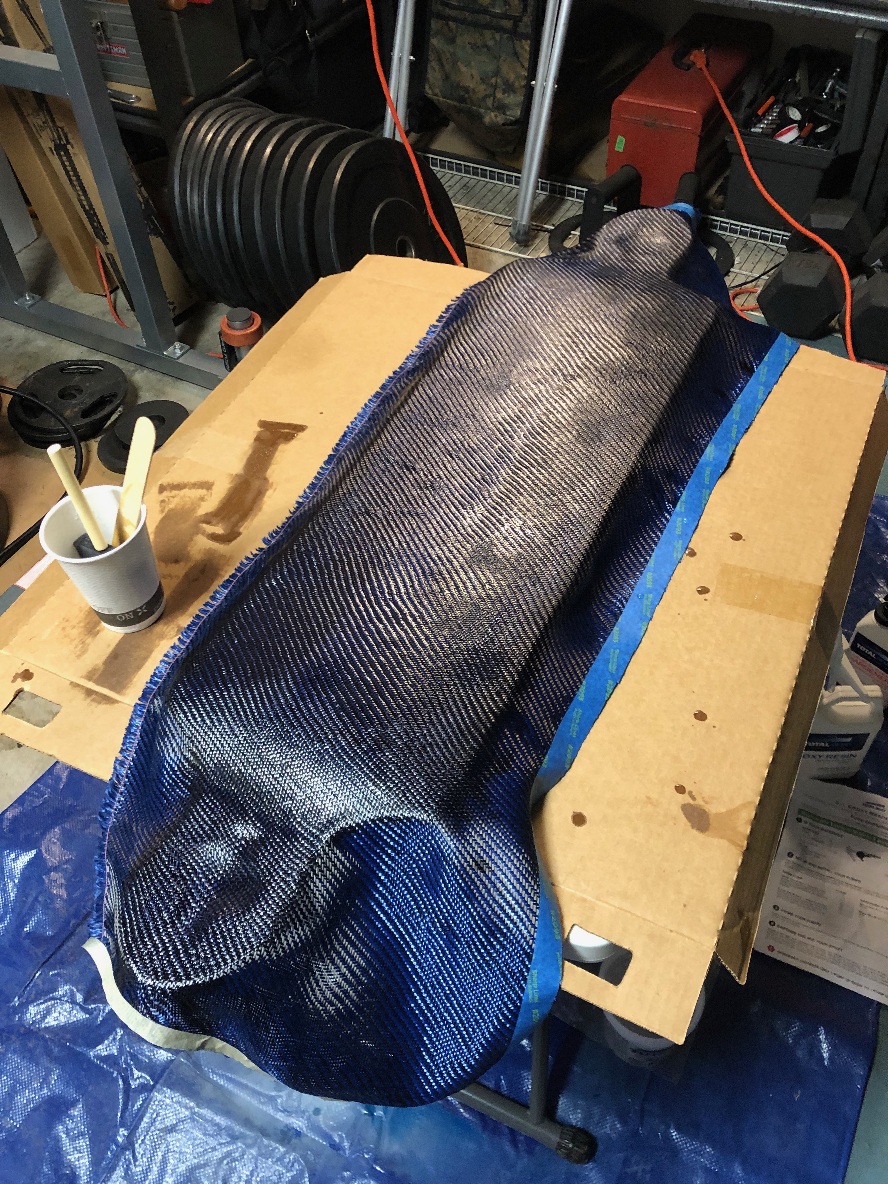

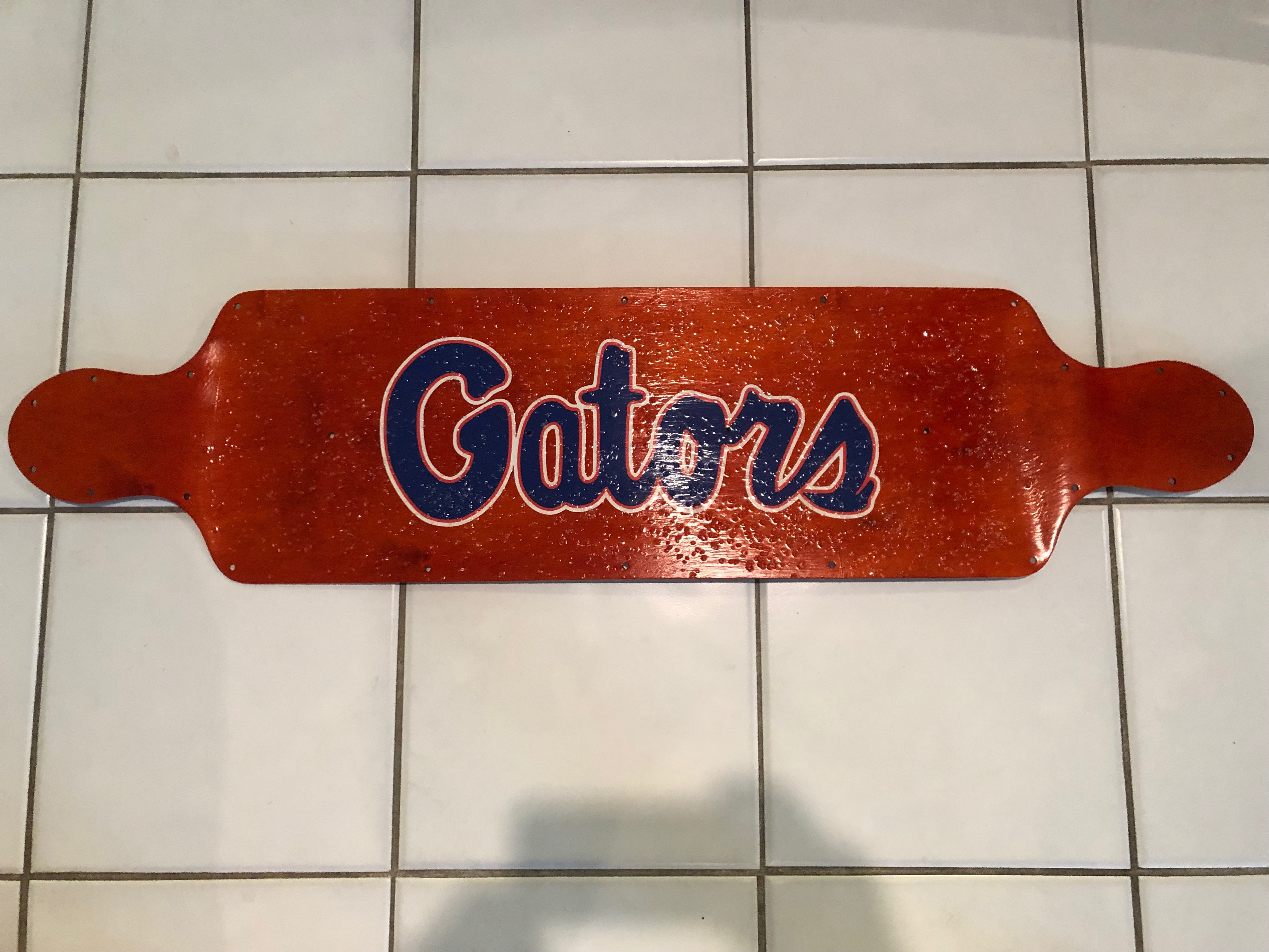

I stained the top Gator orange added the Gators logo and glass frit, finished off with Minwax spar varnish.

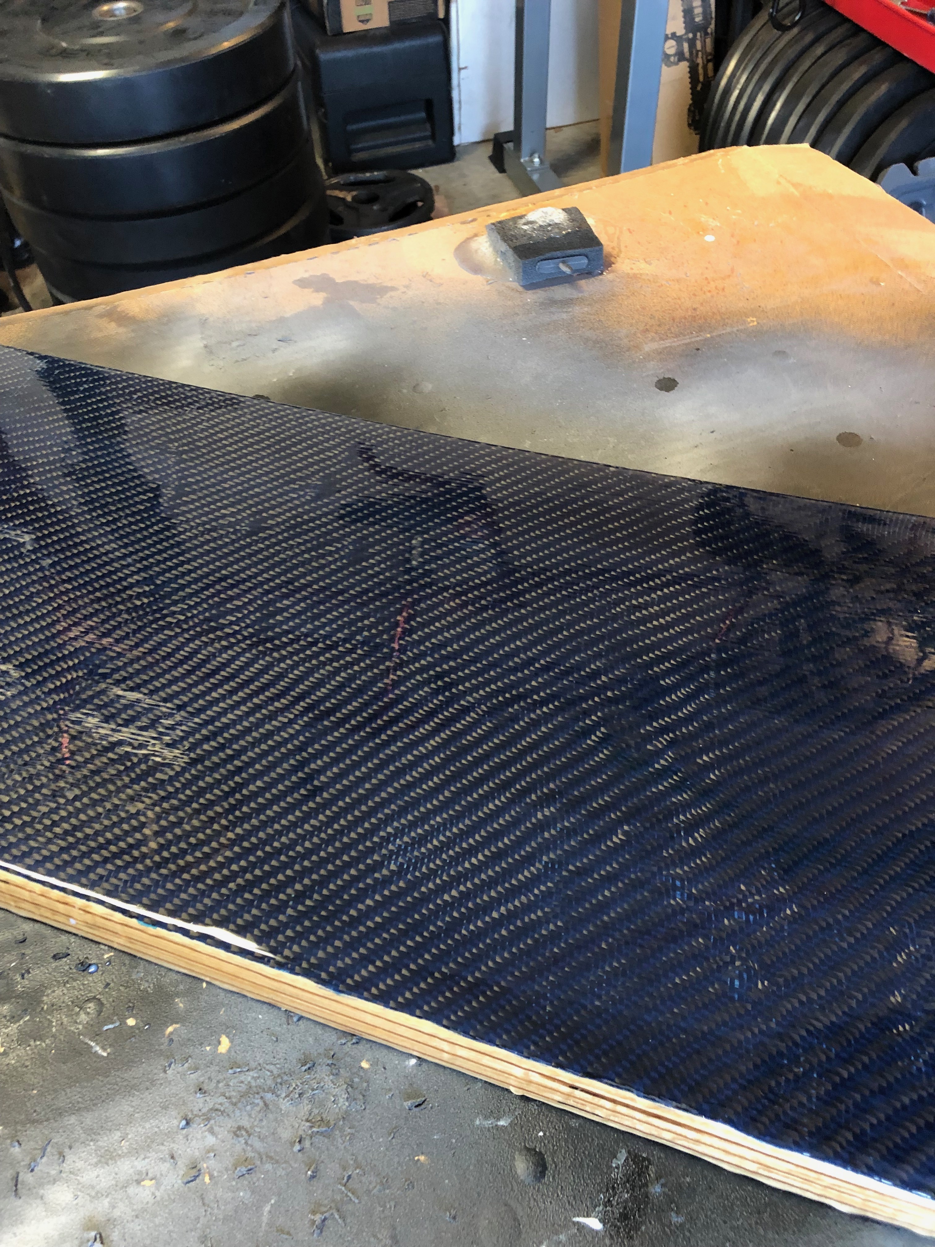

I skinned the bottom with blue/black Kevlar/CF cloth. The blue is a little dark and hard to see in pics, but shows up nicely in sunlight.
I painted and clear coated the TB128s and SixShooters.

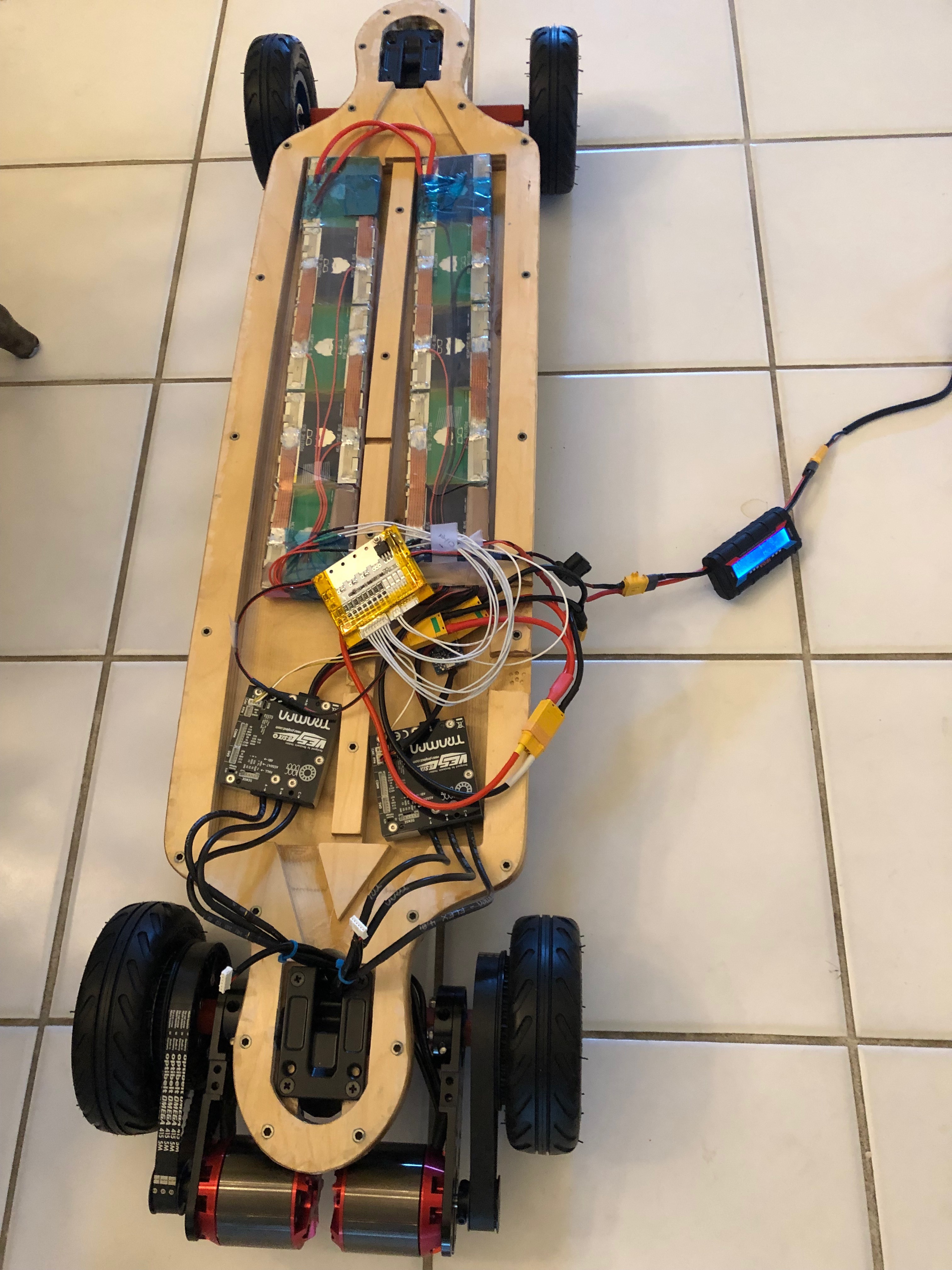

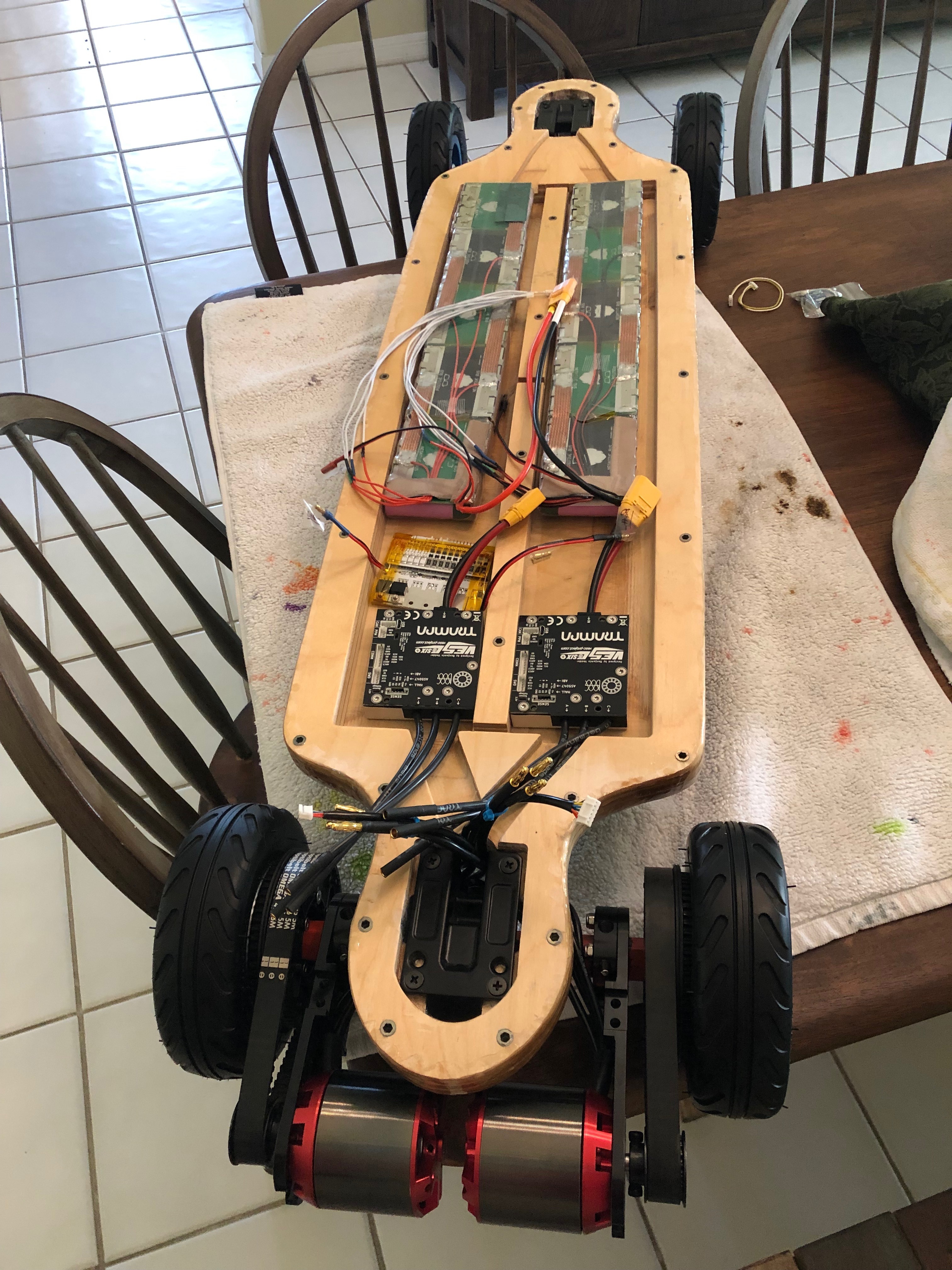

First charge before all the electronics were secured.
It’s alive.
Thanks for all the unbelievable information on this great site. This is a fantastic resource for any DIYers.
Looks fantastic dude. Quite a professional job. Did the deck retain any flex? (Sorry if you said it, I can’t actually read, I just look at the pictures)
No flex, but it didn’t have any to begin with. :grinning:
That’s what the air in your wheels is for :call_me_hand:t3:
