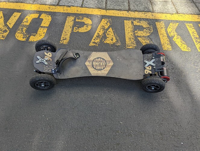

So ginger needed to test fit and get glamour shots of his prototype FIRESAK and we put my chonky street bro in it it’s big and can fit all my boards. It has shoulder straps and easily slings around a 45lb board. Metal zipper, double reinforced stitching, blowholes for pressure relief and probably other things I’m forgetting
Have tested fitting:
Street bro
Mountain bro
Gtr
Hoyt EL1
Boosted V2
Hoyt booger
Measures 44x17x9"
If you have questions holler, I’ll try to answer or ask ginger

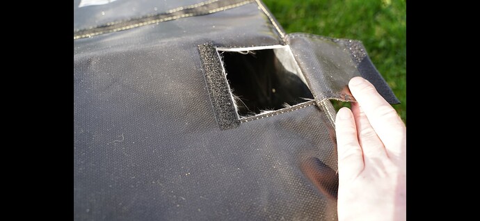

Those small square holes are for releasing out pressure I assume?
Yes! Exactly

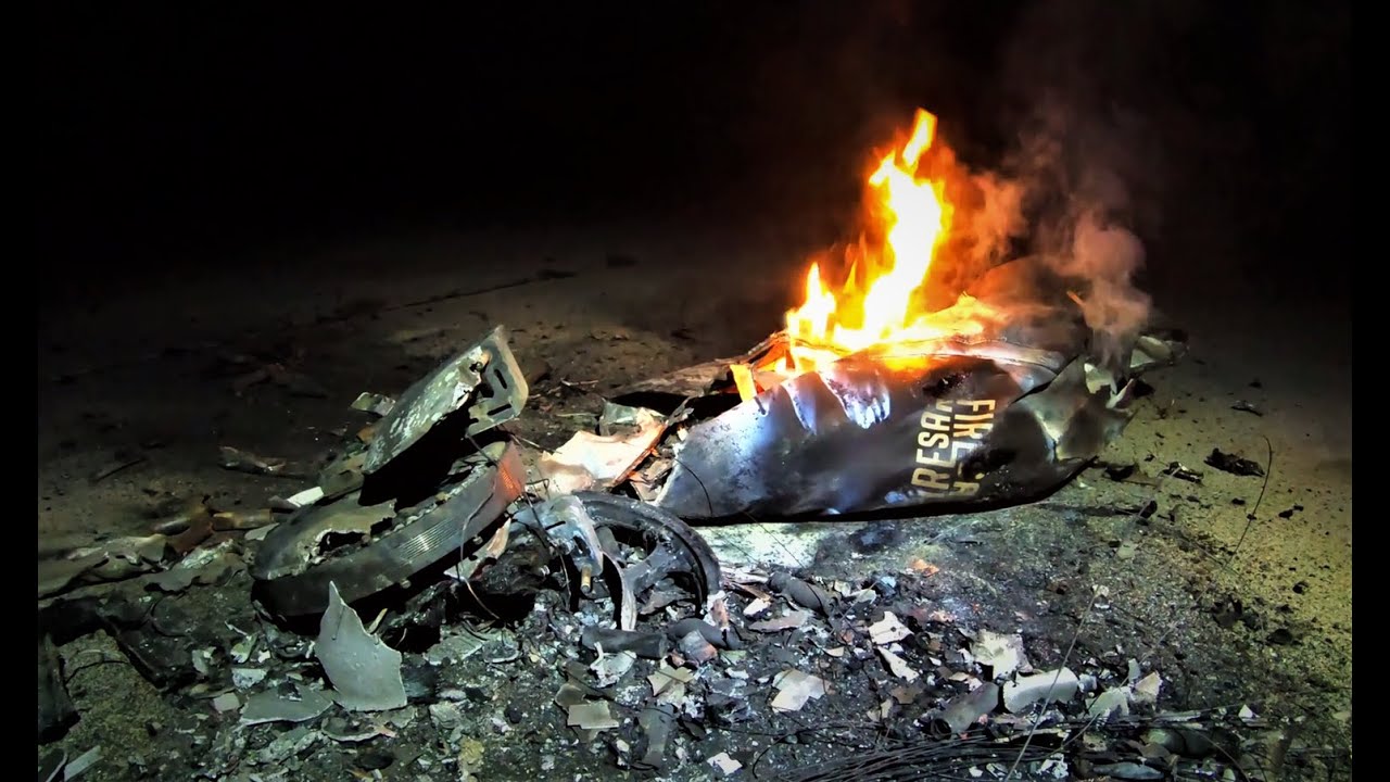

Here is the first prototype for EUC, some changes were made

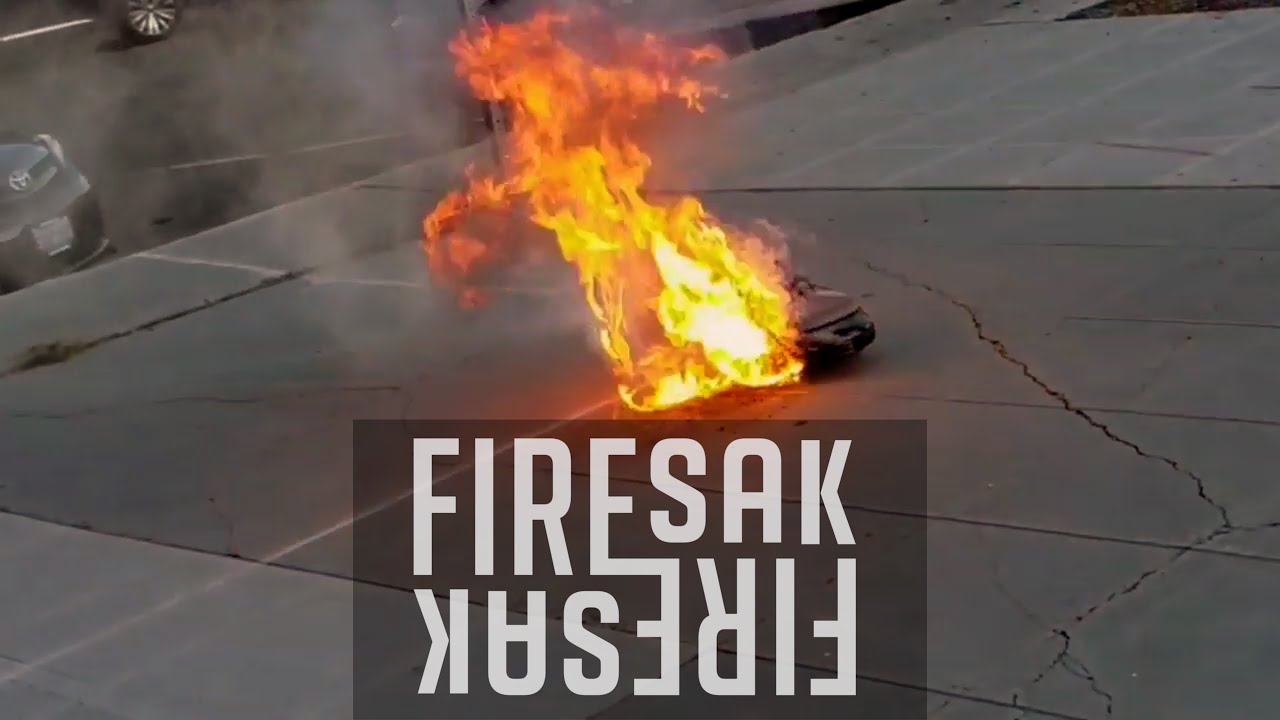

This is production EUC bag. This video has good booms
Had a quick look on their website and couldn’t find any info on how much big of a battery I can „safe“ store in those.
Would be nice to have something like
„not recommended to use with batteries bigger XYkWh“ in the description.
According to the YT video those bags look pretty promising, but I guess they have their limits as well.
I’m impressed!
What’s the max temperature seen under the bag during a test like that? My only concern is that enough heat is escaping the bag to cause damage to the surface it was resting on and, possibly, ignite something that was fairly flammable. Unlikely but it all depends on the external bag temp.
It adds cost and weight but it would have been great to have a layer of rigid material sewn in on the bottom for added insulation to prevent damage to the surface the bag was resting on. Just a wish-list type thing. :slightly_smiling_face:
Cheesenrice, this guy needs wayyyy more (any) safety protections. For a guy testing a safety product, he sure is lax about his own personal safety.
Like… at least get a longer stick. And don’t look directly at the fire while saying things like “there’s no way all those cells exploded yet!”
Or point out the toxic gasses while standing less than 10 ft away… without a mask
But YouTuber aside, the performance of the bag was quite impressive!
I echo @Battery_Mooch - I’m trying to imagine where you could practically store/use this so nothing flammable was below or to the sides of it. Center of the garage is ideal, but no one will do that. No carpeted areas. Those flames shooting out the ports will surely melt anything nearby. Maybe outdoors? Maybe a metal storage shed?
Definitely better than no bag, but it bears some careful planning.
They could use some giant warning labels around the vents to the effect of “POINT AWAY FROM WALL” or “DON’T BLOCK”
