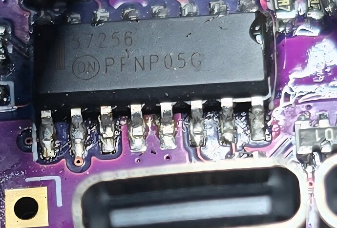

I decided to have a looksey at the board myself, I mean hell I do microsoldering as a part of my living right now! AND WHAT DO YOU FUCKIN KNOW…..
DO YOU SEE IT YET??
How bout now :grinning_cat_with_smiling_eyes:?

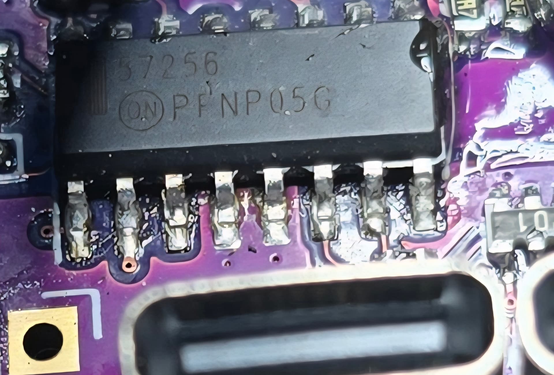

The right most gate driver for that MOSFET channel has soldering joints that are worse than Apple’s mux chips on early 2010s MacBook pros.
I COULD WIGGLE PINS 7 AND 8 FROM THE LEFT WITH TWEEZERS ARE YOU FUCKING KIDDING ME.
Please excuse my language…
For some that may be loosely wondering what a gate driver is, basically a power amplifier ic to turn off and on the MOSFET’s really quickly. Without this they would not be able to turn on as quick or not at all and that leads to very very bad performance.
Sound familiar??

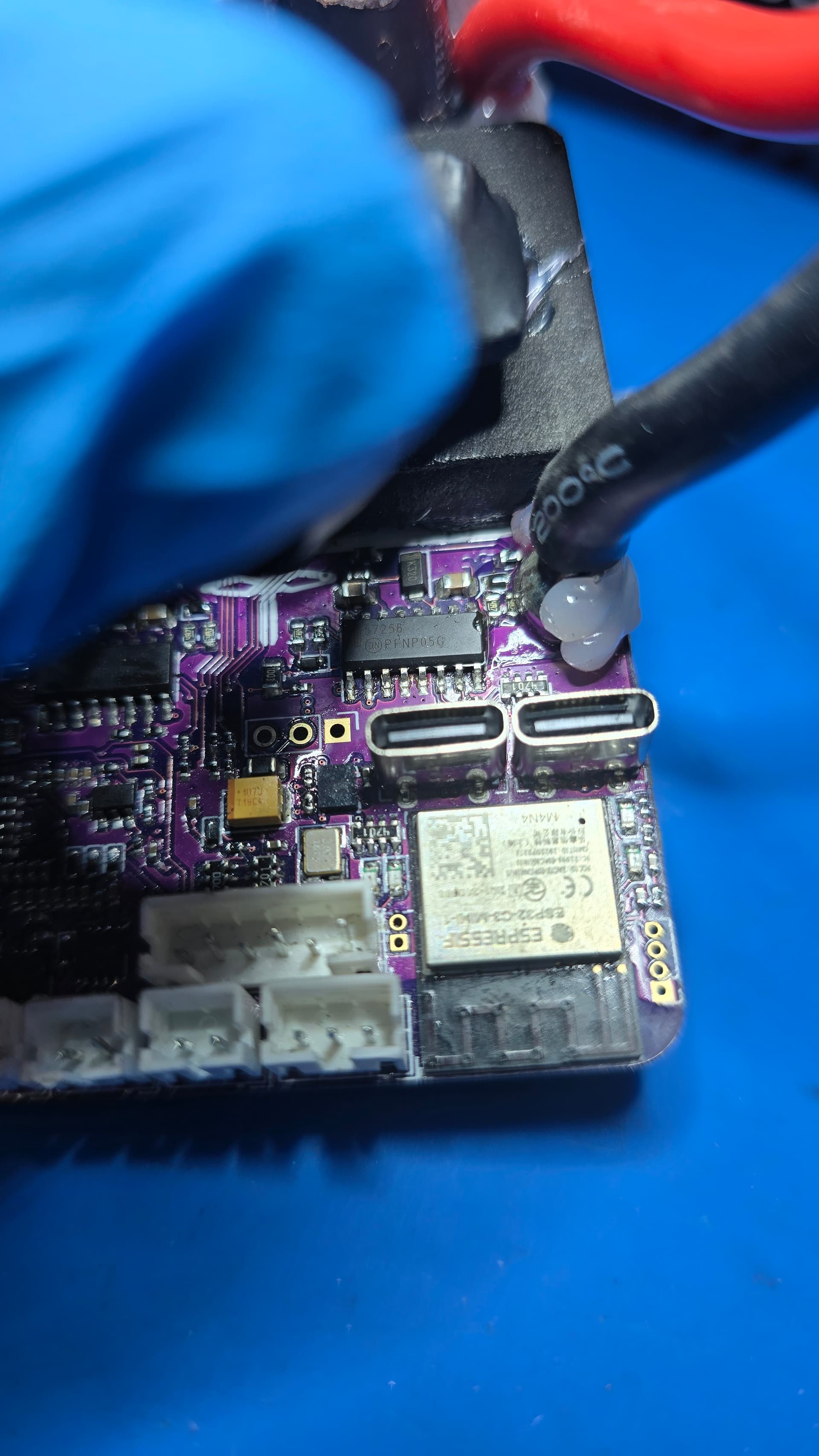

Sooooo after retouching all of these joints with my iron and inspecting all the other drivers too I saw similar cold joints that I also touched up. Inspected the other esc that wasn’t misbehaving, all of those joints were in tact (not airborne) but still looked pretty bad so I did those too.

Putting it all back together and got to try it at Saturday I2S San Diego and all was well!!

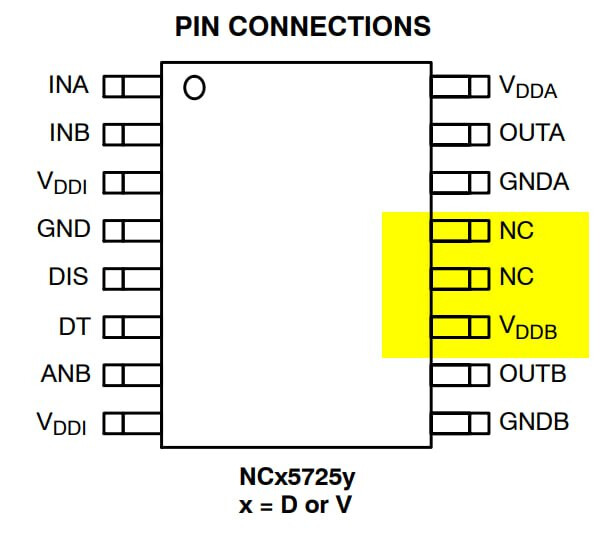

Looking at the gate driver datasheet, one of those poorly soldered pins is the power input for one of the phase gate drivers. yikes! lucky.
Very lucky indeed :smiling_face_with_tear: glad it was fixable in the end :partying_face:
Ahhhh that makes sense thank you!
