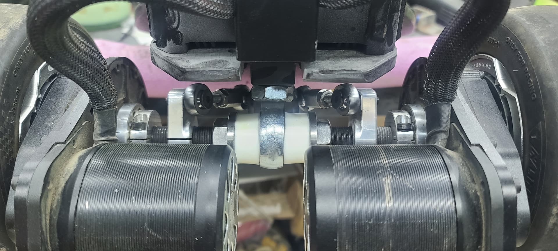

Can also position the rod mounts wider…
Would you mind sharing those puck files? I really like that design and would love to add it to The puck case database
Found that when I tried this the rod ends would end up hitting the baseplate (the MLR Logo side) at max lean, so I just have it set to as wide as I could without them hitting there.

hmm usually there’s at least one black split washer between there to help with that

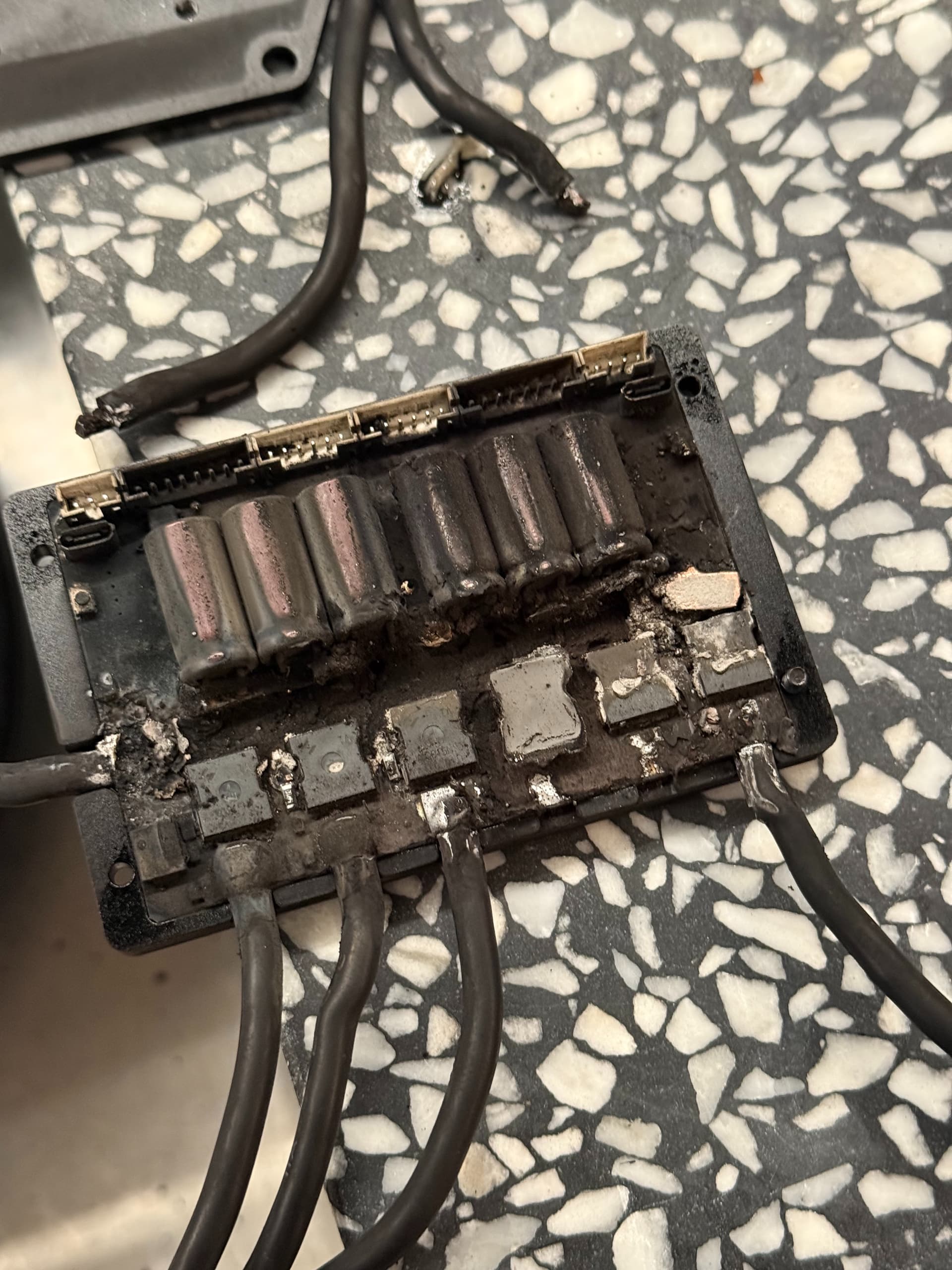

The month started off not great with another blown front D100s (same side, and with two different sets of 6355s) so I took the chance and bought two Onsra 16s ~90a escs to try out.

In the beginning, the 55s were throwing overcurrent faults when getting past 60% throttle at semi-low speeds (10-20kph) so I ended up turning the front ESCs down to about 40% (which I wanted to anyway) and this solved the issue. Though it unearthed the complete lack of torque that this esc was delivering, I’ve accelerated faster on the 2WD Velar than this :sweat_smile:
Seeing as there isn’t enough time to get a new d100s before finals, I guess I’ll have to ride even smoother than usual and rely less on power. The idea of running 4x Hobbywing Max 6s has crossed my mind as I’m not a fan of how volatile VESCs can be, and until the ESC from the Agent will be able to support 16s (though they run 110kv stock so who knows if it’ll even work), I guess I’ll be back on the d100s.

Any idea what’s causing the d100’s to pop? Were you on 6.02?

Nope, on the stock 5.02? firmware. First time it popped was on the bench under braking, this time I was just cruising (25kph) and went over a fairly large crack in the road and it popped. Both times it popped the right side fets off so maybe phase filtering or smthin? (I’ve got no clue)

After a D100s popped in Nothing Fancy, they updated the store page with these suggestions
Recommended operating voltage <20S (84V)
Recommended motor KV <130
Any chance you were pushing these? (Sorry if I missed this info higher up in the thread)
