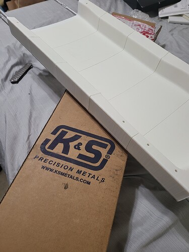

Picture of the mold so far, no post processing yet.

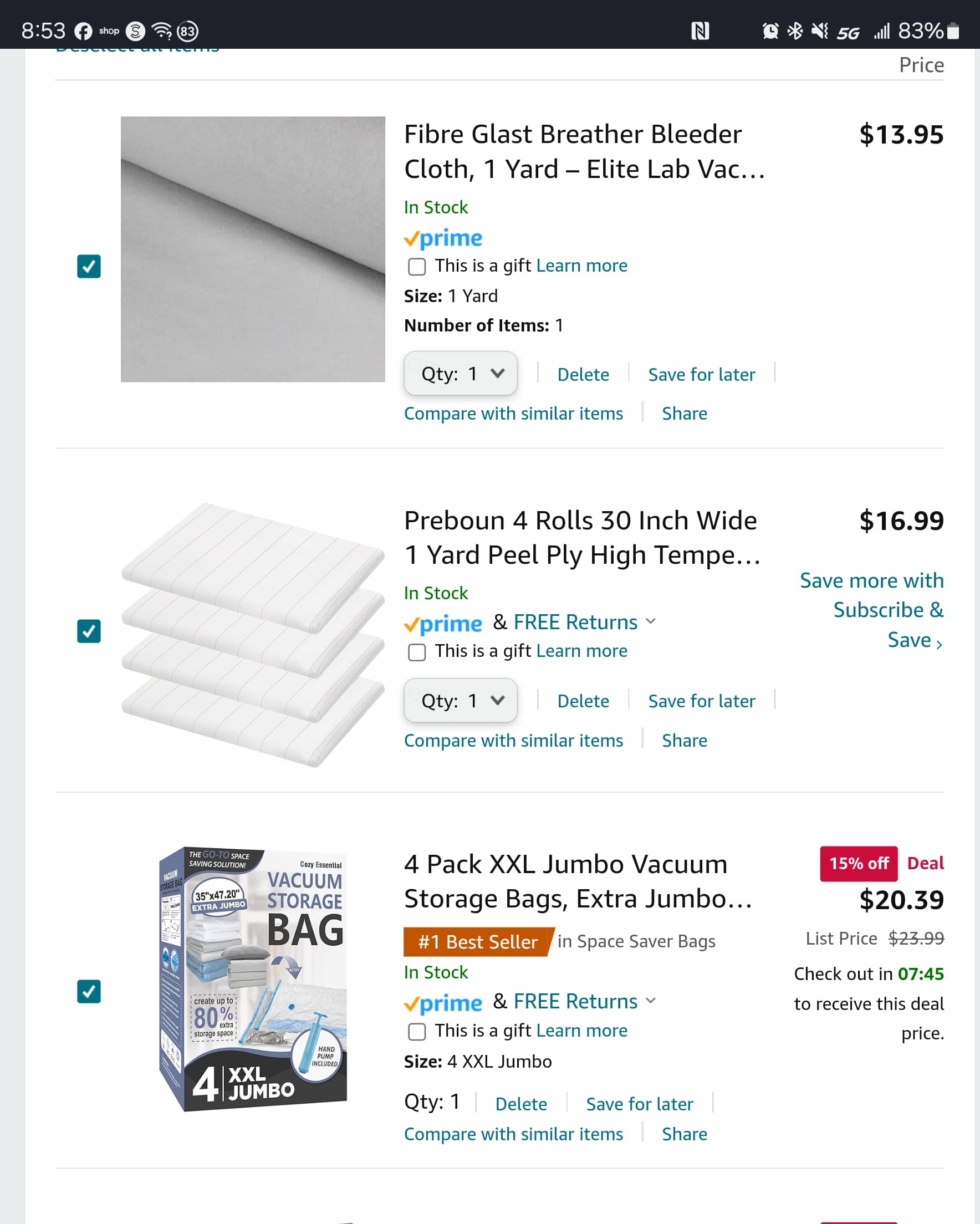

Alright so i managed to find these for my breather, peel ply, and a vacuum bag. Would that work out? Should i be concerned about the thickness of the vacuum bag not getting into the crevices of my negative mold?
Thay all lopks good!
So some vacuum films have a certain amount of stretch to them but ot would be foolish to rely on that to get all the way into your corners. You need to ensure that as you are pullimg the vac, you are also pushing the bag imto all of the corners. It doesn’t matter if the bag ends up all bumched up or whatever, just as long as its not stretched.

Any recommendations on a coating to smooth the mold out? Im thinking sanding the plastic, laying bondo and then lots of sanding
You can use as much/little silica as you want to reach desired consistency
