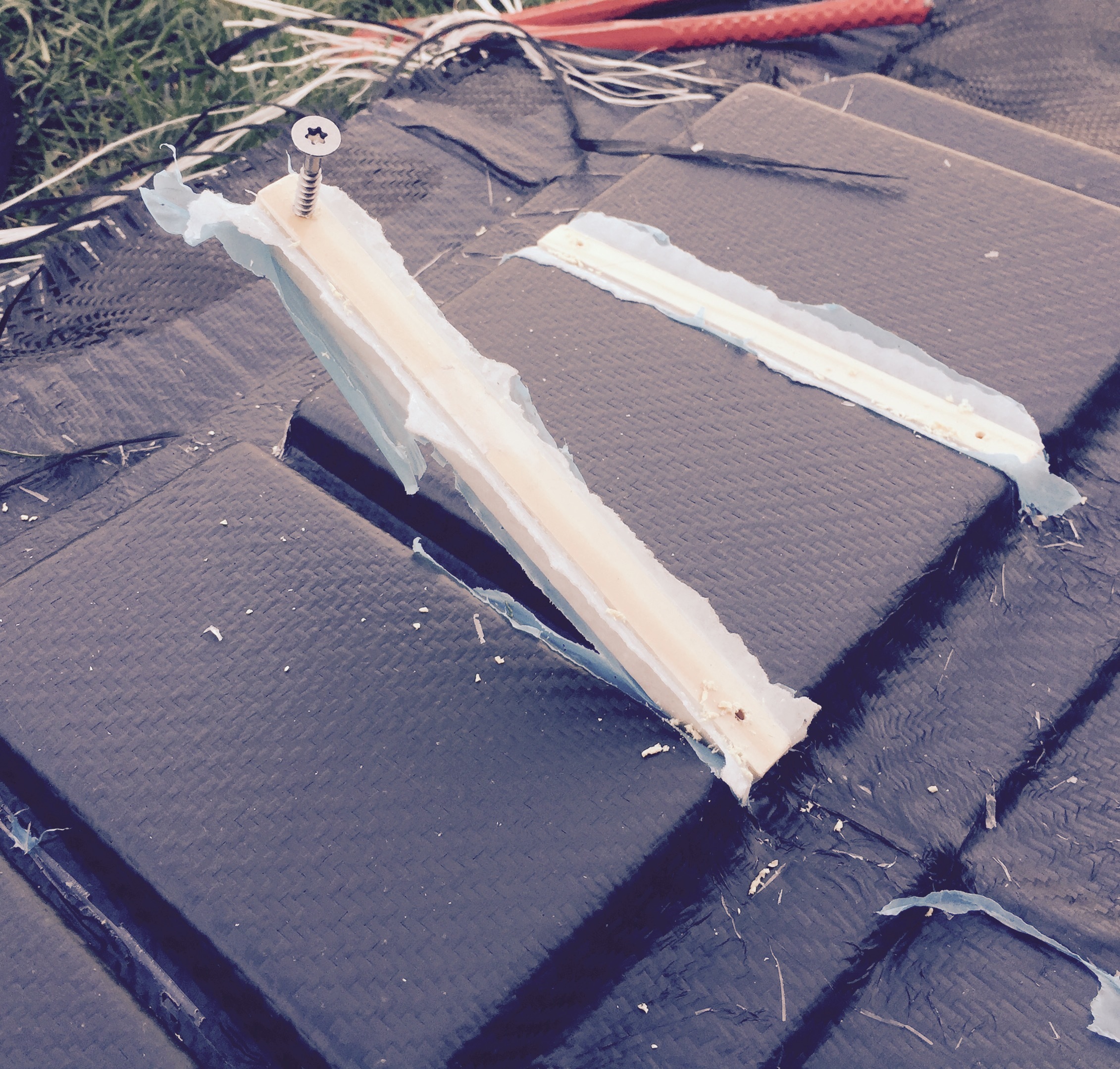

Here are some pictures from Whitepony on the other forum of what I’ll do to form the segments (I’m too lazy to explain it):
As you can see, those spacers help push down the layup between the segments and also using a positive mold like that can still have good results. Edit: The spacers are not contacting the layup but are actually on the release film layer on top of the layup.

Didn’t say it is impossible bro, but it will be difficult.

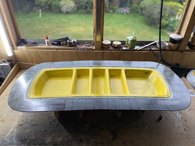

Well, it’s not made yet but it’s coming along and it has proven to be a bit of a challenge so far. Segmented enclosure for a Hummie.
Mould seems ok. A couple of small repairs required but will be ok. Has to be, cos the plug is now smashed :joy:
Duuuuuuuuude
Yeah it’s actually come out really well. One area is a little bit lumpy and needs slight filling but the rest is pretty mint.
Did my second epoxy layer in a greeninsh colour to see where any thin bits were. A bit of that is visible but surface isn’t really affected.
Buck was way too weak to be removed in one piece. Just disintegrated. :joy:
Used Spheretex SBC filler to fill the gaps between segments and it was awesome. Like a sponge mat for epoxy that was great for bulking out those areas quickly. Haven’t made a layup this thick before, that heavy roving seems super strong.
It’s wickedly strong :ok_hand:
