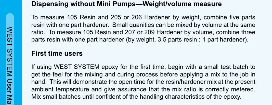

Follow supplier instructions.
Measuring by weight isn’t a problem for many. It is a good weigh (
) to get accurate quantities.
Digital scale IS a good suggestion.

Graduations on mixing cups are often wrong/inaccurate and imprecise, making mixing by volume, especially low quantity batches, much more error prone.
Errors on ratio, or insufficient mixing od parts a and b, with epoxy, can lead to tool throwing curse fests.

this is bad advice
I guess we will disagree.
I have had much better results mixing 100:45 by weight (or :43, or :44) to nearest 0.1 or 0.01of a gram, than I have by mixing 2:1 by volume.
My biggest regret was not getting a digital scale sooner, and I am never, ever, going back to mixing by volume unless it is a travel scenario when traveling with a digital scale and milled fiberglass powder and cab o sil, might land me in jail.

Weight is easier, use a single cheap throwaway cup. Beats cleaning or replacing graduated ones.
I keep using the same cup, as long as the bottom is flat, and sides non lumpy, so the mixing stick can scrape them clean.
I used to hate to have to pour 10ml of resin, worrying about meniscus into a totally level mixing cup, then precisely add 5ml of hardener, hoping to hit the dead center of graduation, accounting for meniscus of different viscosity hardener.
Now Ill zero scale with cup atop, pour 11.44 grams, multiply by 0.45, hit tare button, and pour 5.15 grams of hardener, and have it come out perfect everytime in a fraction of the time.
Epoxy’s adhesion and other properties such as tensile strength are affected by ratio. Its not like polyester resin where the catalyst only influences the rate of cure.
3% too much or too little hardener might only reduce bond strength and tensile strength by 5%, and it will seem harden to sand OK., perhaps normally.
Been there, only later to find it did not bond well or broke, and when going to repair it, sanding through different layers, to find it obvious, by sight, and sound, that what I convinced myself was just fine a year or 5 earlier, was not.

When I first started weighing epoxy, I was pouring resin and hardener by volume into my preferred mixing cups atop the scale, just to see.
Whether the meniscus was touching top or bottom of graduation made a huge difference.
Never again by volume.
Not for me.
With JB weld, squeezing equal diameter and height blobs is a fantasy, the digital scale does not lie.
Ill never mix by volume again, if I can help it.
