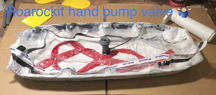

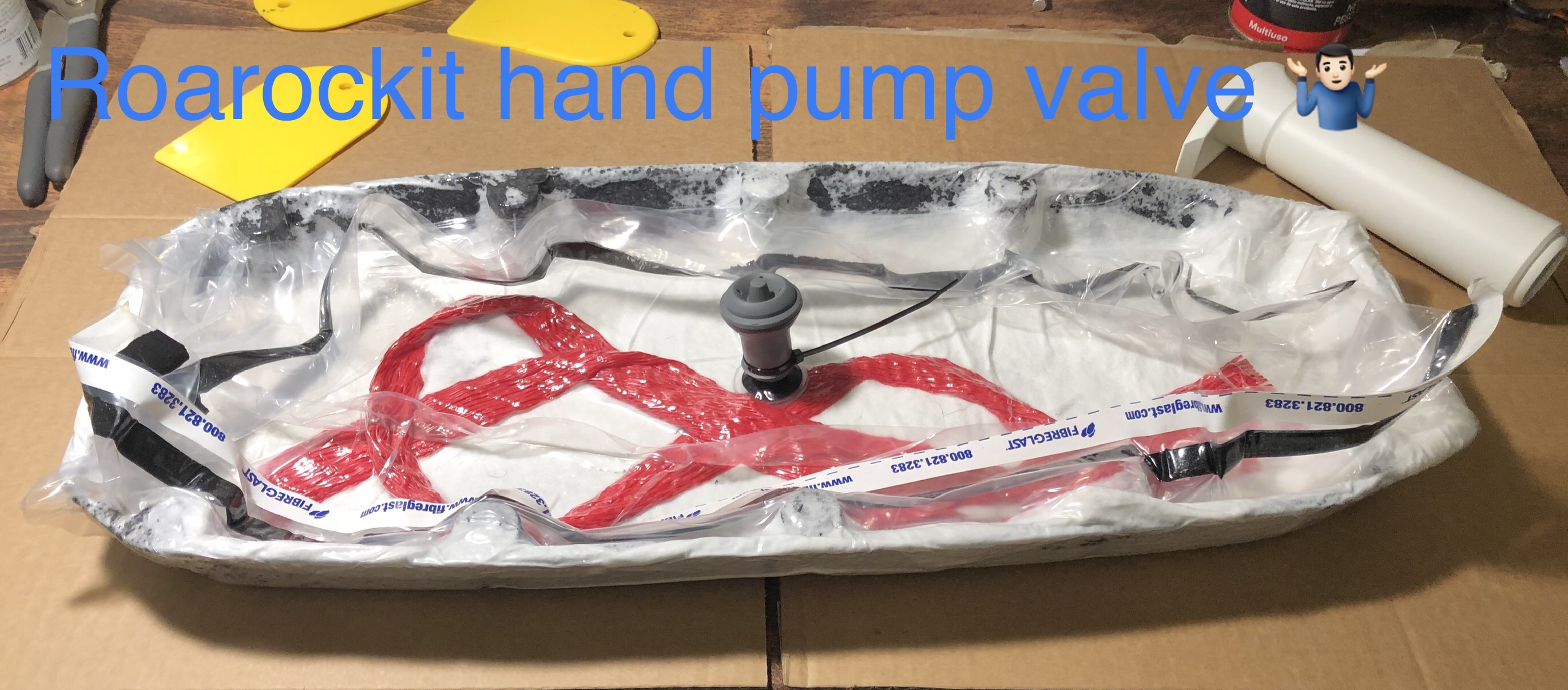

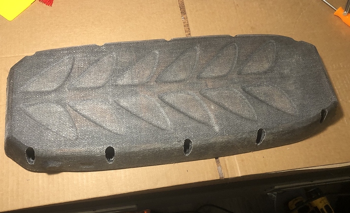

The roarockit kit is essentially a wine bottling vac pump that’s up charged. I’m gonna do a write up later this week.

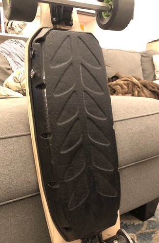

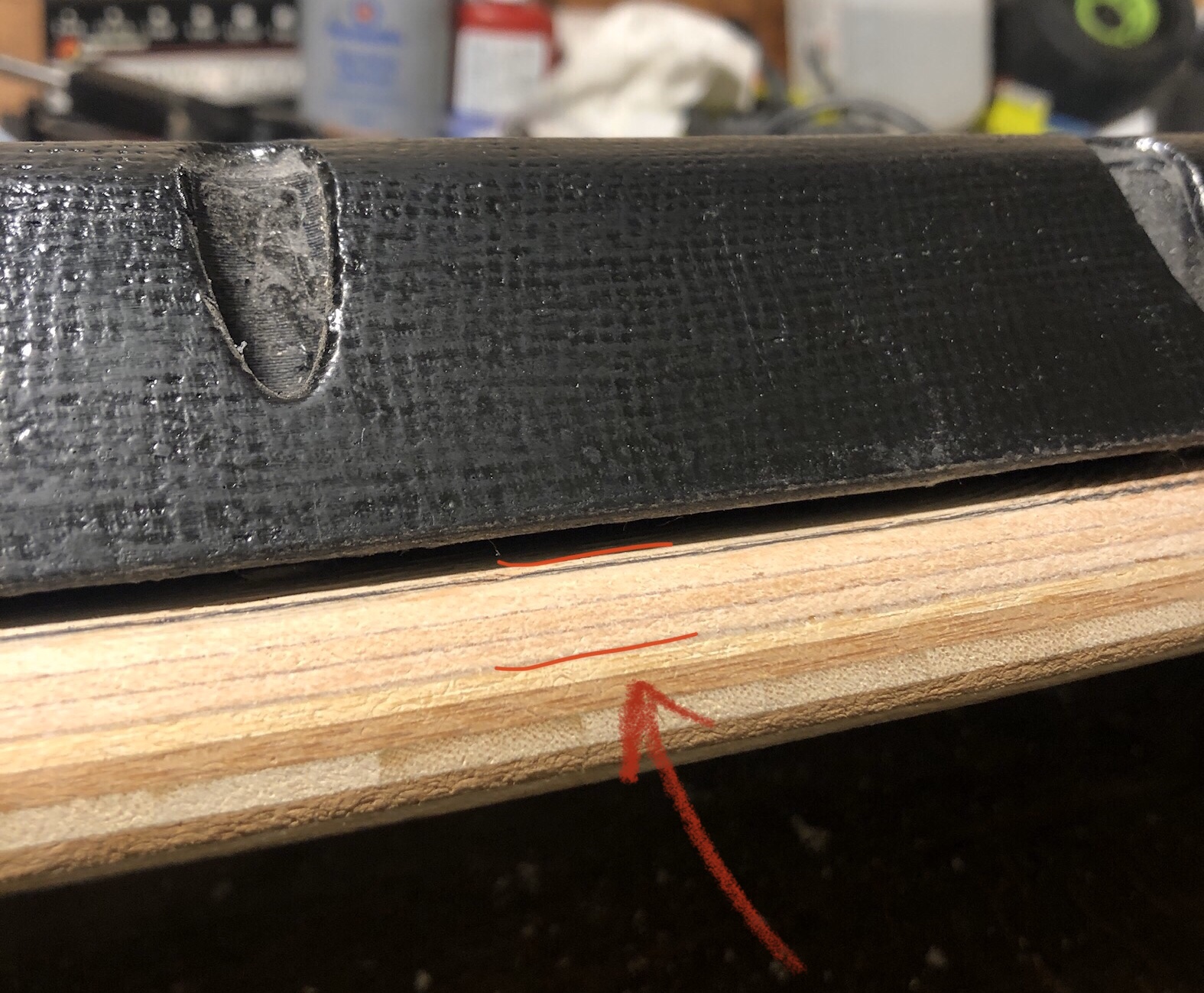

I used the roarockit kit to add 3 layers of maple and FG to a 5 ply sector nine deck to stiffen it and provide thickness for routing a battery area and threaded inserts.
I used the same pump and valve in a standard FG vacuum bag to do the layup on my enclosure. Worked perfectly. This was a test for a future project, and i used some very light roving cloth i had. So there’s a lot of texture. Used peel ply as well. Essentially was able to vac bag a FG part without a loud pump in a 1 BR apartment with $20 in supplies. This was a skin over a 3D printed enclosure. Details came out perfect
Roarockits bag kit is great for adding strength to existing boards or potentially creating from scratch. But if it’s enclosures alone, getting proper vac bag from a FG business and using a wine pump will get you better results for 1/4 the price.
Recent roarockit maple x3 FGX3 (5mm addition). West sys epoxy
Those look awesome!
Do you know anywhere to get the red mesh stuff besides the kits?
I’m trying to create my own version to save some shekels.
That’s just plastic netting. The breather cloth above the peel ply does the same thing. Just helps air travel to the pump.
It’s not the same as a vac pump. We’re essentially doing a static pull and leaving it. I left a spot or two that didn’t wet out perfect. But in general, hand layup and wet out. Then the vac bag will pull the excess through the peel ply and absorb by the breather cloth.

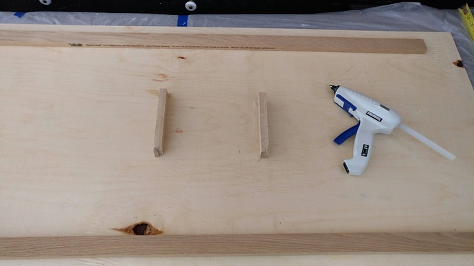

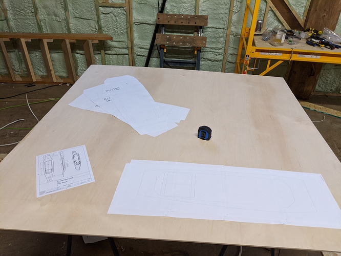

I got myself some sheets of 1/4" birch that I’m going to use for the deck…
Starting on the cutting today so I’ll start a build log soonish :stuck_out_tongue:
