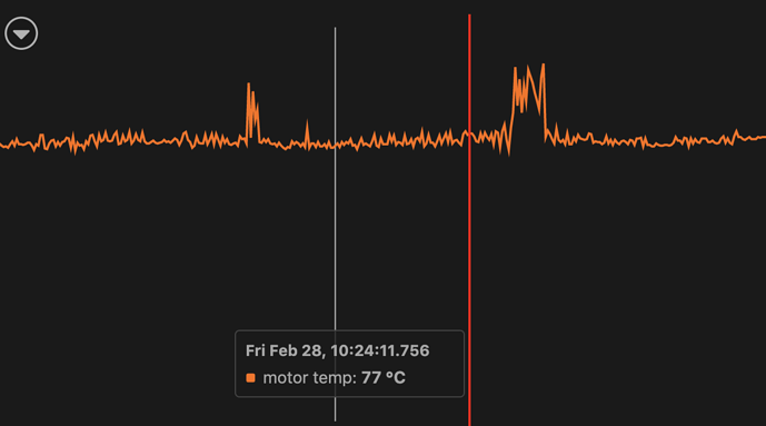

Illustrating the motor temp spikes. It very clearly jumps from 77c to 85c very suddenly in this example.
Could it be a bad temp sensor? Would explain the temp jumps, and the temp jumps would explain the fault. If it spikes quickly to 150 or something, then returns to the proper value, the ESC will throw a fault because of that value.
Just a possibility

so sorry @fessyfoo you’re going through this. i wonder whether there is any possibility that this is a firmware dependent error? unlikely but would you consider downgrading to the last Ack release?
That’s one of the reasons I’m hoping metr can record motor temps distinctly for both motors. it shows them in realtime. but records doesn’t keep the secondary ATM.
I want to see if the other motor is getting this kinda noise and jumps.
I can probably add swapping this motor out with another. ( to swap the sensors ) to my list of things to try. it is only happening on the one side.
