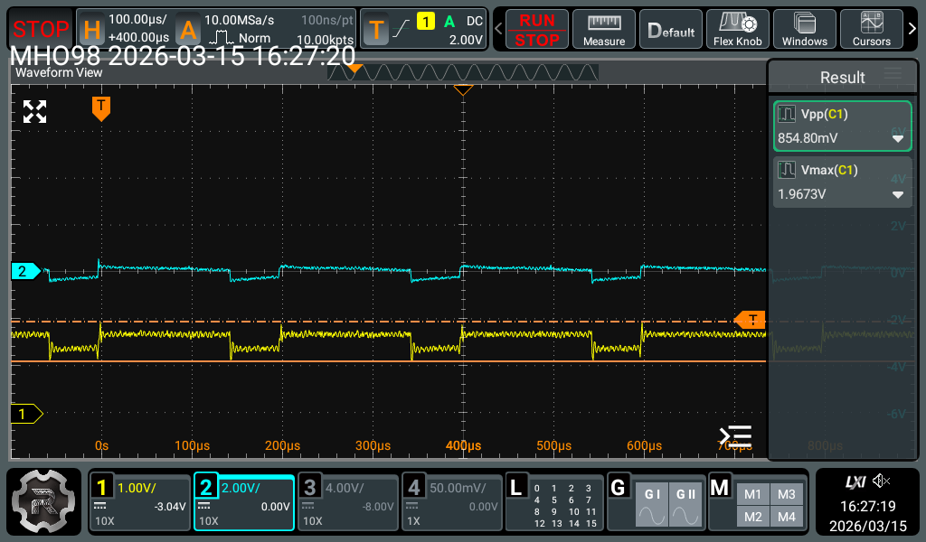

I
I captured oscilloscope screenshots of the phase signals (MOSFET gates) as Ch2 cyan color in the picture and the current sense amplifier output as Ch1 yellow color in the picture around the time FAULT_CODE_ABS_OVER_CURRENT occurs.
I would like to post them here and ask for advice on how to interpret them.
The scope was used in single trigger mode, with the trigger level adjusted so it would capture only near the fault event. If the trigger level is set any higher, it does not trigger. If it is set any lower, it triggers before the fault. Based on that, I believe these screenshots were captured very close to the error event.
Any thoughts on how to interpret these waveforms would be appreciate.
