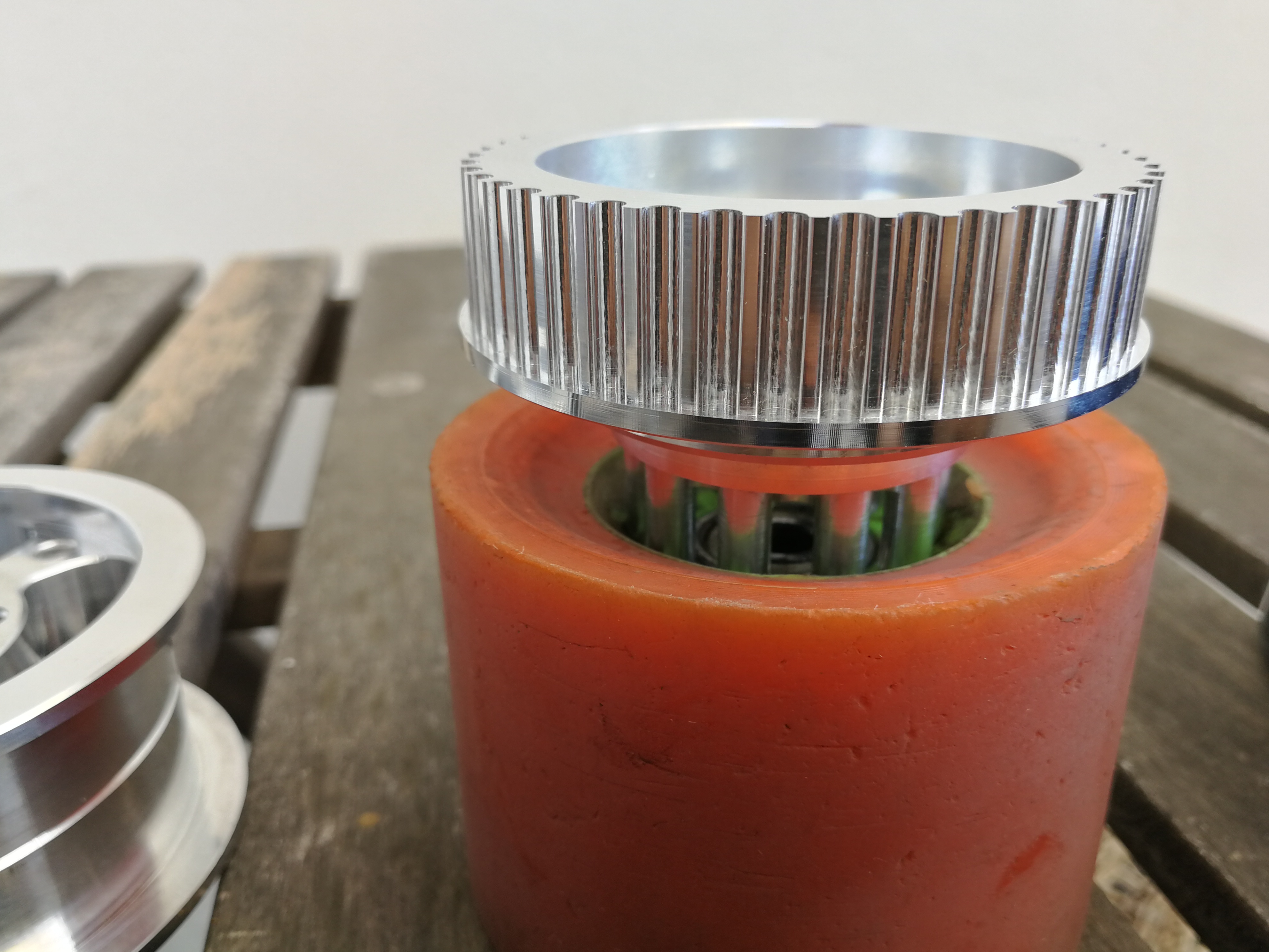

Info : ( Kegel reversed ) pins are 5.6mm⌀ x 19.5mm
But there is no pin dimensions info for the Kegel (non-reversed) pulleys. Can you add to website?
I’m guessing the difference is pin length, 19.1mm vs 19.5mm? Do the Kegel reverse pulleys fit both normal and reversed cores?
I’ve added information to the shop, the length doesn’t change, normal kegel will do, unless you use reverse core wheels.
Ah thanks, that was fast. I have a bunch of kegel wheels, many with flipped cores, and I’m stockpiling parts for future builds (mix and match). The reverse should be okay, just a very tight fit, right?
No, I don’t think the reverse would be ok.
Today I received the normal Kegel version and is very tight with the Orangtang Kegels 80mm (I would need to use a hammer to fit the pulleys on to the wheels), not compatible at all with my Janux Hubs and perfect fit with the reverse Torqueboards 110 core.

That’s fine for the plastic Kegel core but won’t work with the Janux Hubs. Any idea on how to fit the 3d servisas into the Janux Hubs?
