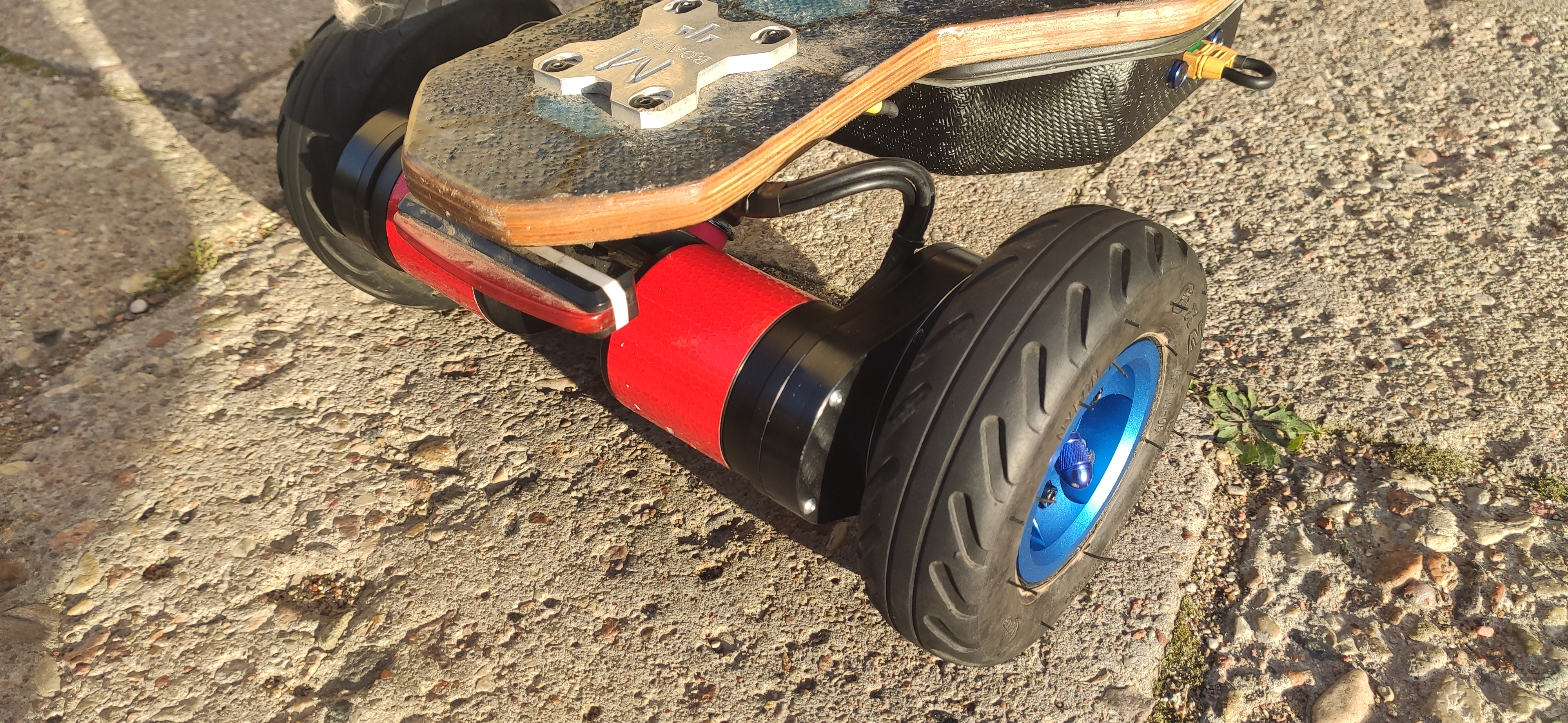

Fully assembled with Bergmeister wheels :grinning:

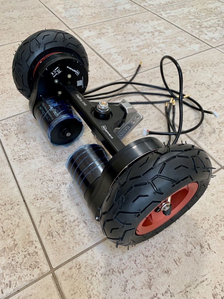

I currently have a 39" Moonshine deck with the Raptor hubs and a 10s4p but I feel it too big and heavy. It’s freaking powerfull but after couple of months riding it I feel I need something smaller, with a more comfortable ride and more portable.
So, I’m planning to use these Mini Eco AT geardrive plus Bergmeisters on my current 39" deck, with some very wide trucks (I was looking the Trampa 12FIFTIES which I guess are the wider ones with a kind of Caliber profile), then shorten the deck as much as possible (I will also probably cut down on battery to a 10s2p, as I don’t need lot of range, just to cruise around sometimes).
I also asked @Trampa on the other forum if their trucks profile is similar to Calibers or TB218 (which I see that has been used to mount this geardrive on @3DServisas pics) to confirm if I can use that combination somewhow, even if I have to mill some mm on the trucks.
Am I crazy? :smiley:

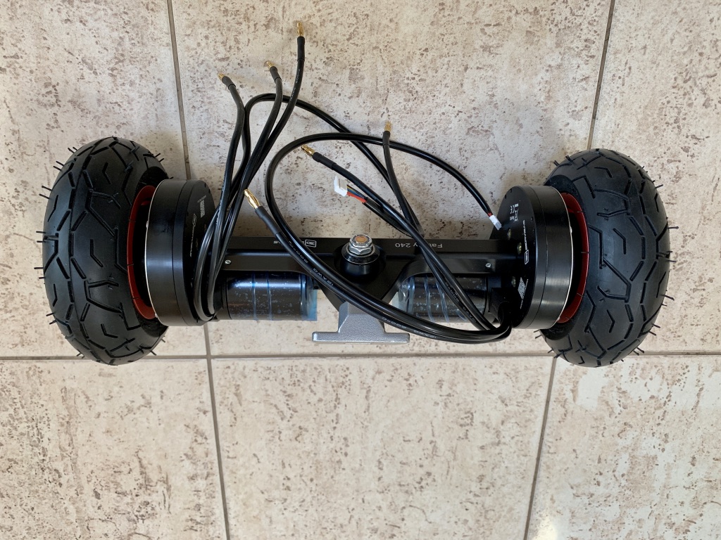

I will get a set for sure, I just need to find the widest truck available and then I will hit the button :slight_smile:
You can buy our hanger it works too 230 and 240 available :wink:
Sure @Kug3lis, but I need more than 300mm wide (Trampa trucks are 317mm/12,5" wide) to be able to fit the geardrive in my current deck.
This way I only have to “shorten” the deck and I avoid to make it “narrower”.
317mm is with axles 230/240 is only hanger + 100 the axles
Shit man, then you can confirm both are same total width?
You all made me crazy with those measures in inches… :exploding_head::exploding_head::exploding_head:
What do you mean?
FB230 is 230mm hanger width (9.05") with axles (total width) is 330mm (12.99")
FB240 is 240mm hanger width (9.44") with axles (total width) is 340mm (13.38")
Perfect, will send you a PM with my order :slight_smile:
Still proud owner of these bad boys. :smiley:
I’ve replaced the wheels to those blue bergmeisters though. :weary:

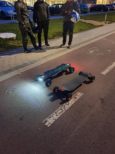

My friend is a proud owner of the original FatBoy longboard by 3DServisas, upgraded with the Eco drives too. :slight_smile:
Two quite powerful boards with gears? Double trouble.
A small fragment of tonight’s ride.
Taken by something equivalent of a potato, a 13€ “action cam”. :joy:
