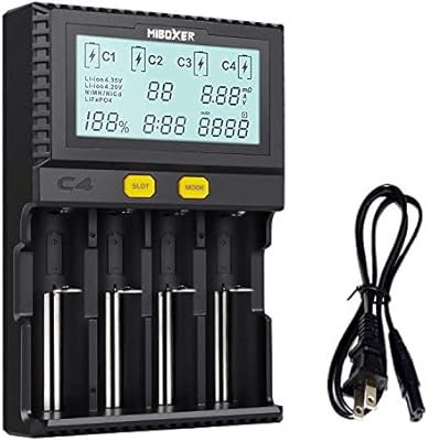

Doing these 1 at a time is taking forever, debating on buying a charger that can do 4.2V Any good options out there (prefer amazon). Is the one below ok? I was hoping to find something that can discharge so all the cells will be discharged when I’m building the 10S4P pack.

Ok ok you guys are right. I bought a charger that is designed to charge 18650’s and I tested 1 more cell and got 3069mAh at 4.2V. Discharged and charged on my original charger and only got 2543mAh. So somethings weird is going on with my 106B+ charger. Crisis averted and onto the build, wootwoot!
