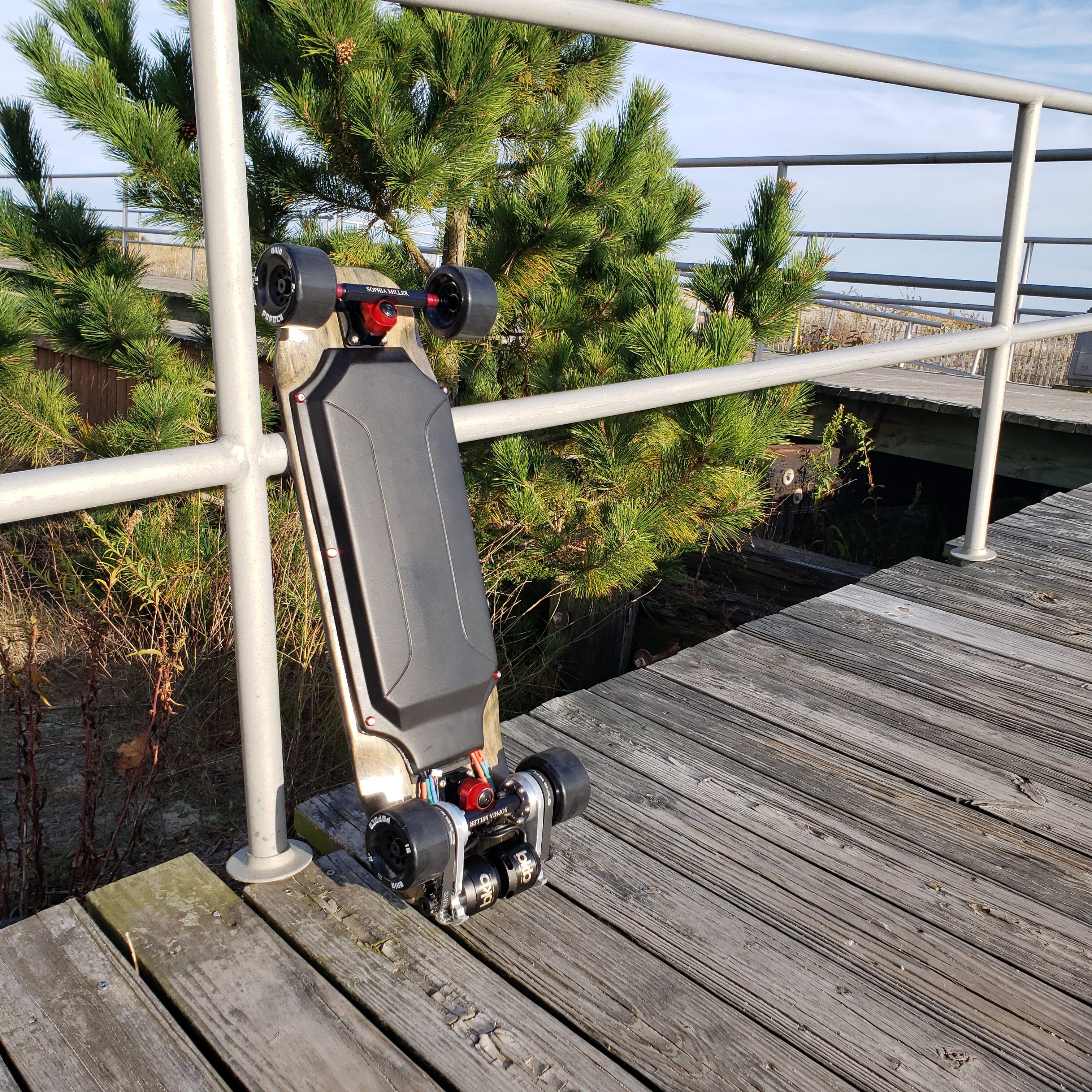

In the time of the gods when men feared the night Fafnir, son of Hridmar slew his father for a golden hoard and transformed himself into a dragon to guard it.
Not a build log, just some specs and pics because I’m lazy.
Specs:
Deck: BKB Tayto that’s been Senderized by @Sender
Enclosure: @eBoosted spud single stack
Trucks: Surf Rodz TKP with 127mm hangers
Wheels: Popocas
Drivetrain: Dual BKB 6355 190KV, BKB Modular pullies, 13:36 ratio.
Mounting hardware: @moon universal hanger mount, custom motor mounts
Battery: 10S3P 30Q with generic amazon BMS (because space) and Vedder antispark
ESC: Dual FocBox 1.7
Telemetry: Old metr module
This is actually my daughter’s board.
Thanks for reading!

Can I be your daughter? Bice build man looks dope as hell!

Those motor mounts, incredible. The whole build is awesome. Good job.

Those motor mounts are the best I’ve ever seen… well done!
