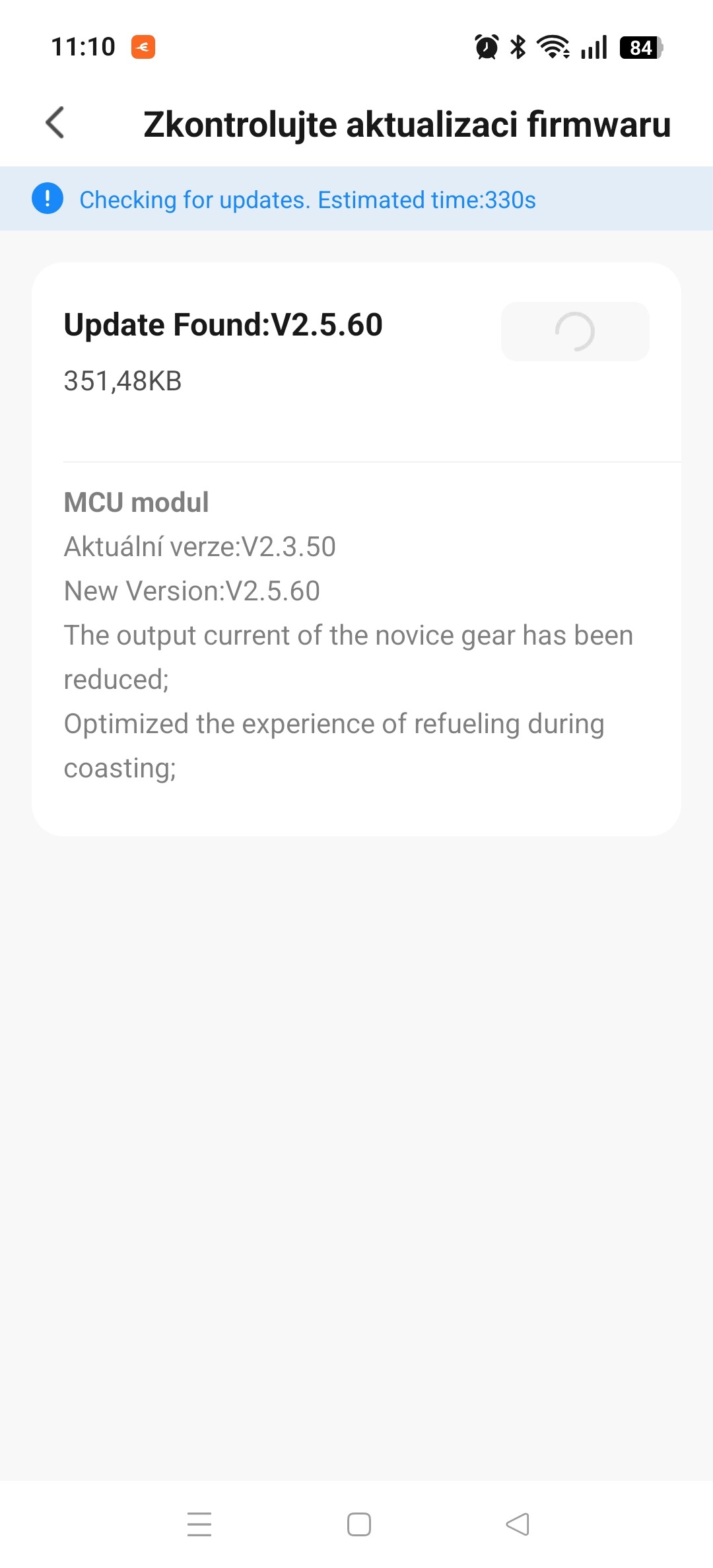

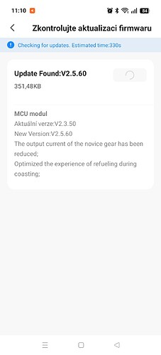

So I got info from @Exwayboard that I don’t have the newest firmware, so I am updating the remote and board just now.
Considering the mentioned bug fixes I hope it sorts my problem.

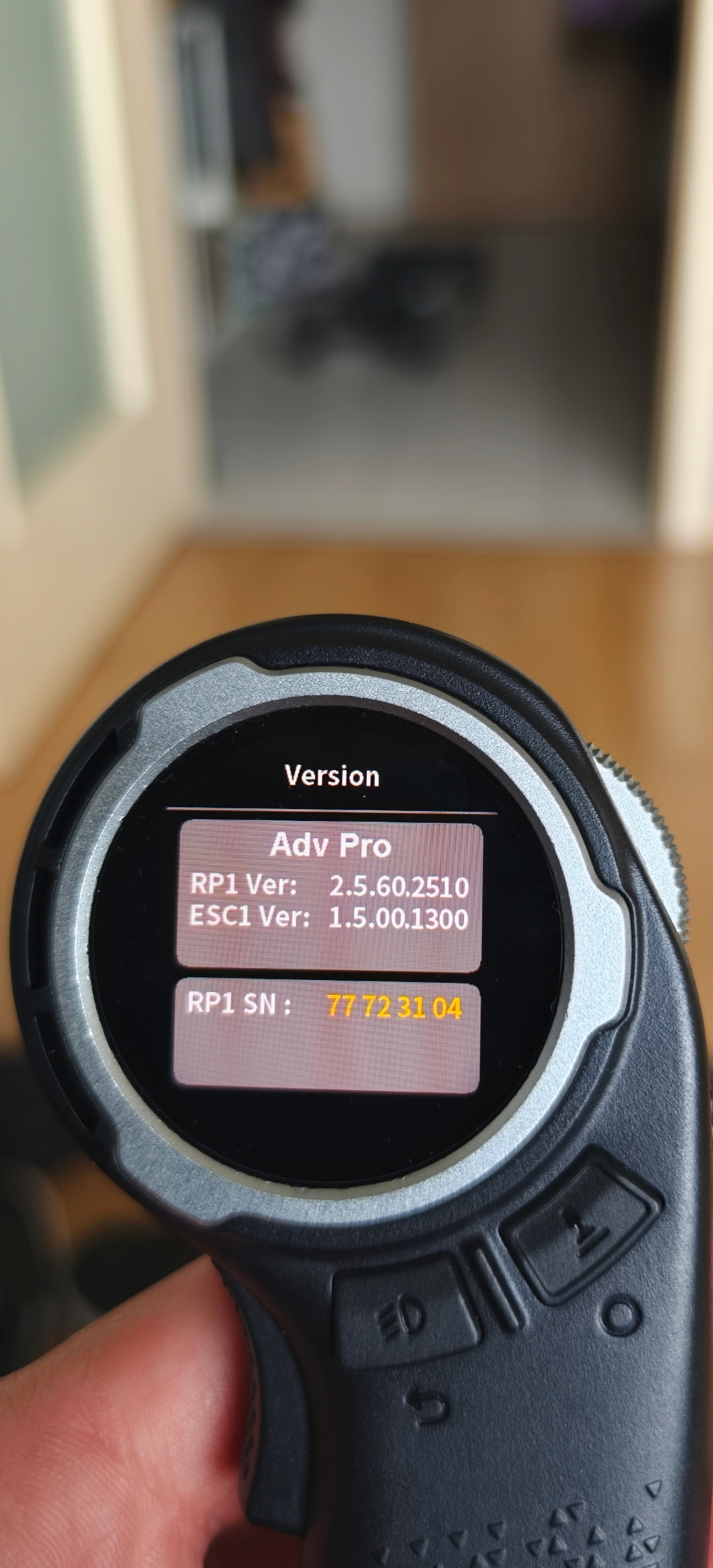

Ok, so it’s settled, new firmware fixed all the “jerkiness” while trying to maintain steady speed.

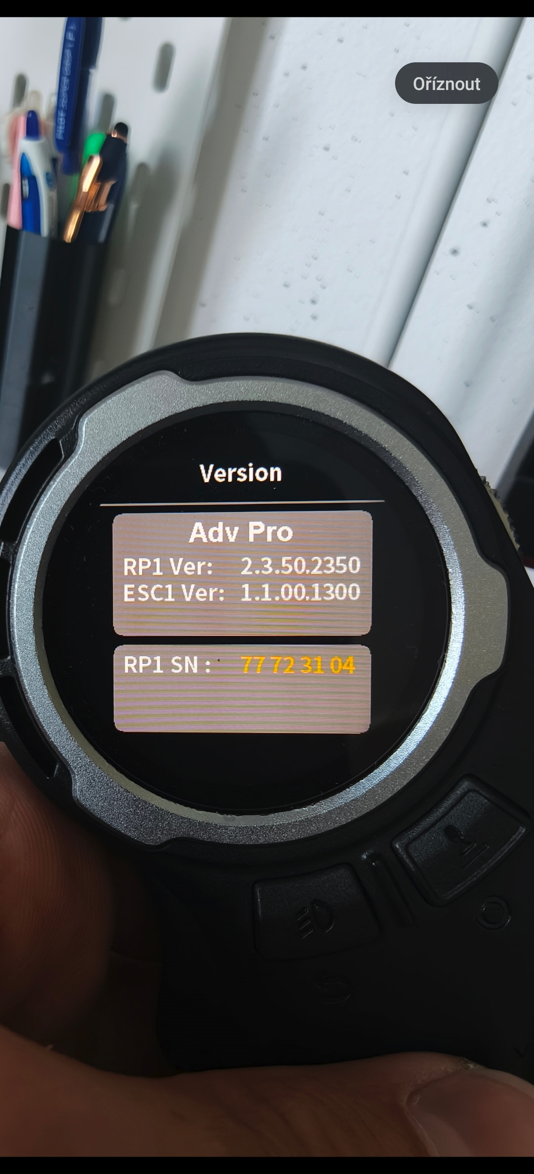

I had this version
And now It works fine with this version:
