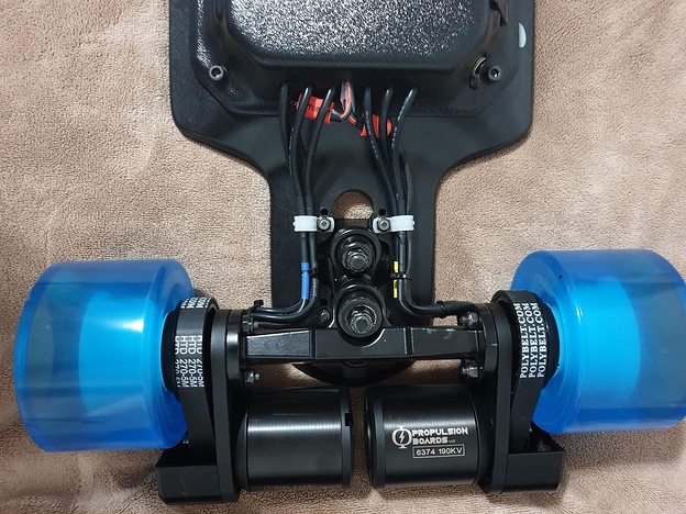

So this is rather a continuation of a previous post of my eSk8 build. I posted the following in a build log posted in the forum a few weeks ago:
So today, I am out to test these pulleys and see how well built they are… But before I begin, I need to address a burning issue first - wheel colors. Ever since I posted the build, there was a user by the name of @RedBaron (Not sure if you like the frozen pizza company, or you admire one of the best pilots of World War I based on your username, LOL) who wrote the following:
“Hate the blue color wheels” huh??? Well, I was very curious. I got my sister an eSk8 board, and I got her the black wheels, and all of that sparked the question, “What if my wheels weren’t blue? What if they were black?”
RedBaron sucked me into getting a set of black wheels. My wheels are no longer blue, but they are black. HOLY BATMAN! They look nice! To be fair, I think that both wheel colors look nice. The blue has a fashion statement built into them. When riding during the day, and the sunlight hits it, it just glows. But on the other hand, the black wheels scream stealth. It kinda resembles a race car to me, but man, it really does look stealthy. The really cool thing about them is that under certain lighting conditions, they look like rubber slick tires. In either case, I really like both of them. Oh, the 72A is a touch softer. Squeezing the 74A and the 72A, there’s a difference. And maybe it’s all in my head, but 72A is smoother on the road for me too.

@RichardsGore Not sure if this helps, but I am not using Torqueboards belts. I am using the original belts that I got from the guys at Propulsion Boards (which of course they have to source it from somewhere… and that somewhere is printed on the belt as shown in the picture). And I would imagine the same for the Torqueboards belts - a quality belt is a quality belt. Assuming the specs of your belts are correct too…
The specs of the belt that I am using is a 270mm (circumference); 5mm pitch (distance between each tooth); and 15mm width.
