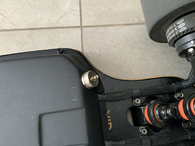

Be suuuuuuuper careful with that balance port bro. Next time consider using a female socket to avoid sparky booms
Lmao what’s what I was thinking too - or at least put a cap on it haha
I tried switching to BLDC and got a hardware does not support this error.
:sob: what does @jaykup s dog haver to do with this
Ha good point. Does that come with a female panel mount? I’ll have a look around for one.
FTFY. I was actually more concerned about ripping it off on a speed bump. It sticks out a bit.
You can definitely get female sockets,.
I used that exact connector on my madness build and got a rude surprise when i fumbled the metal cap into the port.
It was NOT a fun fix.

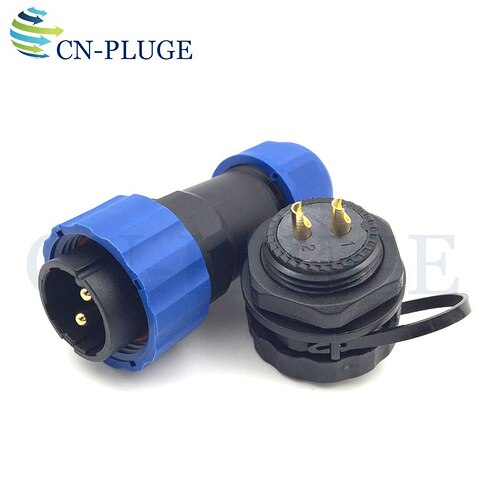

Yeah those are awesome but make sure you get them pre-wired. They are fucking expensive but super nice connectors.
I replaced mine with SP20
AU $4.00 | SP20 Waterproof Connector 2/3/4/5/6/7/8/9/10/12/14 pin Automotive Rear-nut Cable Connector Male Plug Female Socket IP68
Thanks. I had seen the SD28 but that was a bit girthy for my enclosure. 13mm mount hole. Those pins must be even more fun to solder than the GX20 :face_with_monocle:
Lol gx20 is child’s play compared to that little connector. I solder every day and i wouldn’t be able to do it :sweat_smile:
Would you use this as a charge port too? Just for faster charging. seems its rated for 25 amps
Don’t see any reason why not.
