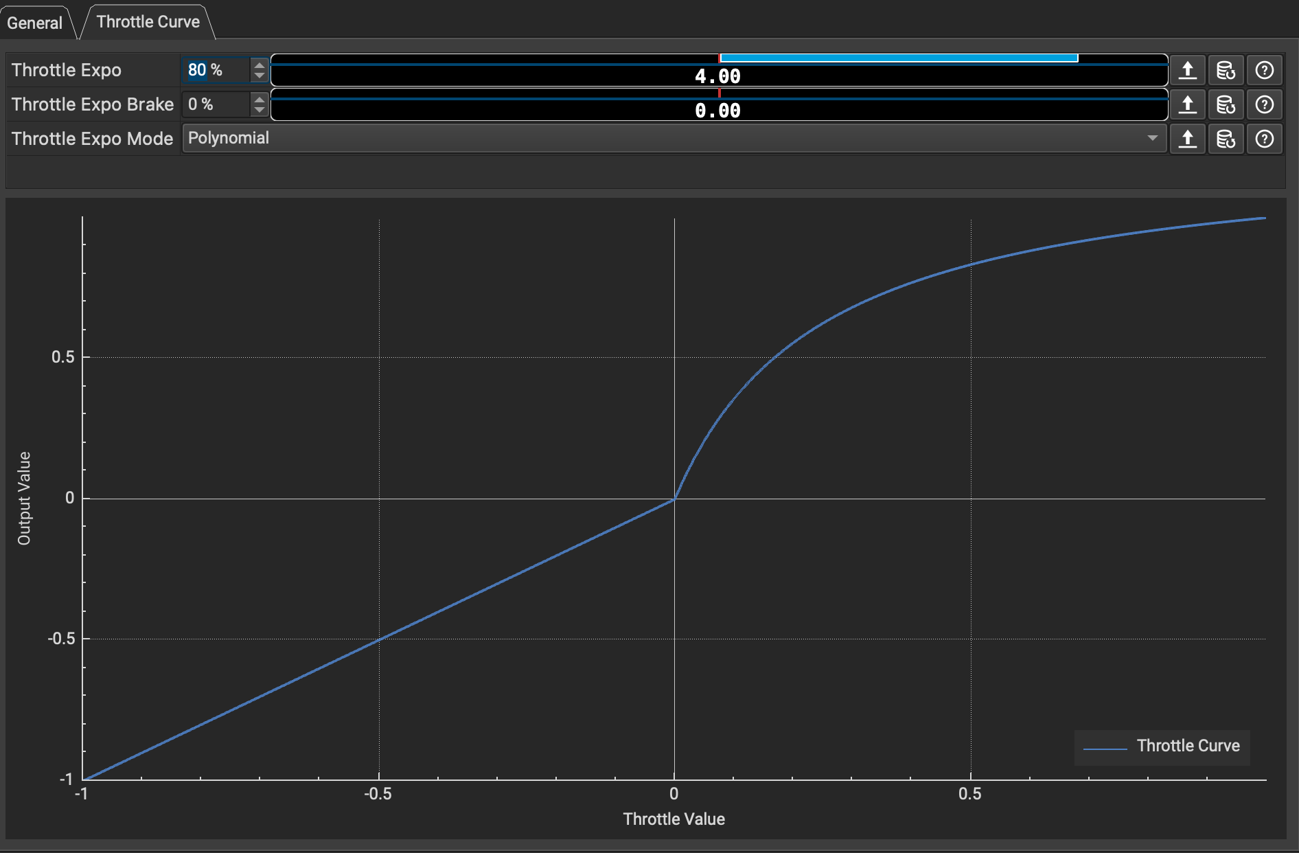

I usually put something like this:
I prefer moving the throttle rather then having huge acceleration/break from nudging it. Its abit of a bitch move but I like safety
