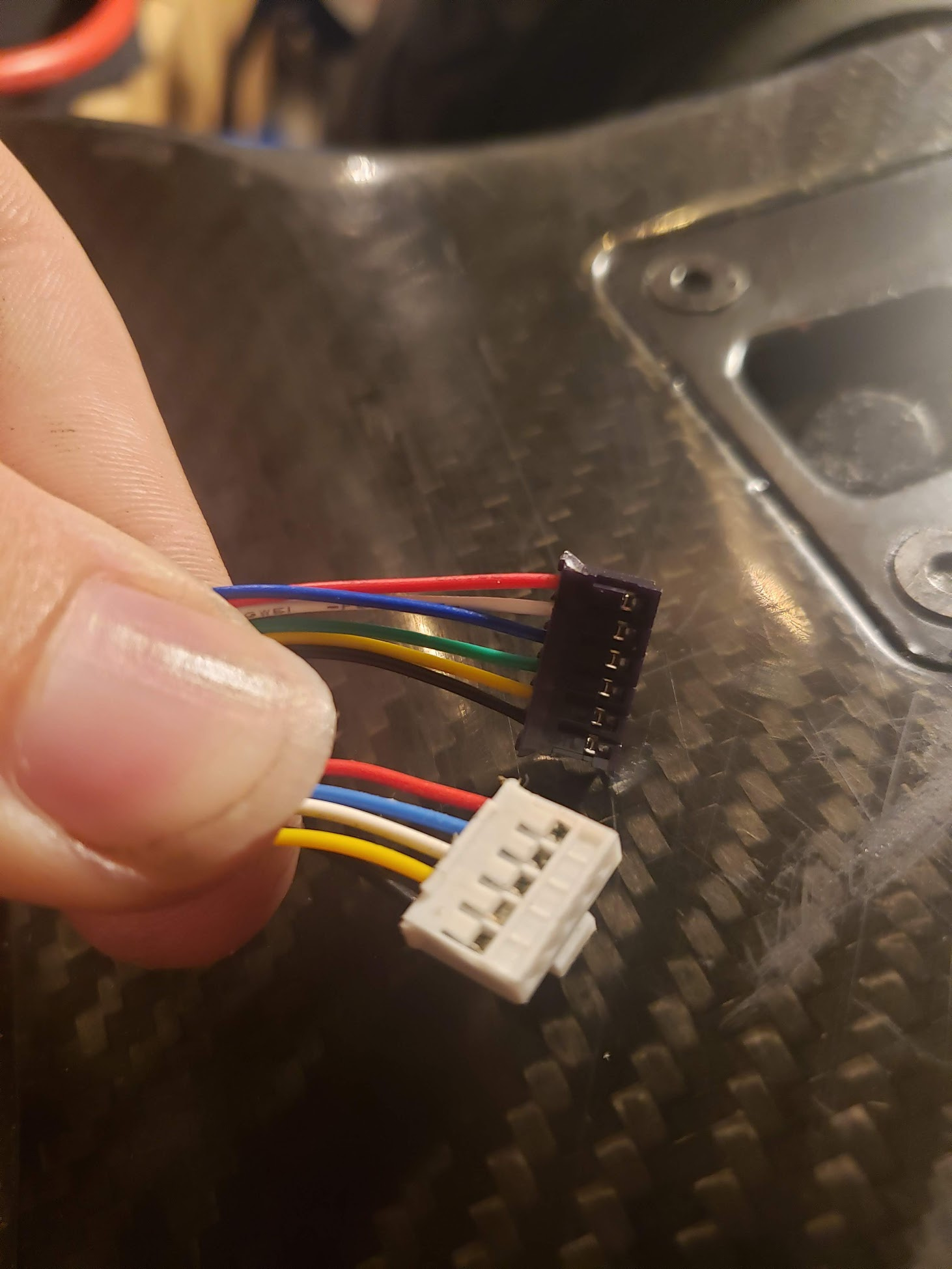

So I’ve got a stormcore 60d crammed into a evolve carbon. Works great sensorless, but I’ve got the right connectors now to add the sensors in so might as well. I matched up color to color annn it won’t run detection. I assume the colors are not standard.
So what’s the right pinout to make this adapter?
The correct layout is
+5V (red)
temp (missing)
Hall 1
Hall 2
Hall 3
ground (black)
Aren’t they Racestar motors?
Should be this.
No temp sensor on them, hence the missing wire.

Well that was easy. Order of the 3 hall sensors doesen’t seem to matter either.
So my pinout looks like
Red
N/C
Blue
White
Yellow
Black
Detection just completed first try no problem. I’ll do the same to the other side and get back to riding. Thanks everyone for the expert knowledge.
