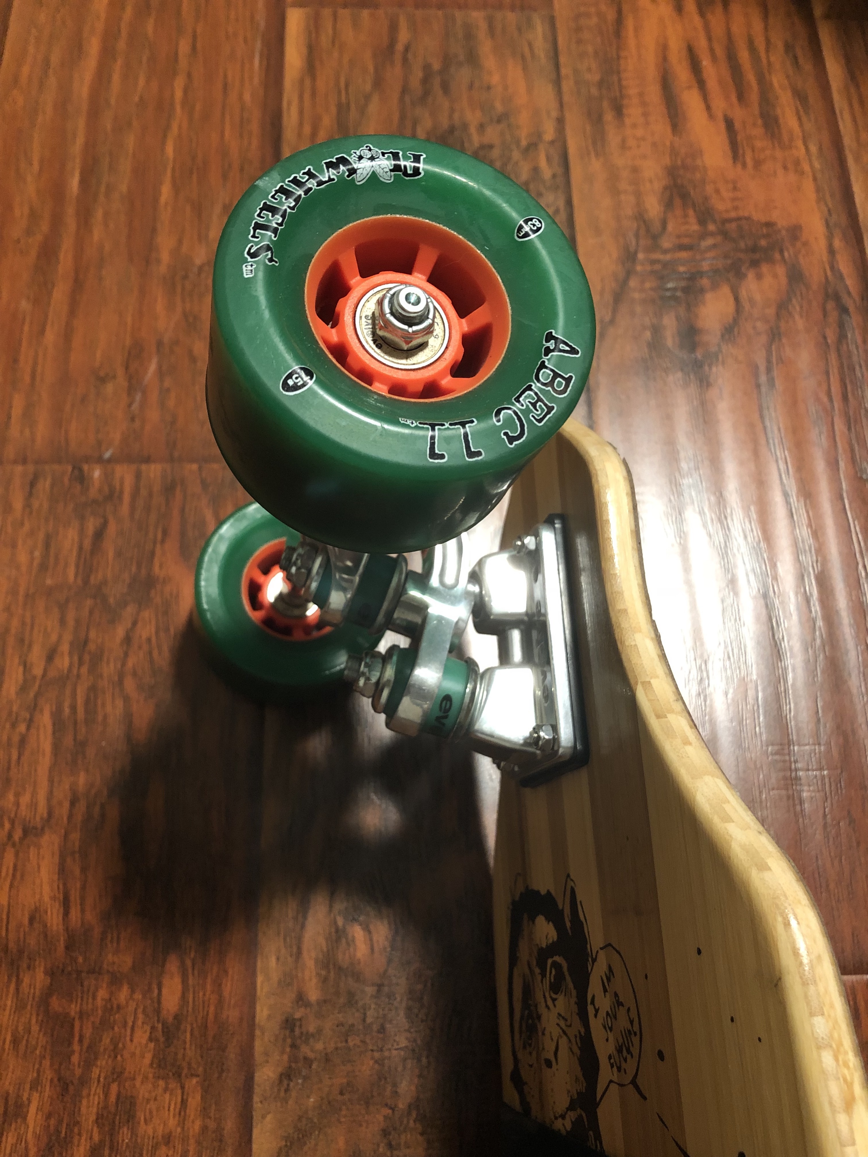

I bought a full AT kit for peanuts a whlle back. Front/rear trucks single mount with bearings and brand new wheels/tires with single pulley and belt.

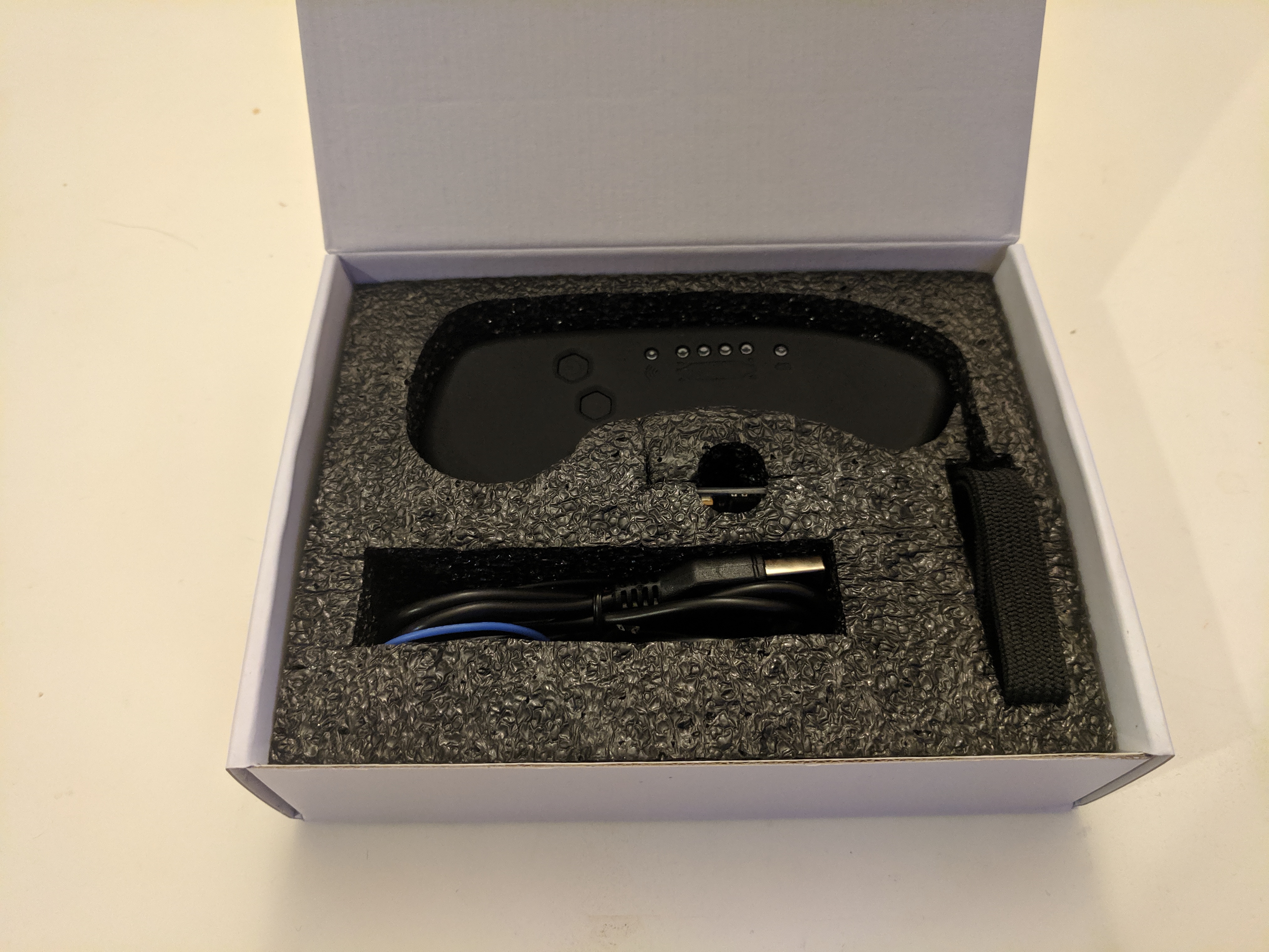

we have the same dillema, i’m thinking of getting a torque boards kit and vesc motor and remote at flipsky. though i have to check the battery if it still works.

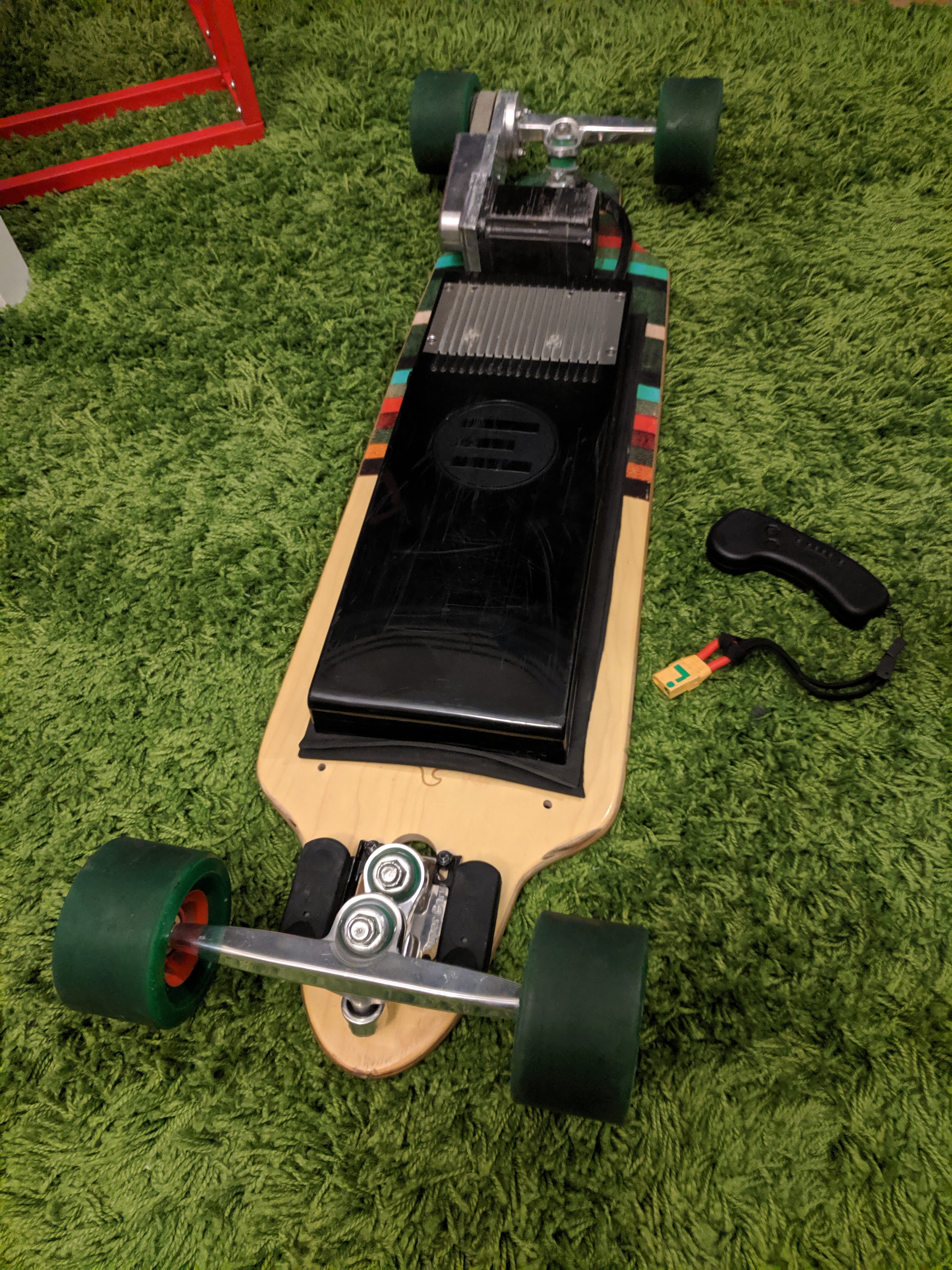

i tried to ride it yesterday it still works but it’s too sketchy with connection cut-offs so it’s too dangerous to ride it now.

thanks! so my plan for torque boards and flipsky components should work right?
Proven stuff. Just make sure the mounts will work with your trucks.

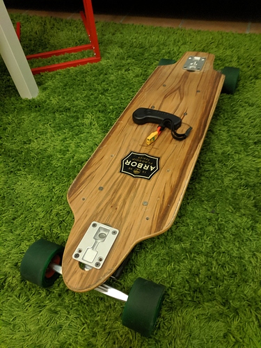

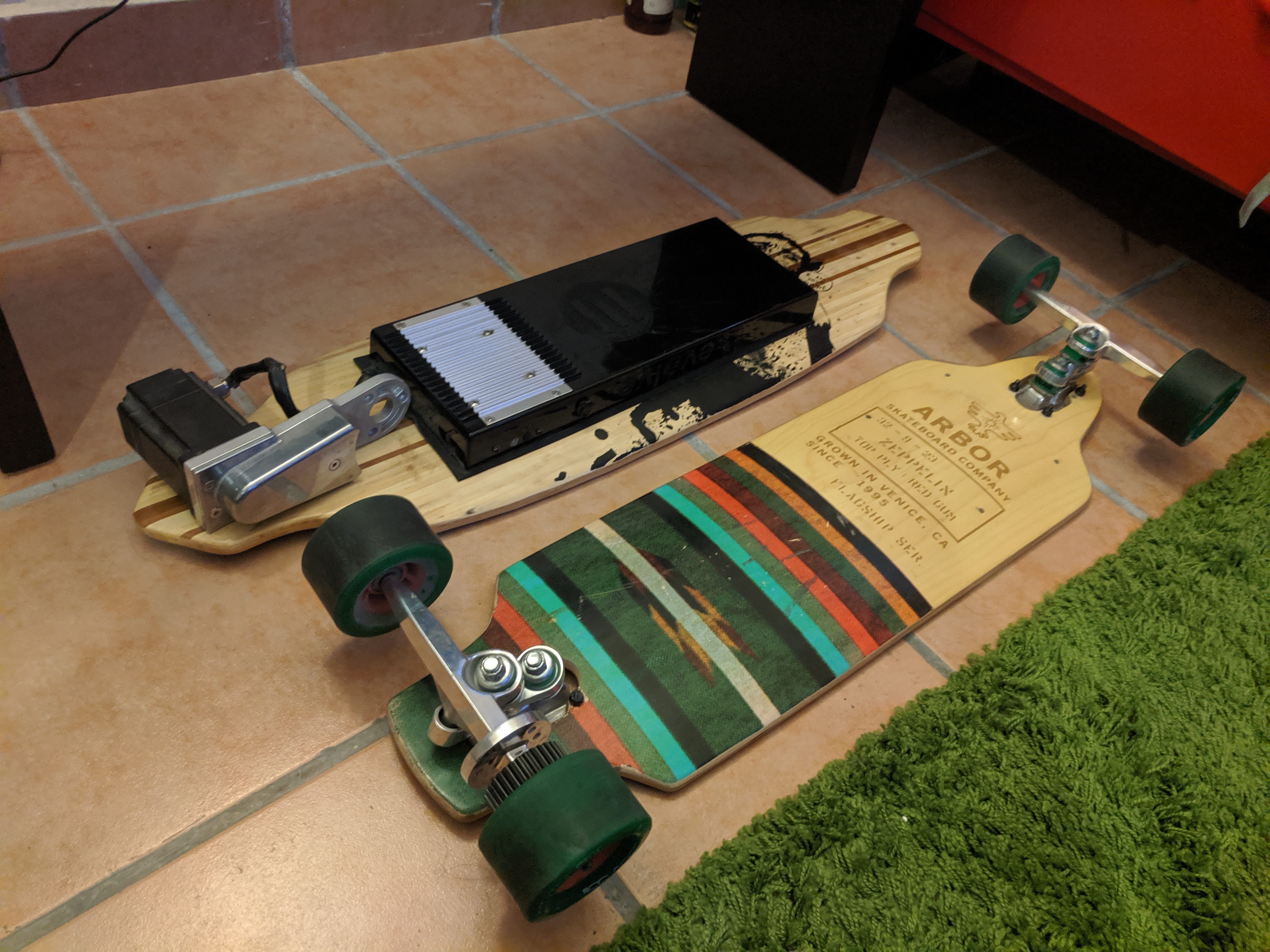

update, still deciding on parts to get. placed the trucks on the deck and checking if the current enclosure will fit on the setup. definitely need to have the trucks reverse mounted for clearance.

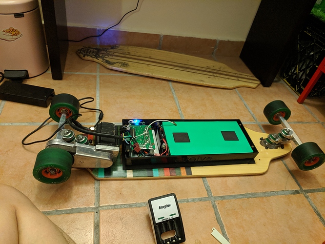

I already installed the VESC on the board, everything works fine as first test, also configured the motor with VESC tool. Only thing that i’m missing is a power switch T_T
I have questions regarding VESC Tools, do you have settings for input controls like how do i set up the speed levels and all the functionality of the VX1 remote? i just checked if it worked and never tinkered more with it.
update! now it’s a functioning board!
will replace the old motor next
