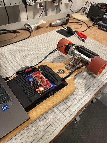

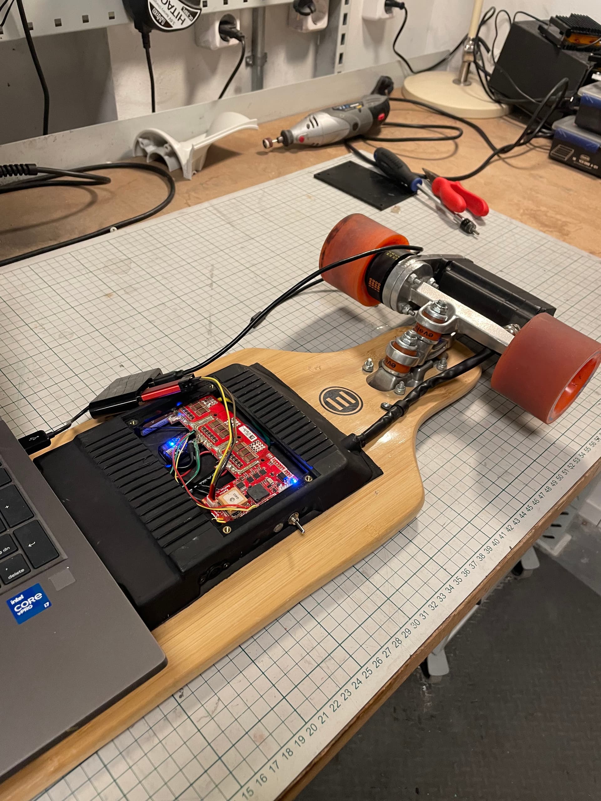

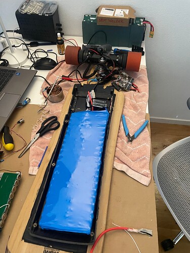

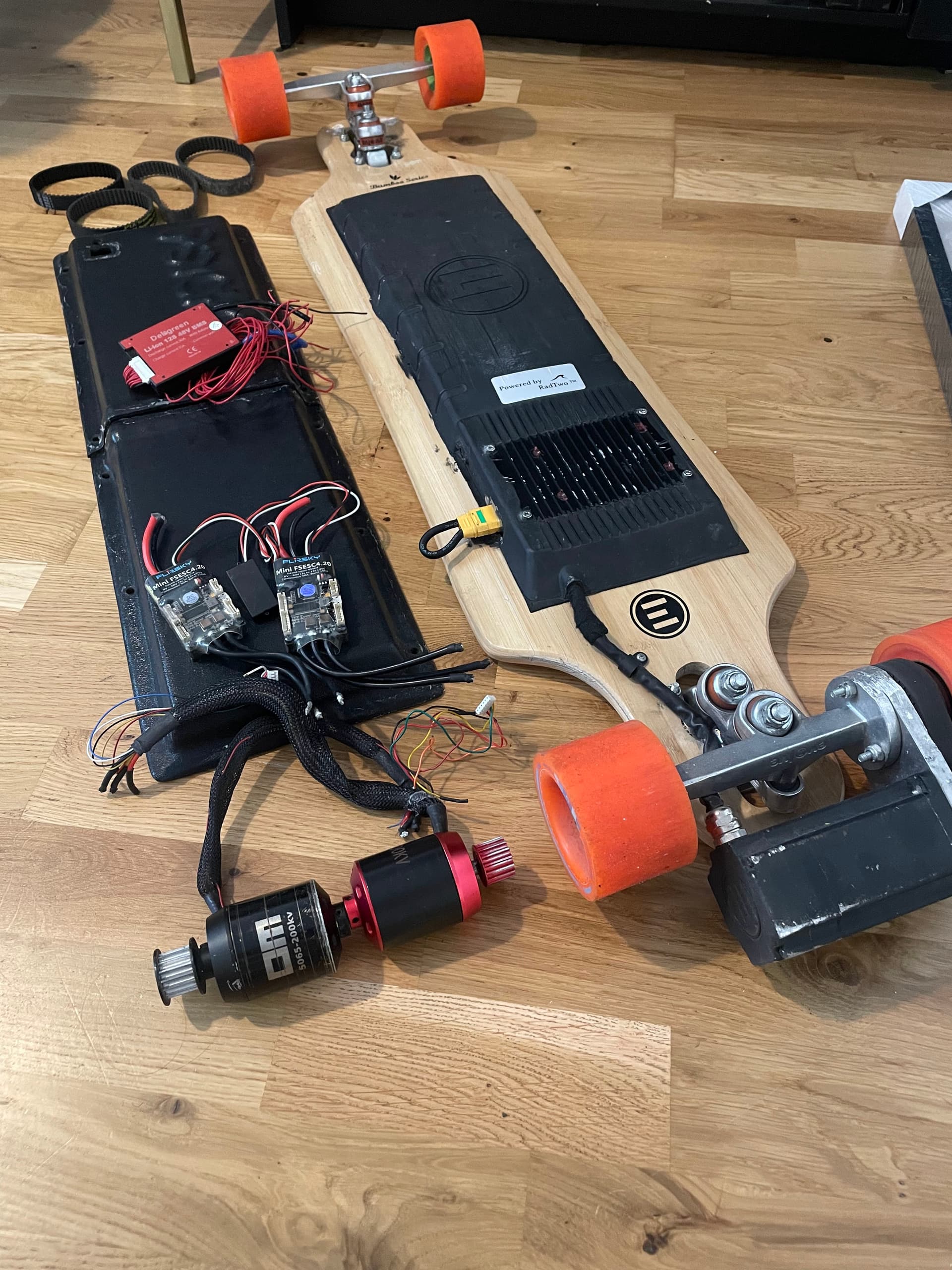

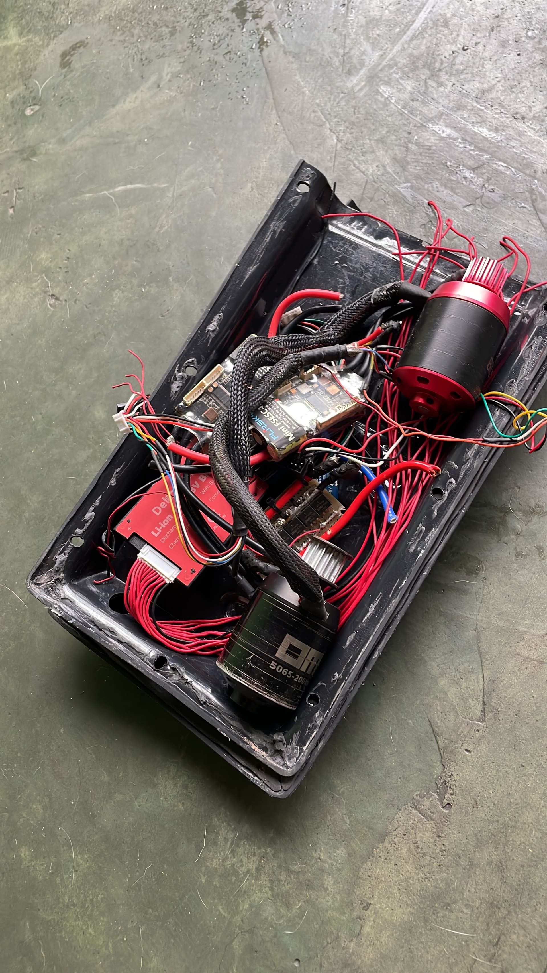

I found this sad board laying around in the new company I had started working at. It was said that the board was laying for 4 years without anyone touching it (she had no remote, nor belts).

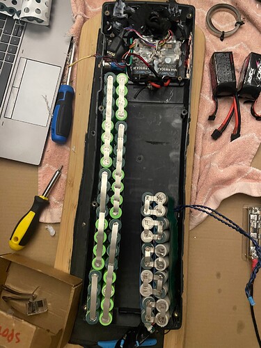

Decided to scrap out the old battery and made a new pack of molicels, 10S2P, and a small VESC 75/300 to drive that little 250W brushless motor.
Loading a custom firmware for it so it would be compatible with the hand controller being used by the company heheh

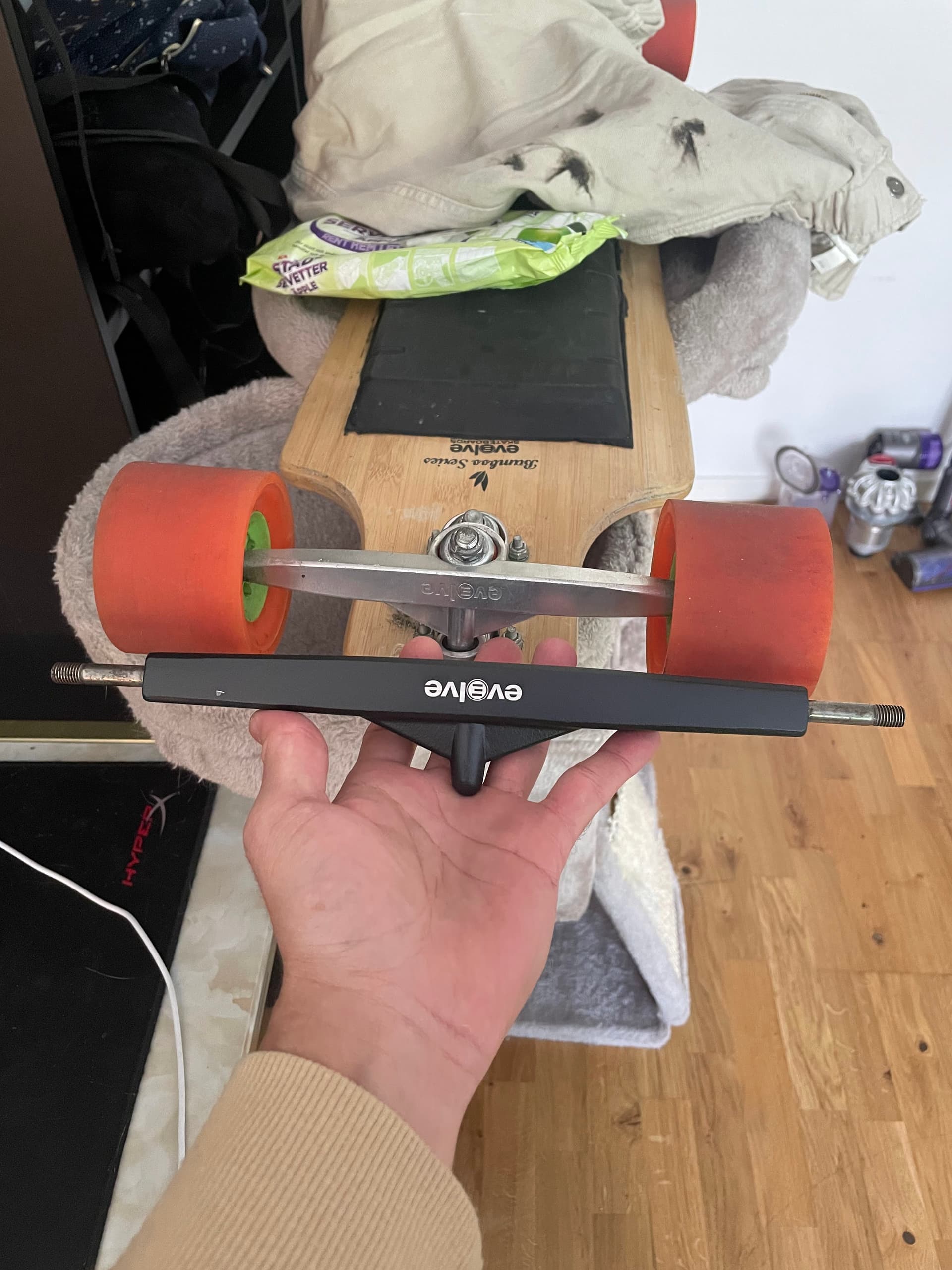

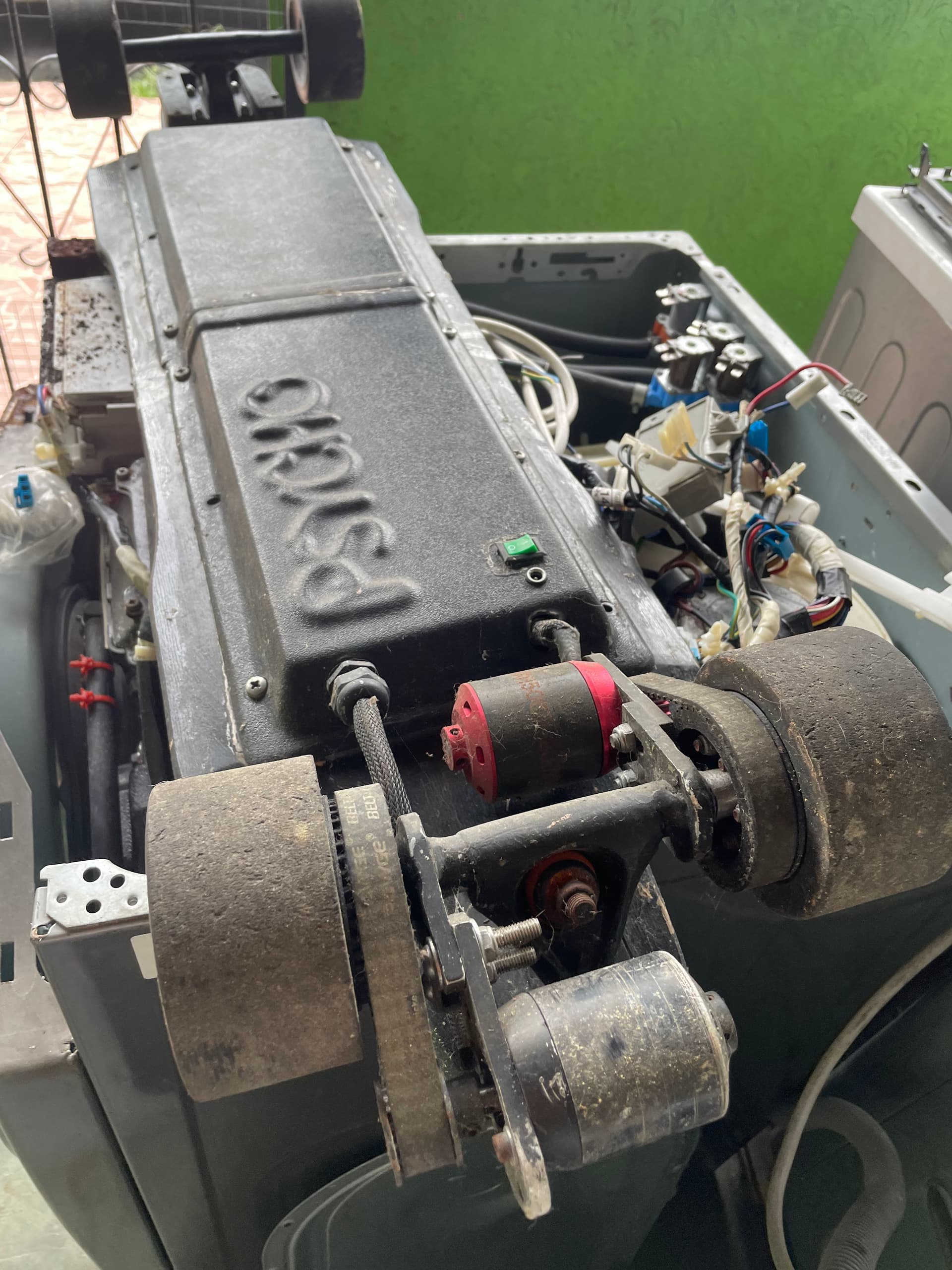

This is my old skateboard, he was collecting dust in Brazil for 2 years.
then i disassembled it and brought it back to Sweden with me
It was time for a major upgrade on that old gen 2 hahaha

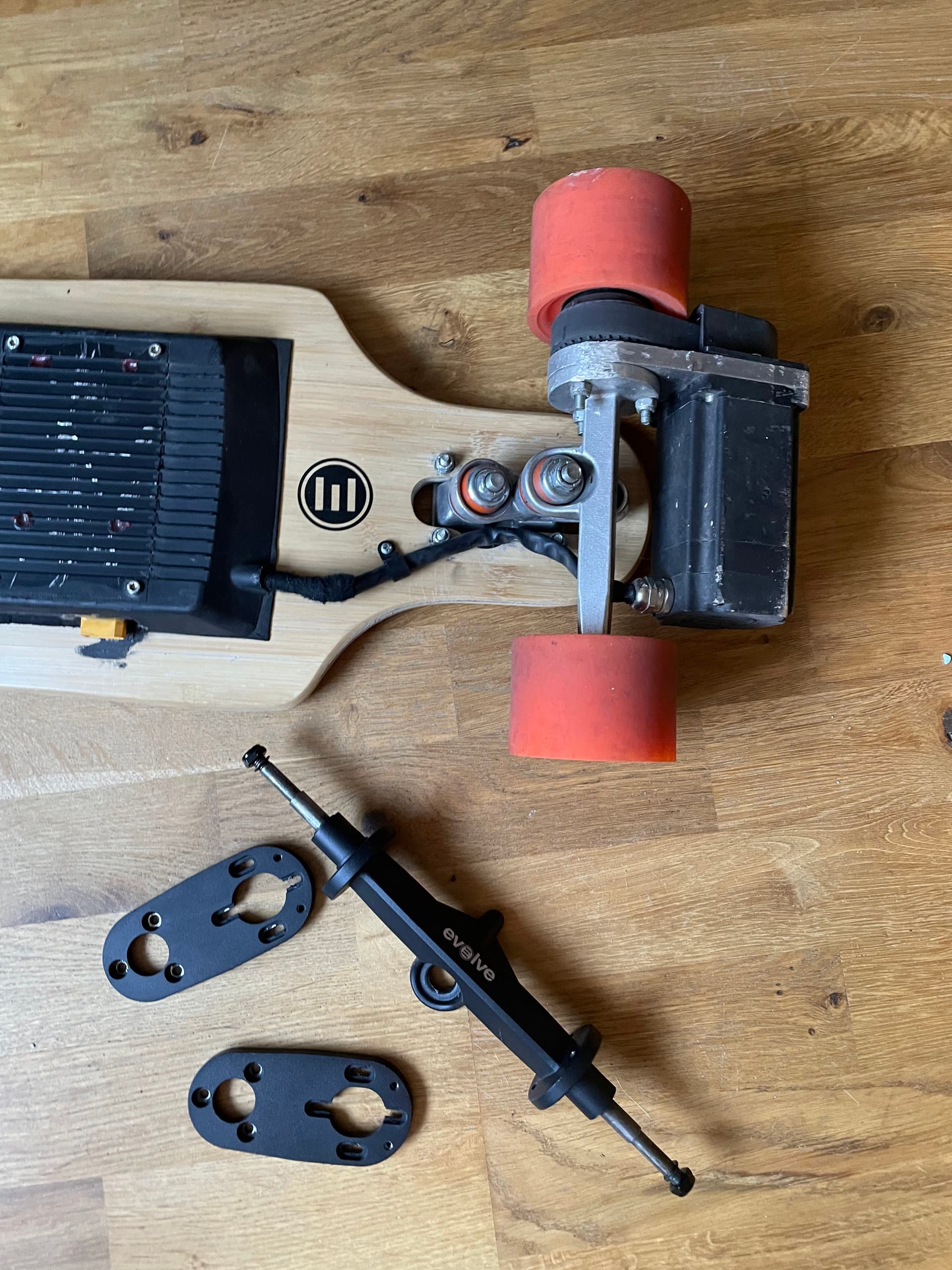

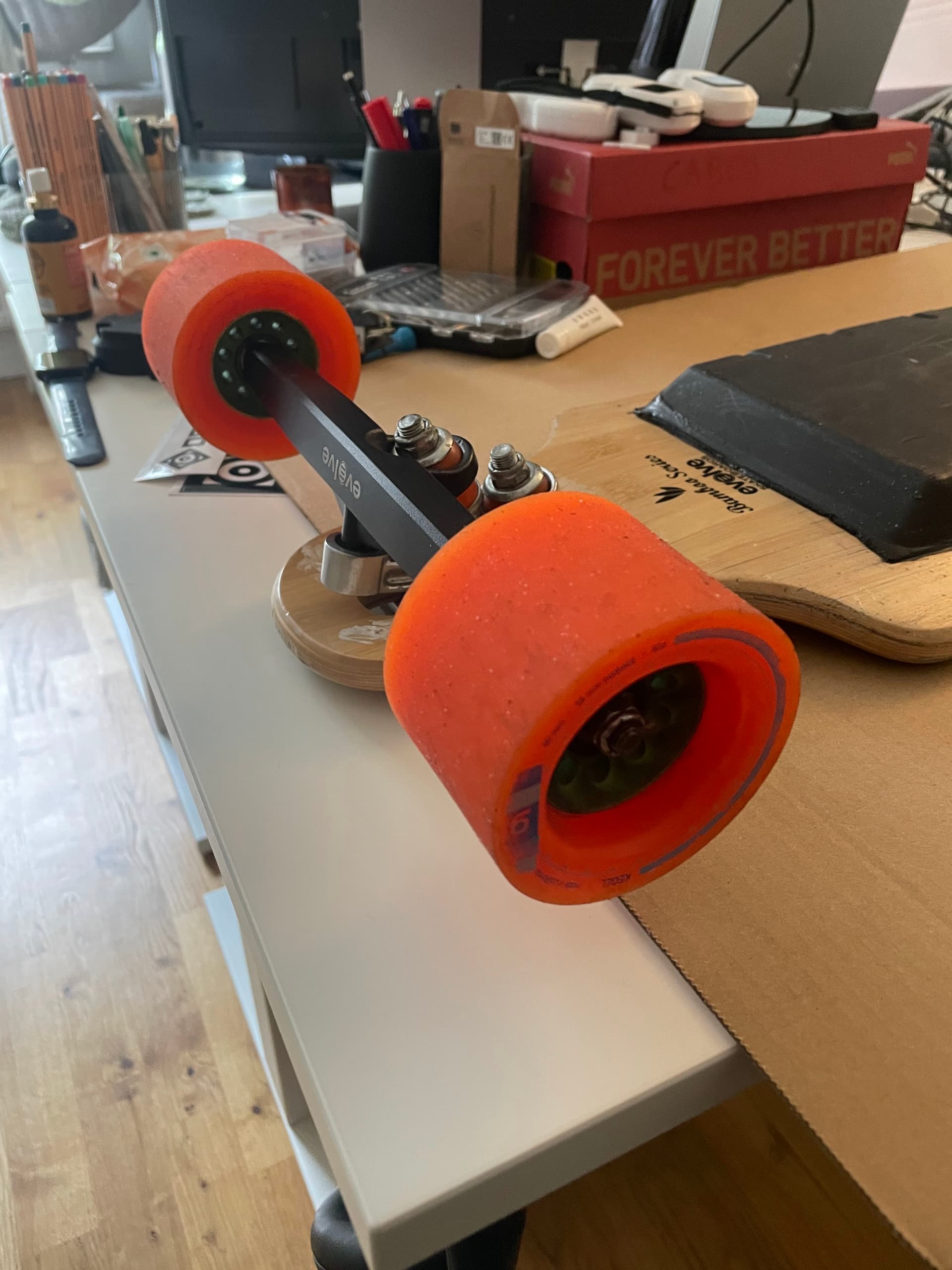

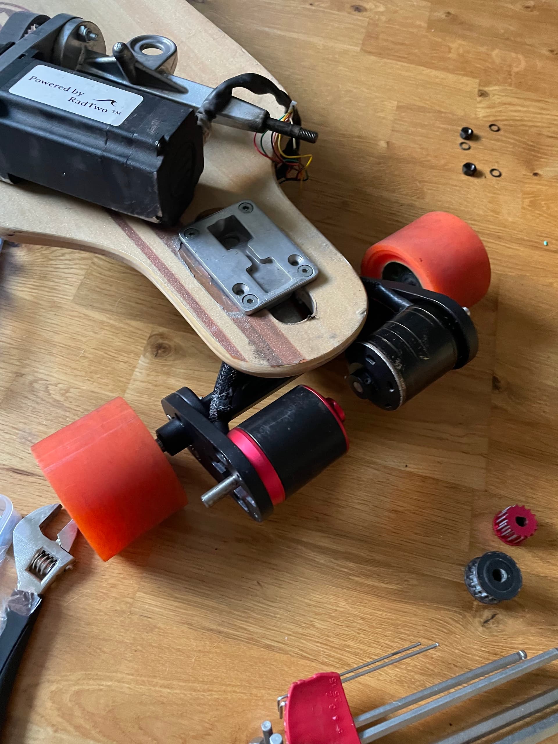

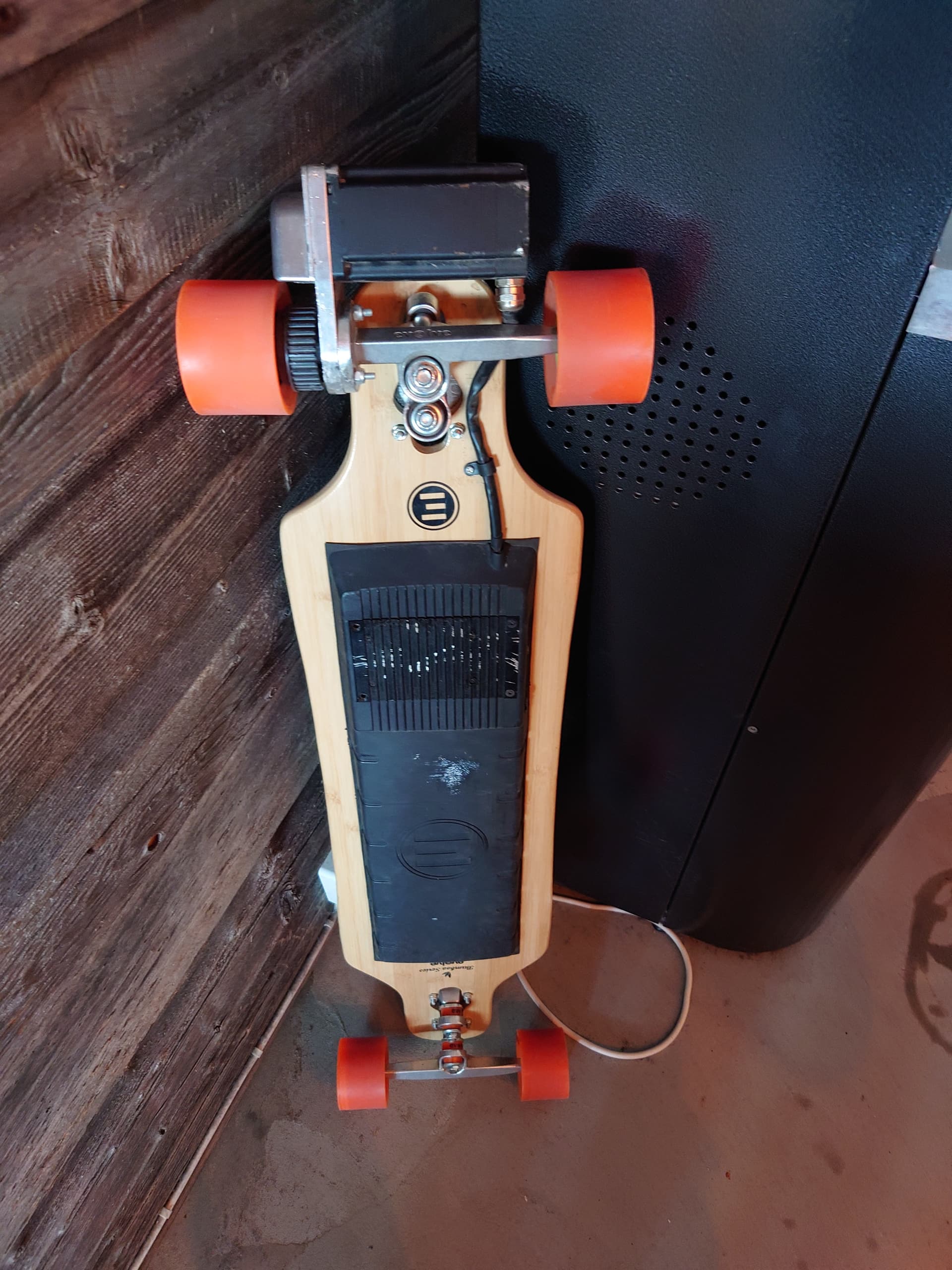

bought just the “Struts” and motor mounts from Evolve’s website, they were perfectly compatile with the Gen2 trucks
They look amazing
Got the front struts also

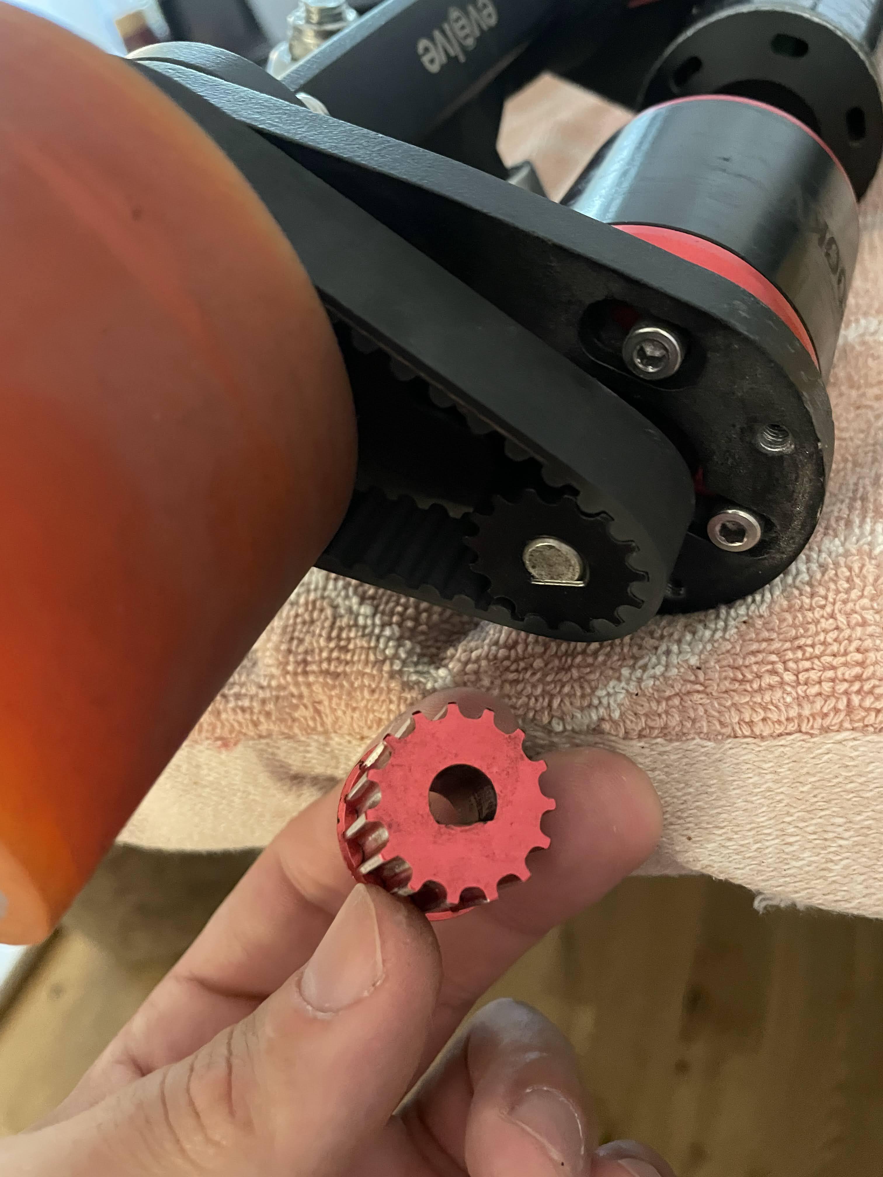

changed the old aluminium pulleys for steel ones

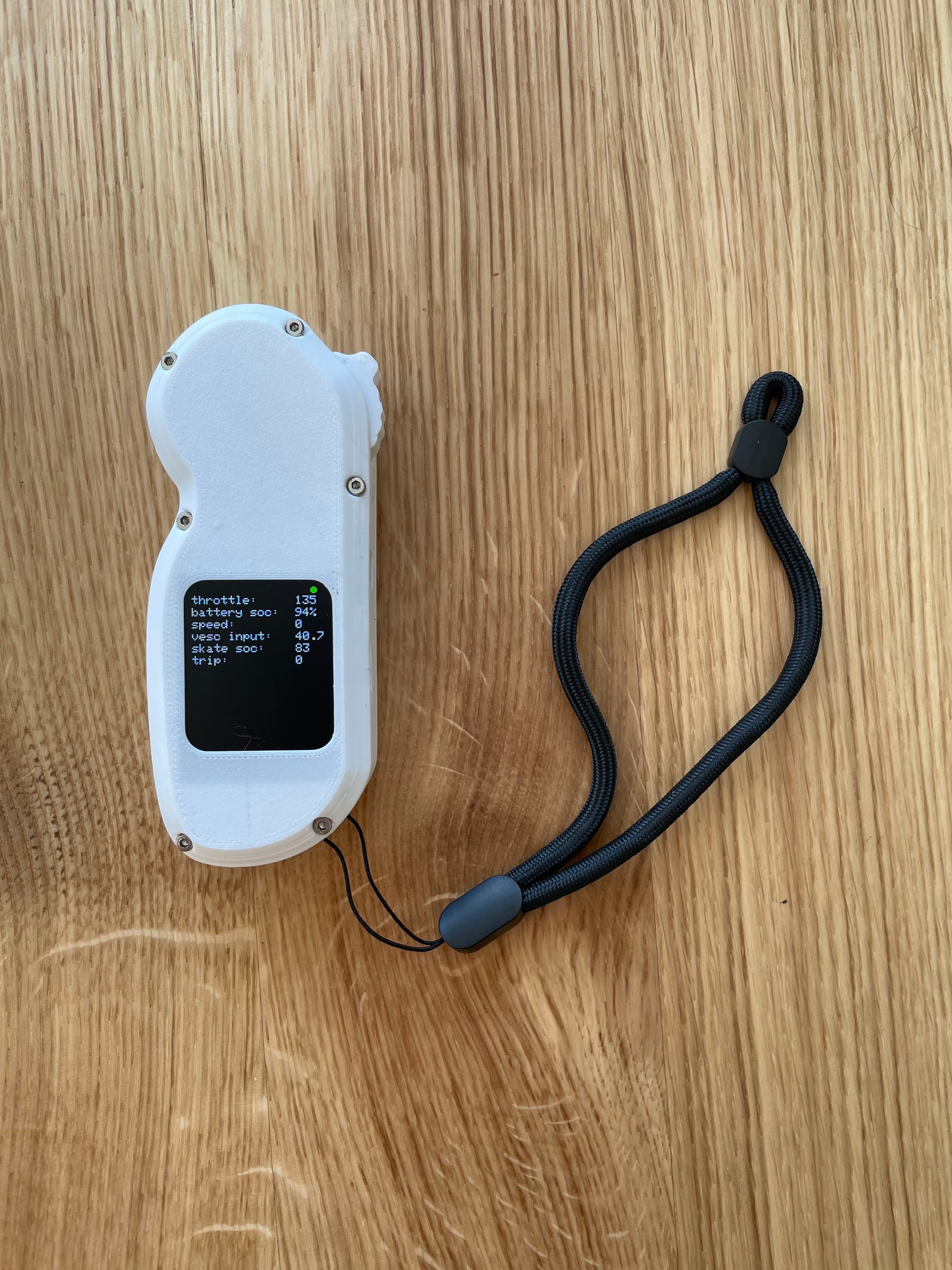

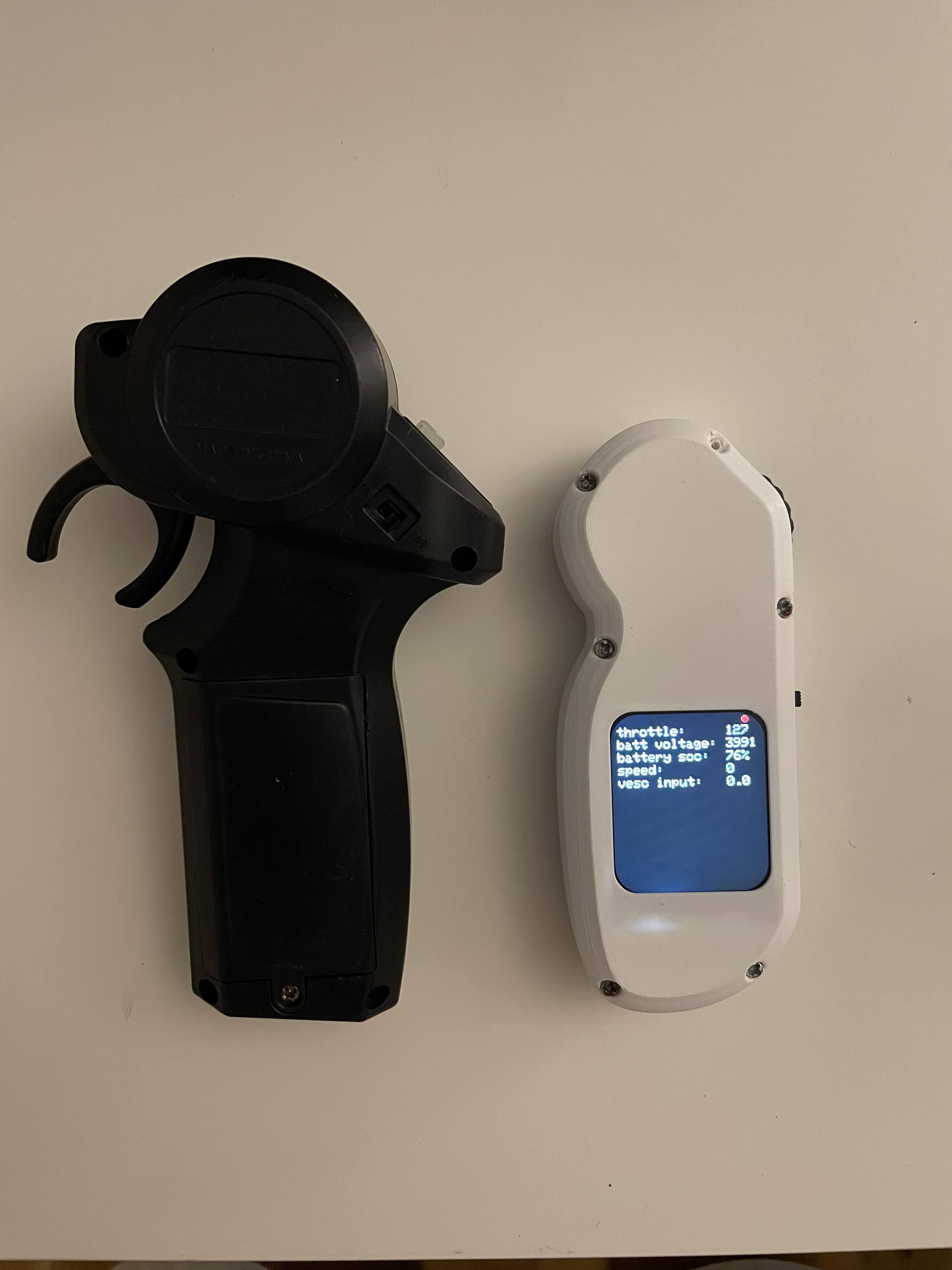

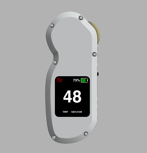

My old hand controller wasn’t cutting anymore so i decided to develop my own
it was also a mess to fit everything together in the original evolve case

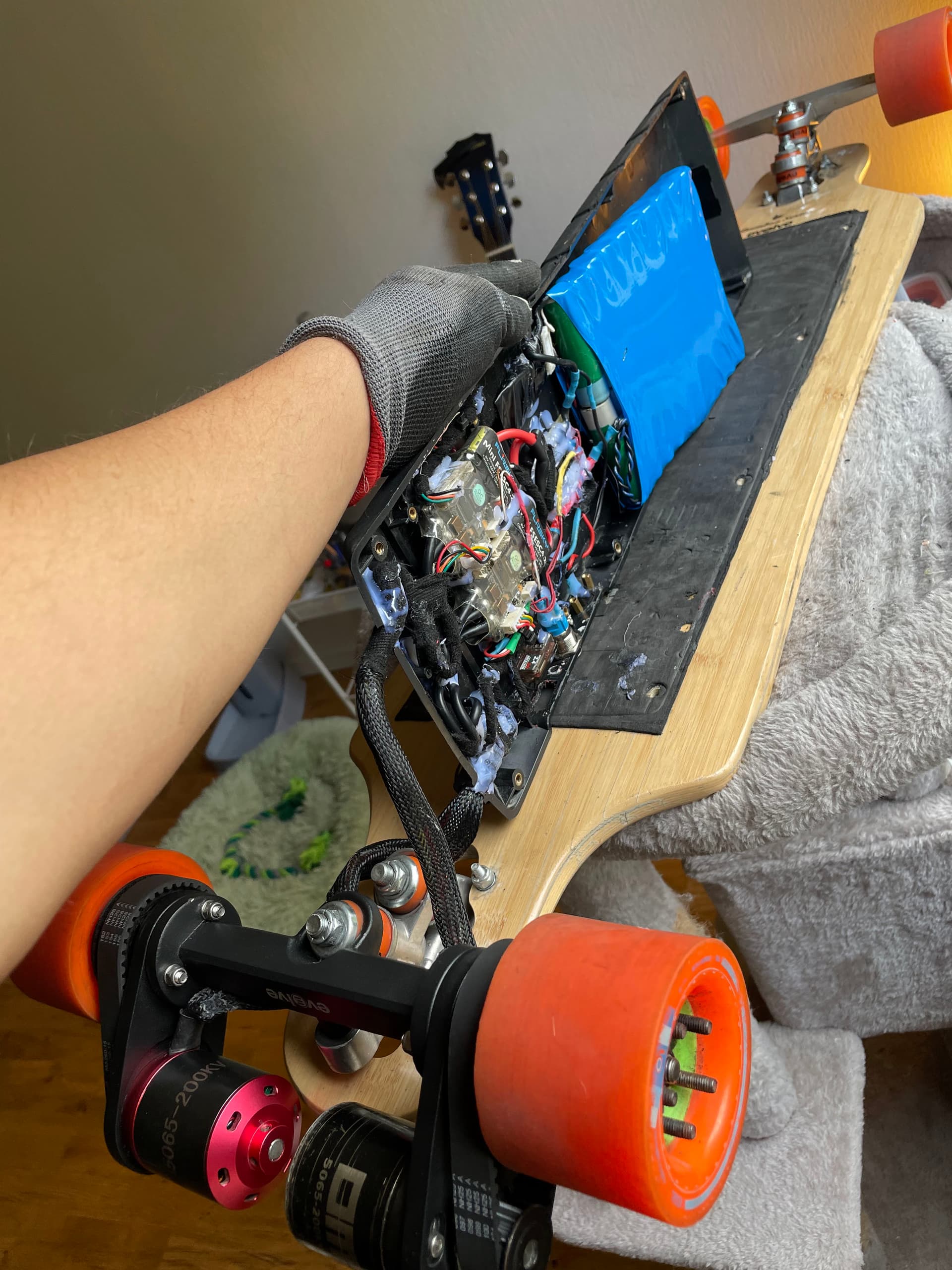

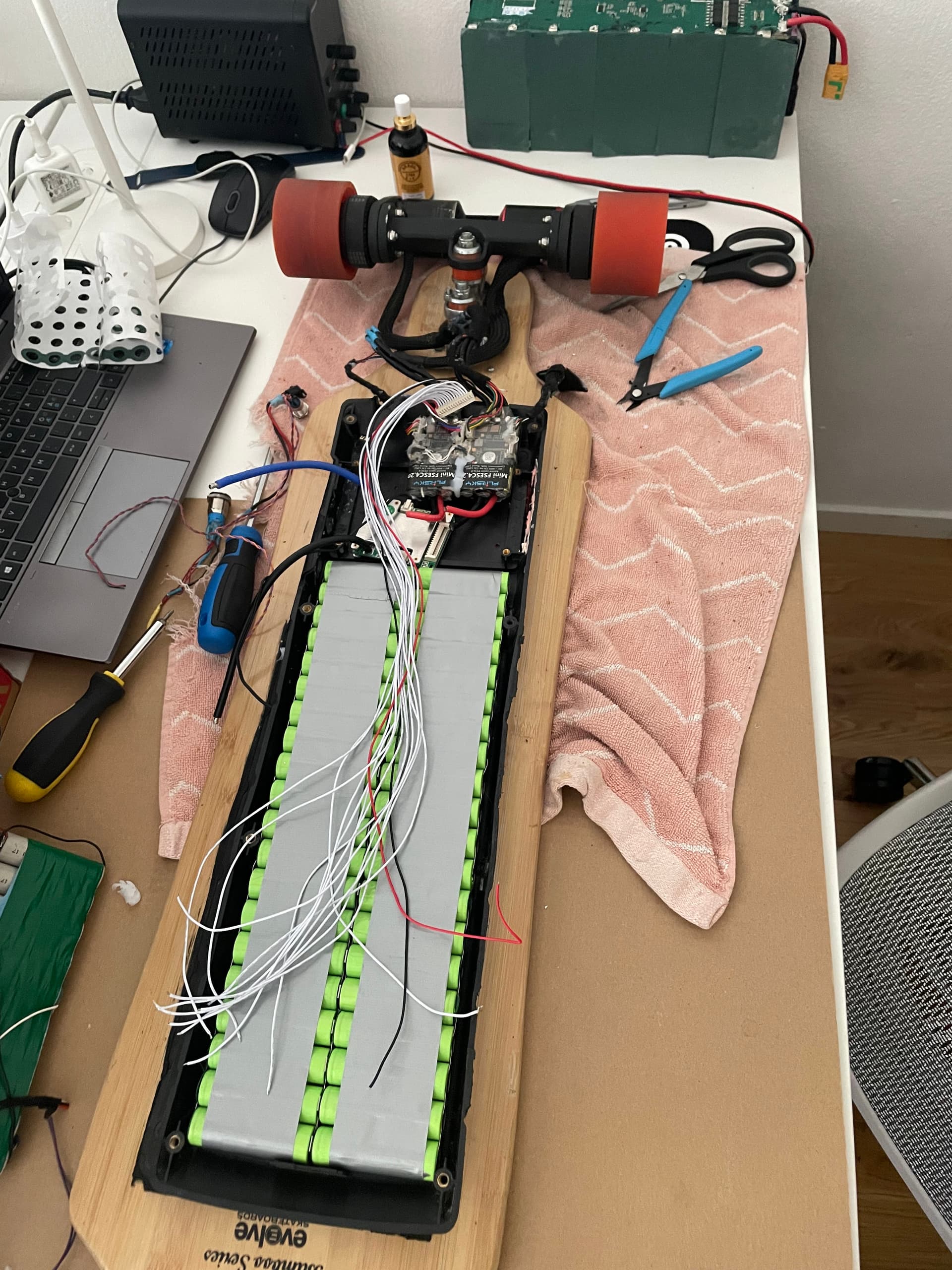

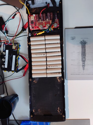

After some rides i casually decided to upgrade the battery
so i went from 10S2P to 10S4P 30Q
I used Jaibaida bms from aliexpress, its pretty neat

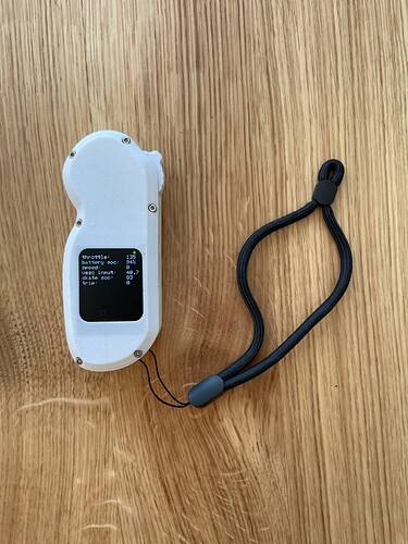

My hand controller was also almost being finished, (thats a project apart, I will make another post about it in the future)

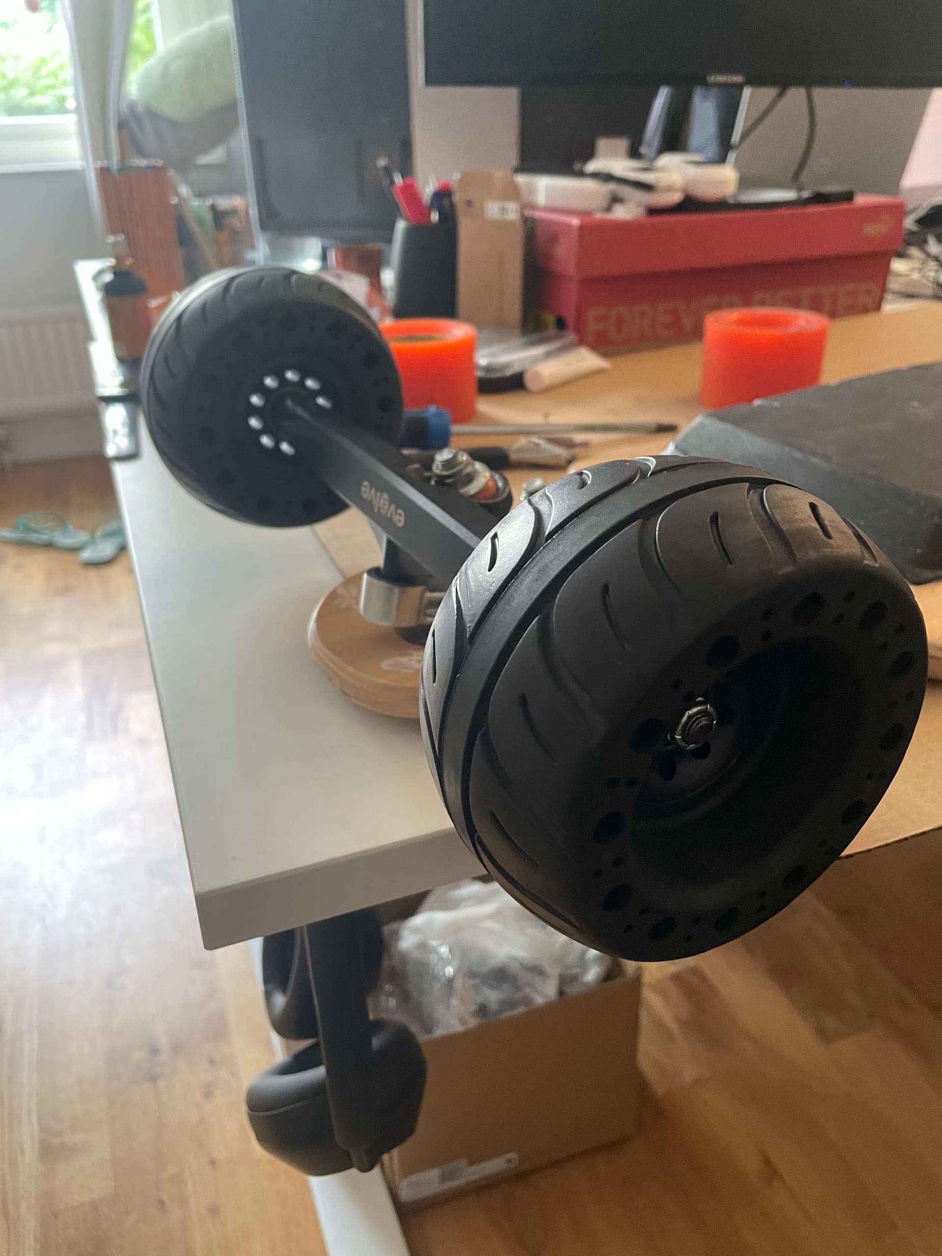

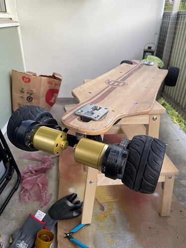

So i decided to change the wheels
to Onsra 115mm rubber wheels

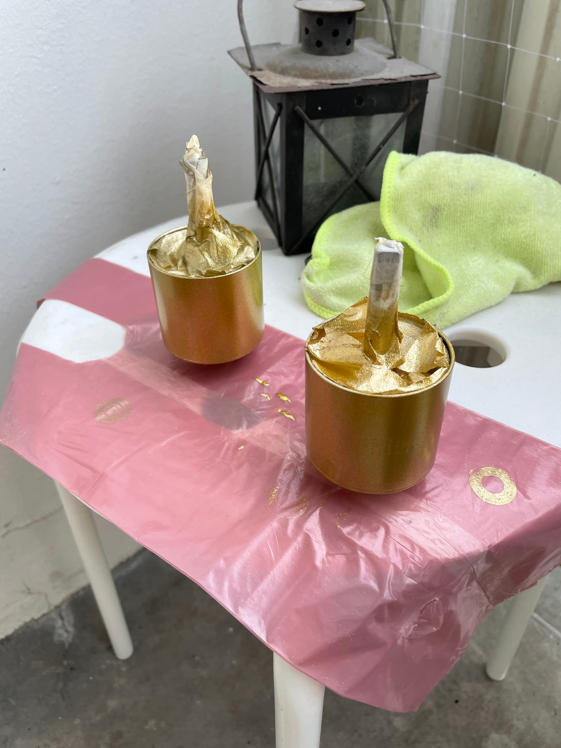

then the final touch was painting the motors gold
looking neat

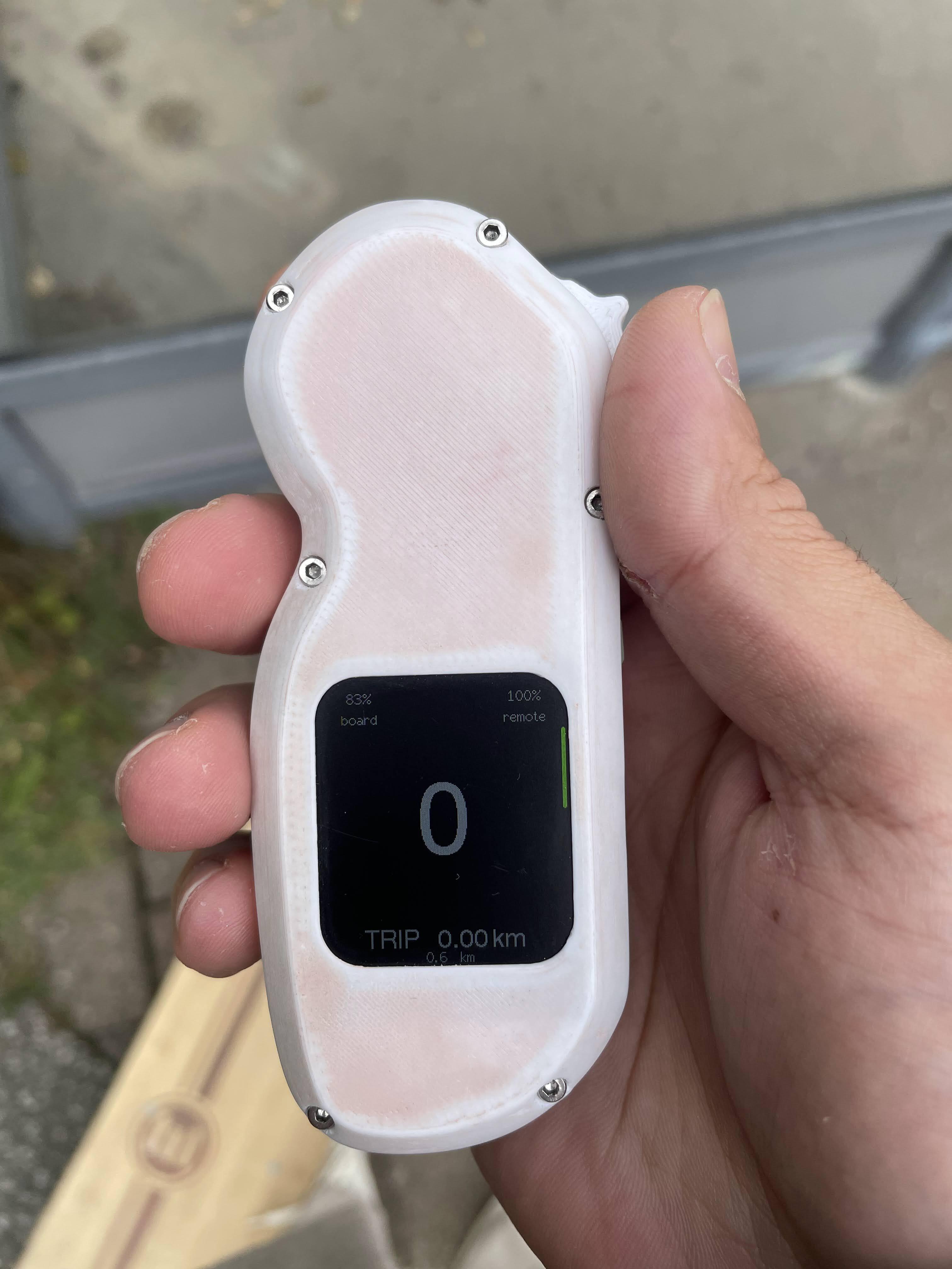

It was a really fun ride with it, now my hand controller is super reliable and the UI is looking quite good also
Please let me know what you guys think of, and also I’m really eager to put my custom hand controller on the market for us DIYers
what kinda paint did you use? looks friggin sweet :ok_hand:
this one, and i didn’t even did a prime coat
Really nice journey man. Interested on the remote, whenever you have more news about it.
Great work reviving the old board! The deck still looks good after all these years. Can’t wait to hear about your controller though, we desperately need more VESC compatible remotes with live telemetry display!!!
yes! i’m planning on posting it as soon as I get the controller on the final stage and ready to sell.
some key specs
HALL sensors!
bluetooth low energy with coded PHY for ultimate communication reliability
lcd display for VESC telemetry and data
compatibility with common escs also
