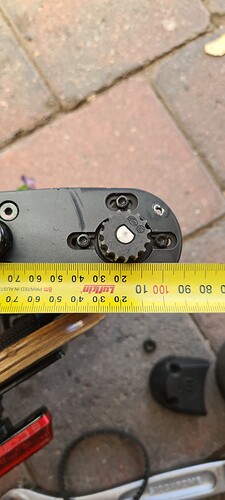

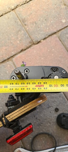

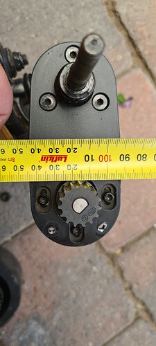

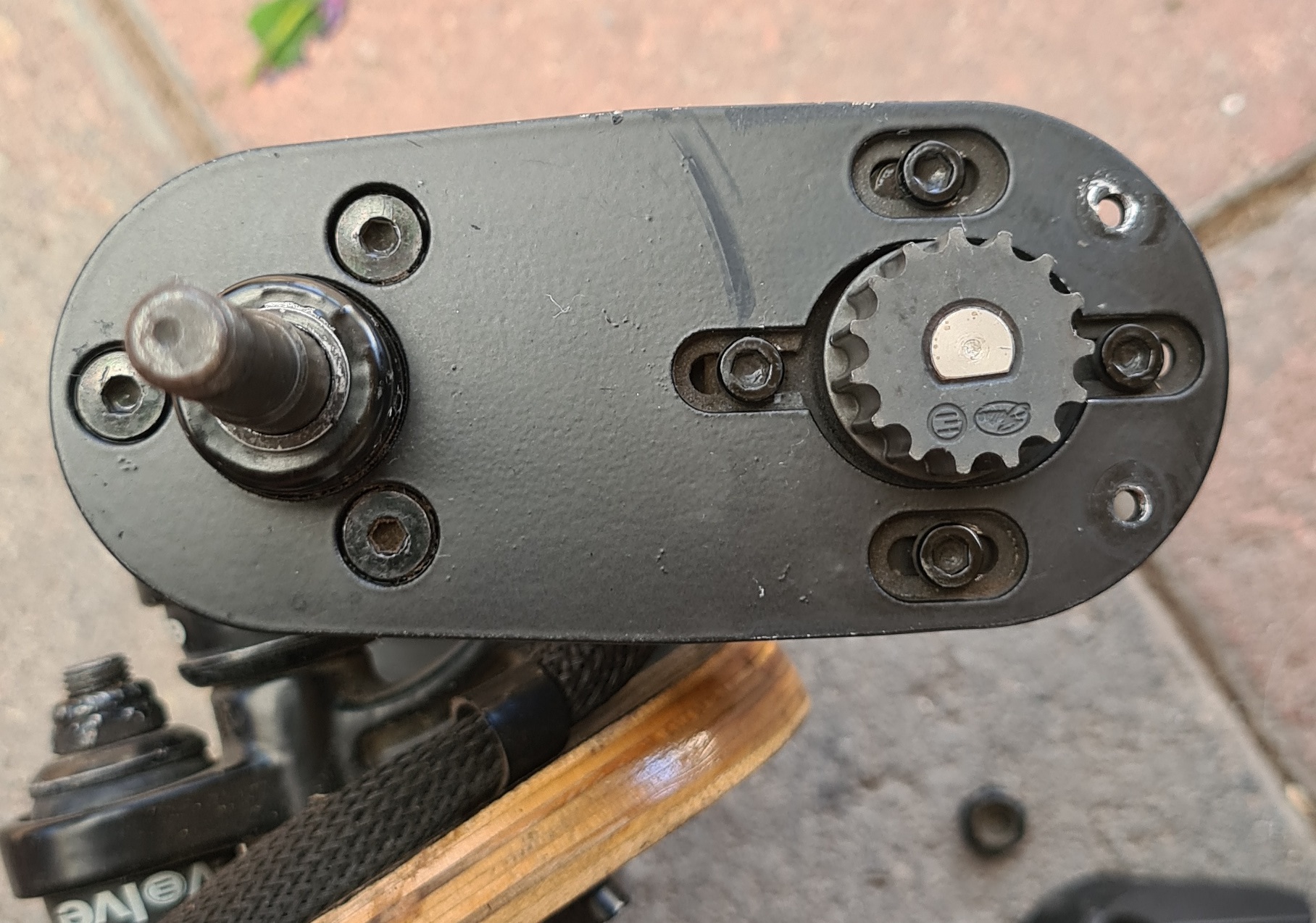

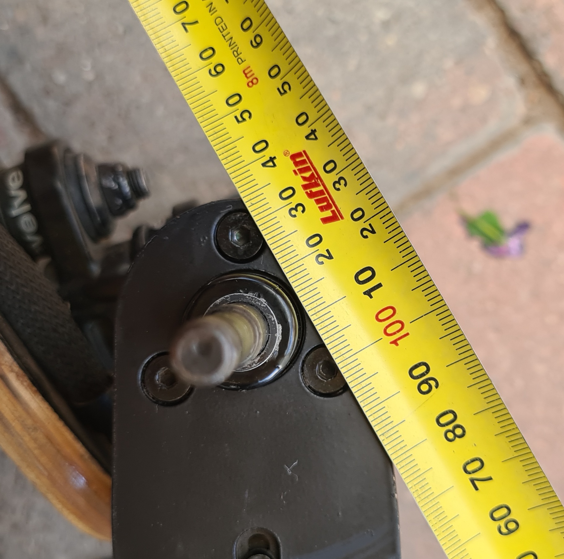

Send pics. The newer evolves use bigger cans than what most of us remember. I’ve never seen the mounting screw pattern bc I don’t tinker on these anymore.
You might not need new mounts at all.

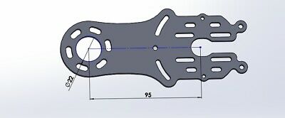

for the truck, I think this mount, but this mount only can support 30 or 44mm motor install holes.
@Goldmember those look like the older style mounts with 56mm diameter motors and (36mm bolt pattern?)

Expect to go on a belt hunt if you use mounts that are longer than stock. Here is a center distance calculator.
Evolve is something like 15:66 ? I can measure center distance and count teeth if you don’t have access to evolve parts.
