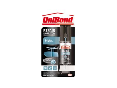

tempted by this one also but would go with JB if I could

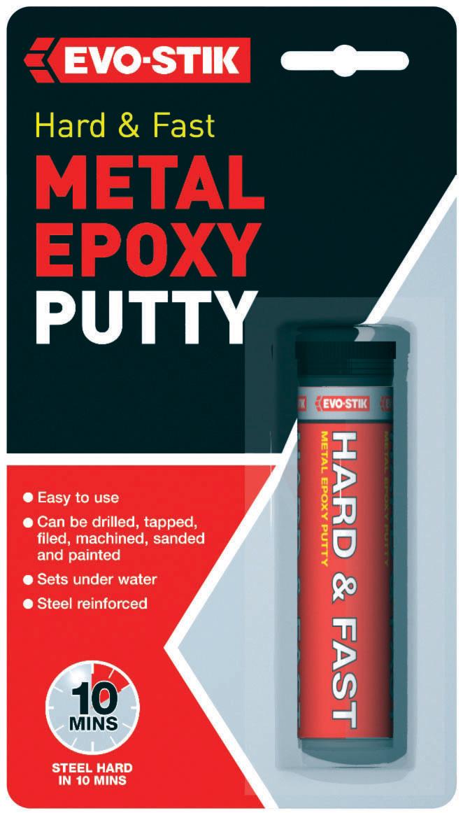

and considered this putty before
I’d try to find a metal-oriented epoxy that is probably for automotive use and definitely of all those, the one with the longest cure time.
Let it cure 5 times as long as it says it needs to. In my experience, the bond keeps getting stronger for a significant amount of time after it appears “cured”. You want to back it out on the first try, not have it slip because you didn’t wait long enough.
