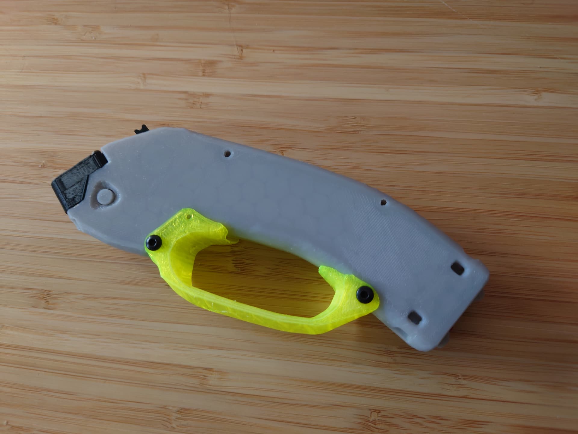

This looks good! I like the handle. The display is small, but very functional, I like it. The number of screws holding the remote together seem suspicious, I assume this means that there are a few different grips that can be attached to it ? ( this is useful for people with large/small hands and/or lefty/righty )
Must have buttons, where are the power and “option” buttons ?
FUTURE – There is an opportunity to loop in a HUD in the future – The Next Ray-Ban Meta Glasses Will Reportedly Get A HUD
Yea, there are about 30 screws in total, but if I change it to hall sensors and properly integrate the screen I can get rid of half of them.

Totally, it could be used without any grips, or with different size grips and knuckle savers.

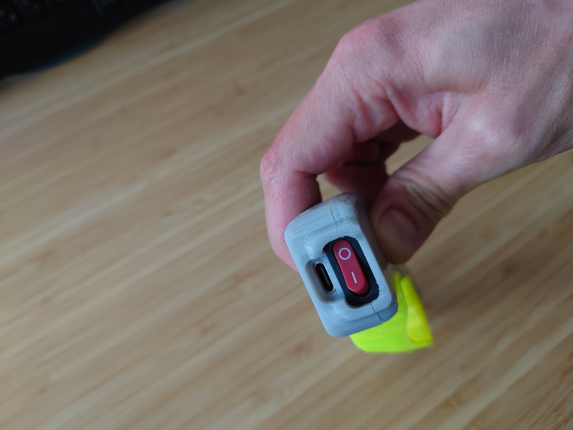

I’ll post a video later, there’s a button to flip through telemetry pages, power is a rocker switch right now, I actually like it.

I’ve finalized the case and grip design, reduced the number of screws to 16 minimum.
Now the screen fits as is and doesn’t require pin removal, also switch doesn’t need pin shortening.

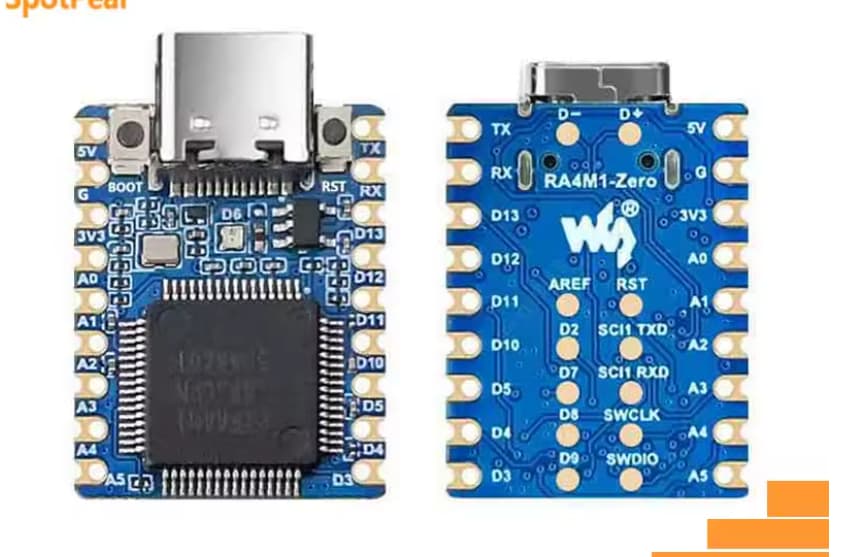

Cleaning up the software, added RA4M1 support. RA4M1 comes with arduino IDE support, doesn’t need bootloader flashing like stm32, doesn’t need pin removal and leaves more space for the battery. Tweaked the HALL and magnets positions to get more range:
For now i’m waiting for more aliexpress modules to finalize electronics.

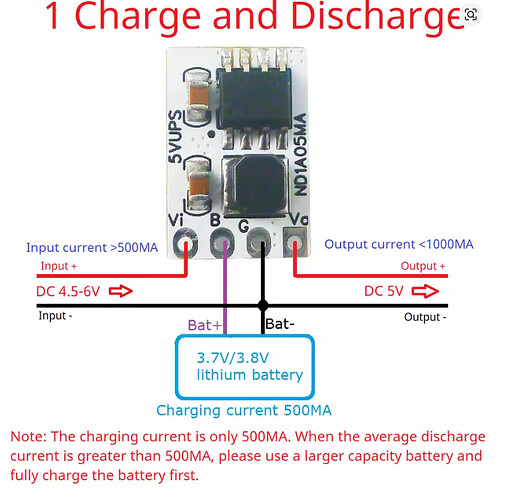

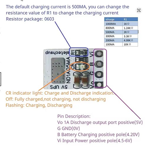

I’ve found these modules, they have both charging and discharging in one, plus the charge current is not crazy.
Also wanna use the waveshare RA4M1, cause it has USB D+D- pins

This is my biggest gripe with the zmote, i wish it had haptic feedback.
Oh, right. Thanks for reminding, gotta look for some vibration motors.
