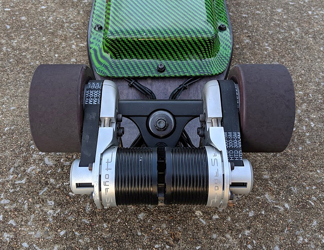

Let us begin with the understanding that this not just a drive train, it is a drive system. Its a traditional Caliber II 10″ truck with motor mounts, motors, pulleys, wheels, belts, etc. It comes pre-assembled and ready to ride. I choose the term “system” because all you have to do is plug up the motor cables and bolt the base plate to the deck.
The components separately are thought provoking and impressive.
The Hoyt Pocket Rocket Motors are the best sub 6374 that I’ve ever seen. It is the best 50XX power-plant I’ve ever seen. I would put the motors against any 6355 as far as longevity and performance are concerned. The are built by a US brushless motor manufacturer whose primary function is supplying the US military. The ‘Mil-Spec’ philosophy can be seen in the construction of these motors.
I am not a huge fan of caliber trucks, but I think Hoyt must be getting a custom run as these do not have the tell-tail defects that Calibers almost always have, in my experience. The tolerances are relatively tight, no nerf’d threads and the axles are perfectly straight and symmetrical. I would recommend precision bushing washers be included, I think the cost justifies that.
The anodized CNC 6160 aluminum mounts are genius, once mounted you can set/reset the belt tension at will with the spring-loaded auto-belt tensioners. Belt replacement and wheel swaps take very little time, it’s measured in minutes.
image image
The wheel pulleys and mounts are precision manufactured with the quality that implies. The belt cover on the motor pulley is simple yet solves the issue of debris intake. The drive train uses a 16/38 pulley count (2.38:1 gear ratio). The higher count on the motor pulley gives a speed boost while being regulated by the higher tooth count on the wheel pulley which smooths out the drive ticks that many complain about.

Those spring loaded mounts are genius
The entire system is genius…not so much the wheels, but I’m picky AF about wheels :slight_smile:.
I would love to know why they went with 50xx motors over 63xx motors. I don’t think they made a mistake I just want to know their thought process.
More clearance and what was “needed” I assume. These are great motors, fast and torque-heavy, they don’t get hot nearly as fast I had assumed they would. You also have to keep in mind, this isn’t a race board, it’s a carver/commuter.
Nice write up Mike. Looks very impressive for a last mile type set up. Hasn’t the Yeti (@DerelictRobot) used these motors and loved them? Speaks volumes about the quality if they can haul his ass around without imploding. I love the mounts too. How are the bushings from factory because you need to play with calibers usually to get them to perform?
Its a great setup, by far the most stability I’ve experienced on a narrow setup such as this. The motors, I can’t say enough about the motors. Initially I wasn’t that impressed, but after bumping the amps they really started to hum. I am not positive but I think maybe these are after-market bushings. I tightened the kingpin a bit, it was pretty loose when I got the drive train. Other than that I haven’t changed anything.
Definitely after market then because standard calibers are pants. Looks like a lot of thought and design has gone into this. Thats what you pay for at the end of the day.
