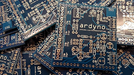

I guess that gives a talented individual scope to diy? Apart from measuring power, alllowing ‘live’ tuning on a rolling road similarities. The only info that would be got is the measurements taken off the roller, possibly an ardruino program has been written
https://sites.google.com/site/simpledyno/the-dyno
