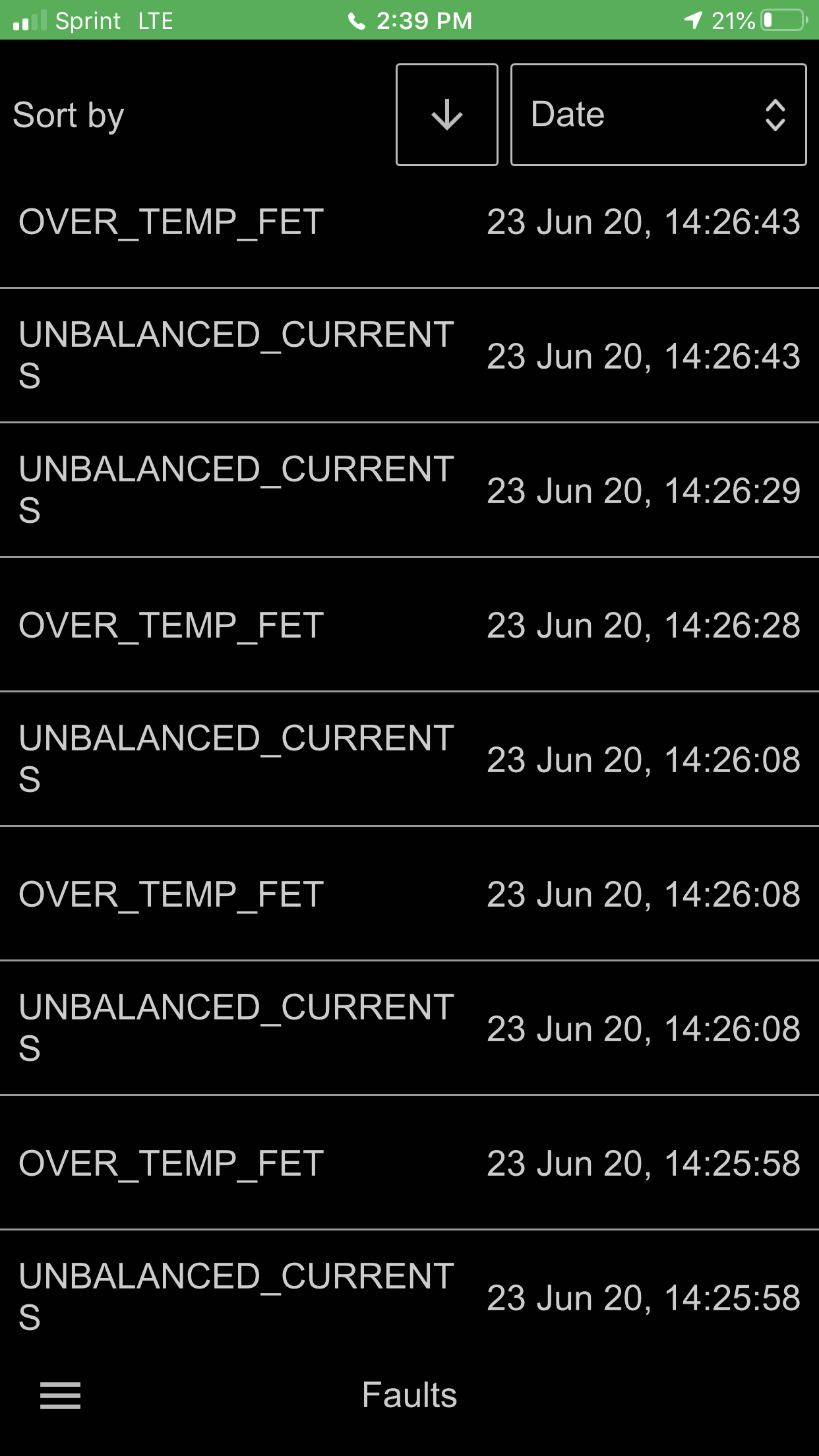

ESCapes shitting the bed? Could be a motor problem. In progress
Got first faults through metr yesterday.
Was on a ride and had to pause to let some rain pass. Remote switched off and board still on with 49V. I got three in succession while were sitting around and never saw it again. Finished the ride and stayed connected for 6 hours home. Never got it again. I didn’t see where I could research fault codes in vesc tool. If they’re there, just point in the right direction.

Took the board out again and got peppered with unbalanced current faults. All was fine until I hit the first hill. Board fell on its face and got Over Temp Fet faults mixed with unbalanced current.
Looking at vesc 1 and Vesc 2 in metr and everything is the same.

One of the over temp details
@JohnnyMeduse any idea what this could be?
That could be a lots of thing…
But most likely one of the fets or one resistor is fucked. Or could be something with the motor. I would try to redo a motor detection to check if the value are still the same and nothing have shifted.

Thank you very much. I’ll do it tonight and report back. Was just looking at the log and noticing that one vesc was way hotter than the other. 70 vs 96C when this went down.
@JohnnyMeduse or anyone else that’s smarter than me. Re-ran detection and motor amps has definitely changed on the vesc/motor that was faulting.

Switch your motors and see if the problem switches sides or stays on the same side.
