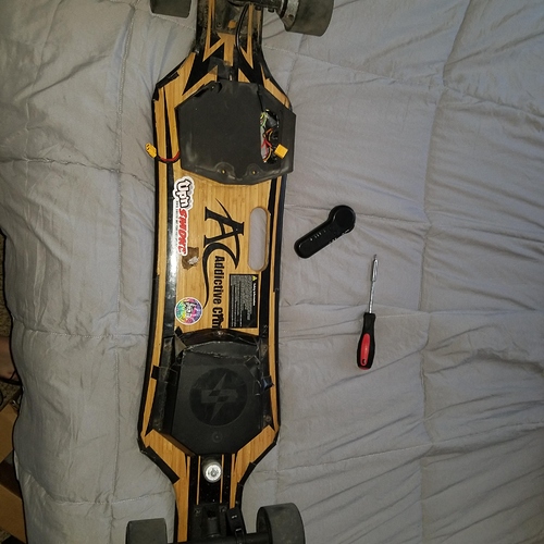

Hello all, almost a year ago I got an AC Electric Longboard, and its been treating me surprisingly well for a being a cheap clone dropship board, up until about two months ago. However, due to midterms and snow, I haven’t really had time to pay attention to it.
I don’t know how to diagnose what is wrong. I think the ESC is malfunctioning, due to a variety of factors. Those are
  1. The power button does nothing. It does not turn the EBoard on nor off, regardless of the boards previous state. The board turns on whenever plugged in and the motor wheel is turned.
  2. There appears to be some burnt plastic on the capacitor(fuse?) on the green wire, so perhaps there was a short?
  3. When the board is on, the remote still works, however, the braking system does not. I could hear/feel the motor trying to break, however, it simply would not decelerate me more than the slightest amount per attempted rotation.
  4. When I opened up the cage for the ESC, I was able to see that whenever the remote attempts to brake, there is a solid red light, which makes me think that the ESC thinks it is functioning well, however there are many issues.

power button
ESC
burnt plastic
ESC Pic 2
ESC?
I believe the motor is still functioning fine, and the battery also still functions relatively well for its age, however a replacement wouldn’t be too bad. If the issue is the ESC, some recommendations would be nice, as I’ve never built a board before.

Hello,
So to me, the esc looks like one of those cheapo diyeboard style esc which is pretty generic escs.
Now to your questions:
  1. The physical switch could be broken or the esc can’t process it for whatever reason.
  2. To me, that looks like a phase wire. So the “fuse” is a slightly burnt cheap Chinese bullet connector which could have wiggled itself loose over time and sparked because of that.
For the remaining questions, someone who knows more about the esc than me should chime in.
In theory you could replace the esc with a vesc which would come with a slight price but way more custom options. :slightly_smiling_face:

For the replacement esc, you could replace it with a relatively cheap flipsky vesc or something similar but you will also need a new remote if you replace it. :slightly_smiling_face:
